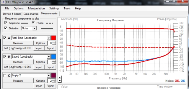

V1.4.2.0
The FILE/SAVE MEASUREMENT don't save correctly the Distorsion data's @ low frequencies.
Example , the red is a loop-back real-time measurement and the blue is the same measurement but first saved and then loaded.

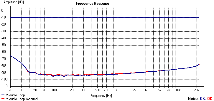

OK, I tried it by opening (append) a file with one sweep in it. I get exactly the same FR, impulse and distortion as the original. They overlay perfectly.
Please try exactly this procedure:
open the app
launch the test
save the test
don't touch anything and don't clear anything
now append the saved test and compare it with the real-time in A and the loaded test in B.

Here is a loopback measurement of my M-Audio card.
Procedure just as you specified. THD as noise
Yes, there is a tiny bit of difference in some spots, like 0.3dB, but nothing major.
When I set the ASIO driver to 24 bit depth and HOLM to save in 24 bit, the results are even closer.
Maybe it's something in your settings? Maybe the .net framework?
