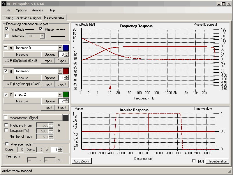

Now for the strange stuff (besides I managed to crash it)
ARTA FR (click to see full size):
HOLMI FR+Pulse :
EDIT (ingore 0.4dB normalization "shift" -- pls default to 0dB)
Same conditions, of course.
That's for sure NOT the looback LF response (the impulse looks ok ---> wrong graphic interpolation for the sparse data points at LF, it seems -- don't use any, please)
Low frequency artifact

1. I don't use interpolation
(Expect linear drawing from point to point)
2. I cannot reproduce these low-freq artifacts
What is the phase response ?
- The phase response reveals clock-mismatch
What are the settings?
(Screenshot of the "Settings for device and signal" tab)
- Samplerate =
- LogSweep start frequency =
- Signal Length =
- Measurement Save Length =
- Keep in/out stream alive = yes/no
- Microphone calibration = yes/no
- DAC-ADC calibration = yes/no
- If you save the measurement (file.hlm) and sent it to my email address (With a private message I'll investigate)

The phase matches the mag in perfect minimum phase fashion, from what I can see. And the shape of that ripple (which is linear spaced, with a linear f-axis) is what puzzles me and Earl (looks akin to a VERY high order chebysheff response or something). This is definitely not the true LF response (I "know" this soundcard very well, and checked for correct responses many times with various means).
This was the "natural" system response. With calibration it is all flat (some minor ripple left)... which is a no-brainer since we then refererence the loopback onto itself. The problem is the basic response to start with and it seems to be independent of the card (@other users: pls confirm this).
BTW, do you actually calculate the "measurement signal" response with the same process or do you just draw flat lines on the screen, assuming it is flat per se? I think this might be the core of the problem, I mean if you did an internal "loopback calibration" of the calculation process then the symptom would be accounted for, and the DAC-->ADC loopback would then only show the effective loopback error of the hardware and not the systematic behaviour. Still better would be to address the root cause, not the symptom, of course.
The signal is running loopback (1m cable) into the same specimen of the converter chip (AK4524), so I see no chances for clock mismatches as there is only one clock line in action. There might be some low-freq jitter, though. And constant latency etc. If I had used unsynced multiple soundcards this would be a problem.

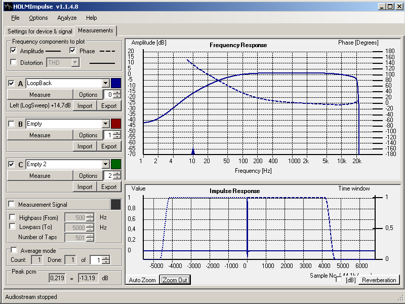

My laptop soundcard
Attached shows the response of my laptop soundcard using the same settings as you.
Everything looks fine here. Audigy 2ZS Notebook card.
I loop one channel output back to both input channels.
Once I accidentally selected "mic input" in the Windows volume control. This did result in the funny low frequency response.

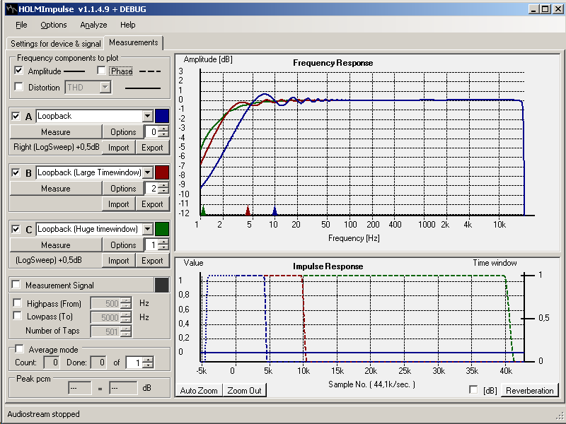

KSTR said:
Looks like we are getting down to where the dog is buried, as we Germans say 😀
No that's not were the dog was buried, because there has never been a dead dog - and who wants to bury a dog alive 😉
Actually it is a feature rather than a bug.
It is the timewindow, which was not large enough.
It seems that your soundcard (DAC-ADC) has very long lowfrequent post ringings. (See attachment)
NB: Notice the little triangle in at the frequency axsis corresponding to the wavelength of the timewindow
(It moves when you move the timewindow)
So what now?
When I measure the DAC-ADC I will enable a larger timewindow to adapt your soundcards with these low-freq postringings.
Until the new Release then modify the time window from the measurement > options > window

OK Ask, correct windowing fixed it (bounds: -44100 and 44100 or greater), thanks! Now I get results consistent with all other softwares I have, which are quite a few (plus the sanity check of measuring the ADC-->DAC response -- not DAC-->ADC -- from the "outside" with a hardware test rig)
--> Please autoscale the window length to the period of the start frequency by default ("Auto-Detect" doesn't seem to do anything in my system).
But I'm unclear on how to interpret a measurement when I start at 1Khz (as shown), I mean how do you get the data that you display below that point when there is no data (assuming the correct spectrum of the sweep: no content below 1kHz)? Regarding not only the "false" distortion data but also the basic response?
EDIT😡all: Ignore data that is below the higher value of either the start freq or the freq indicated by time window marker.
OK, no-one would use display boundaries that are beyond the assumed bandwidth of measurements, but, again, autoscaling or limiting of that would be nice, to prevent users from falling into these traps.
And my card doesn't ring at LF, believe me. It has other issues, though 😉
