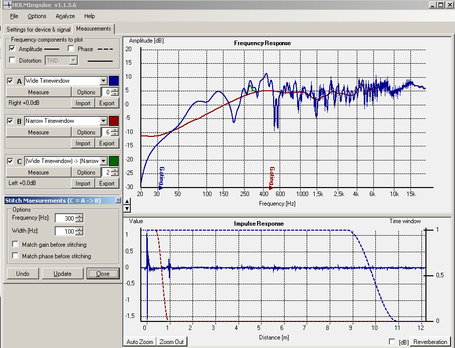

Yes from version 1.1.5.6 there is - A checkbox (Auto apply timewindow)David_Web said:Any way to disable auto detection?
Look at attachment. Procedure:Hmm. Any way to use a rollof for gating? Remove the HF part of the reflection and then leave the LF part to not mess up the shape of the response.
- Make measurement and put this into A
- Adjust wide time window for A
- Choose empty slot in B
- Analyze > Copy A to B
- Adjust narrow time window for B
- Choose empty slot in C
- Analyze > Stitching (C = A->B) (Disable gain, phase match)
[/list=1]
Now you will have a new impulse response in C with low frequency and high frequency without reflections.
I'm working on a frequency dependent time-window concept, but
this will take a while...
