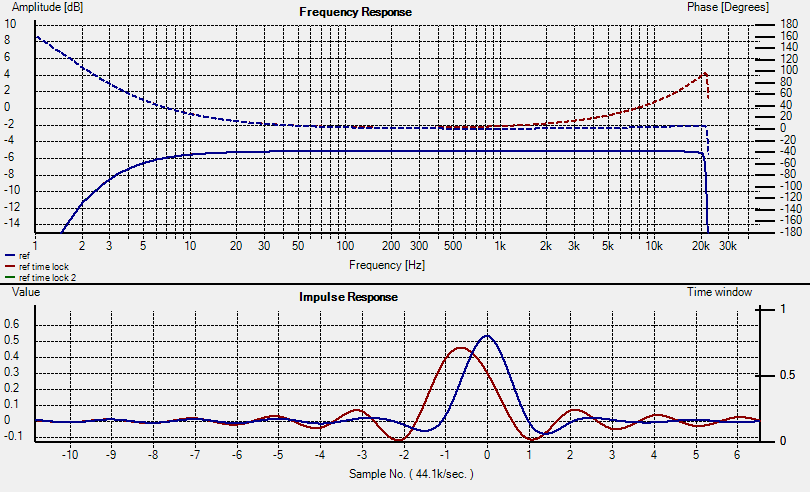

Was simply curious about what would happen if the peak is locked to time zero. Since the peak of the impulse is mostly the highest frequencies of the measurement, what does that do to the relative phase of the drivers. It's relative, but relative to what? Seems it doesn't matter. It works.

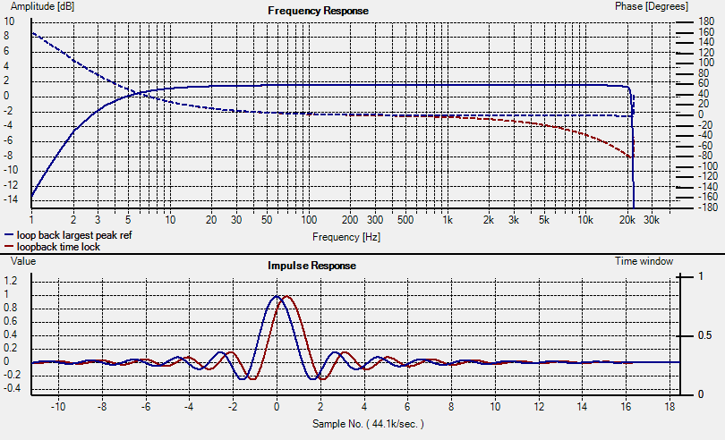

This afternoon I set up measurement and locked the time to the soundcard loop-back. That took the latency out of the measurement. Then ran a sweep. The impulse offset was 7.5 meters. Guess how far the mic was from the speaker.
That 7.5 meters is highly unlikely choice for your microphone, I ran measurements with microphone 2cm from dust cap of 12" woofer in sealed enclosure using both HOLM and REW.
With REW, two channel loopback of soundcard was used for reference. Results look quite believable.
With HOLM a reference loopback was made with settings for largest peak placed at t=0. Time lock was then set using sample offset found for reference measurement. Then time locked loopback measurement of soundcard was made with peak appearing slightly before t=0. A second measurement gave same result:
![ref and 2 time locked loopback instability.png ref and 2 time locked loopback instability.png](https://www.diyaudio.com/community/data/attachments/461/461222-dd2fcba733866cec05e7c13712e5a7c1.jpg)
The rising phase response at high frequencies is clearly not correct. Clearly instability of computer or software is in play. Nonetheless, I proceeded with 2cm measurement of woofer and got woofer impulse response at about 28 meters!
I closed HOLM and pondered what results would happen rerunning the experiment.
Take two:
![ref and time lock take 2.png ref and time lock take 2.png](https://www.diyaudio.com/community/data/attachments/461/461233-2d880d8458cac9de2587f9edd8083e17.jpg)
Expectation of loopback with time lock having peak at t=0 is still not met.

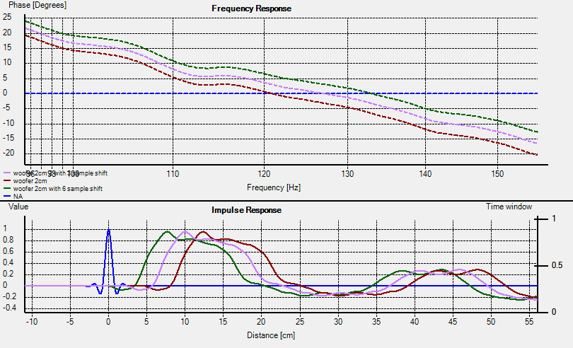

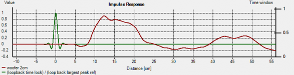

Take two of woofer measured at 2cm:
![woof 2cm IR peak 12cm.png woof 2cm IR peak 12cm.png](https://www.diyaudio.com/community/data/attachments/461/461247-9a5ea18b3f944a68ab16423cfe20f776.jpg)
Peak appears at 12cm, and result appears identical to measurements made with REW.
Measurements were made at 44.1kHz sample rate. With speed of sound taken as 341m/s this works out to about 2.6 samples/2cm of sound travel. Here are copies of 2cm woofer measurement with 3 and 6 sample offsets in comparison with original measurement and zoom of associated phase plots:
![woofer 2cm with 2cm and 4cm offsets.png woofer 2cm with 2cm and 4cm offsets.png](https://www.diyaudio.com/community/data/attachments/461/461257-4eedf6b1acae4c1f04a23ebb58424c71.jpg)
The six sample offset is an approximation for the distance from microphone to the junction of voice coil former and driver cone. Results show range of frequencies that may include actual woofer phase.

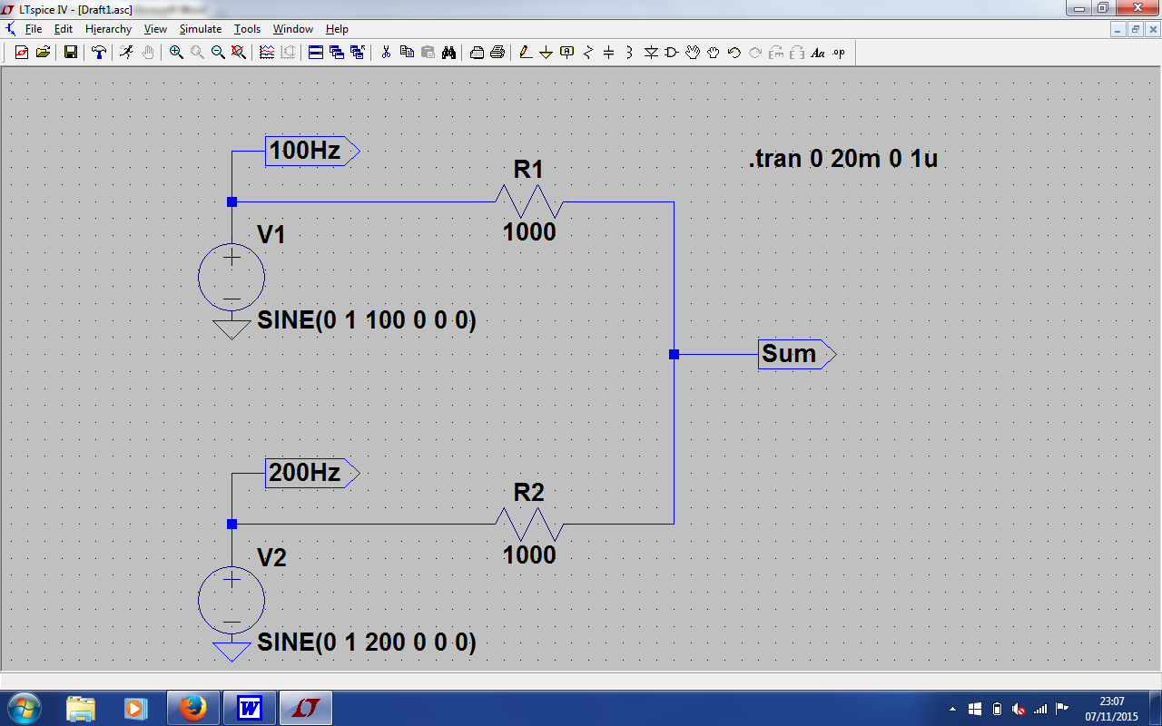

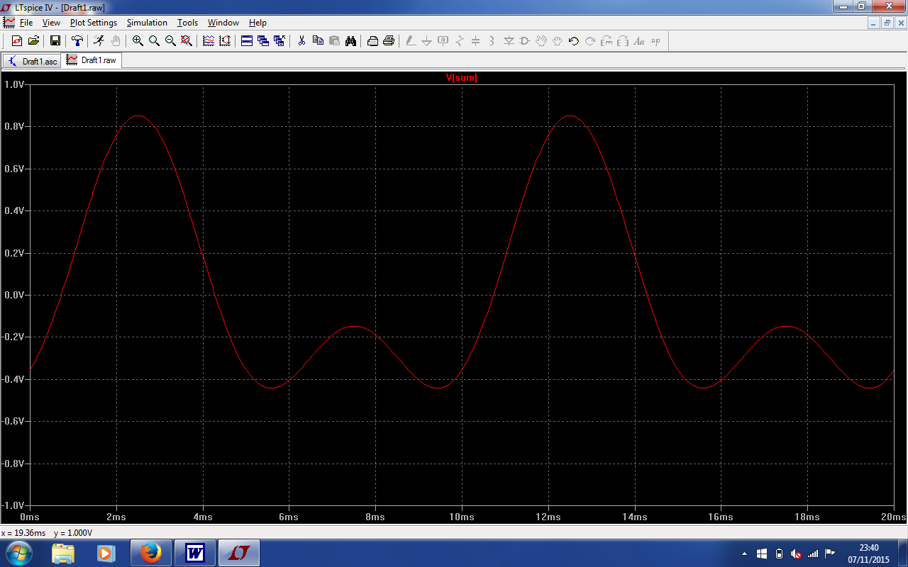

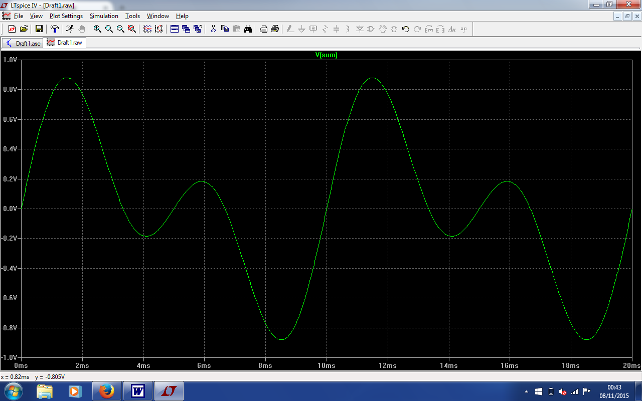

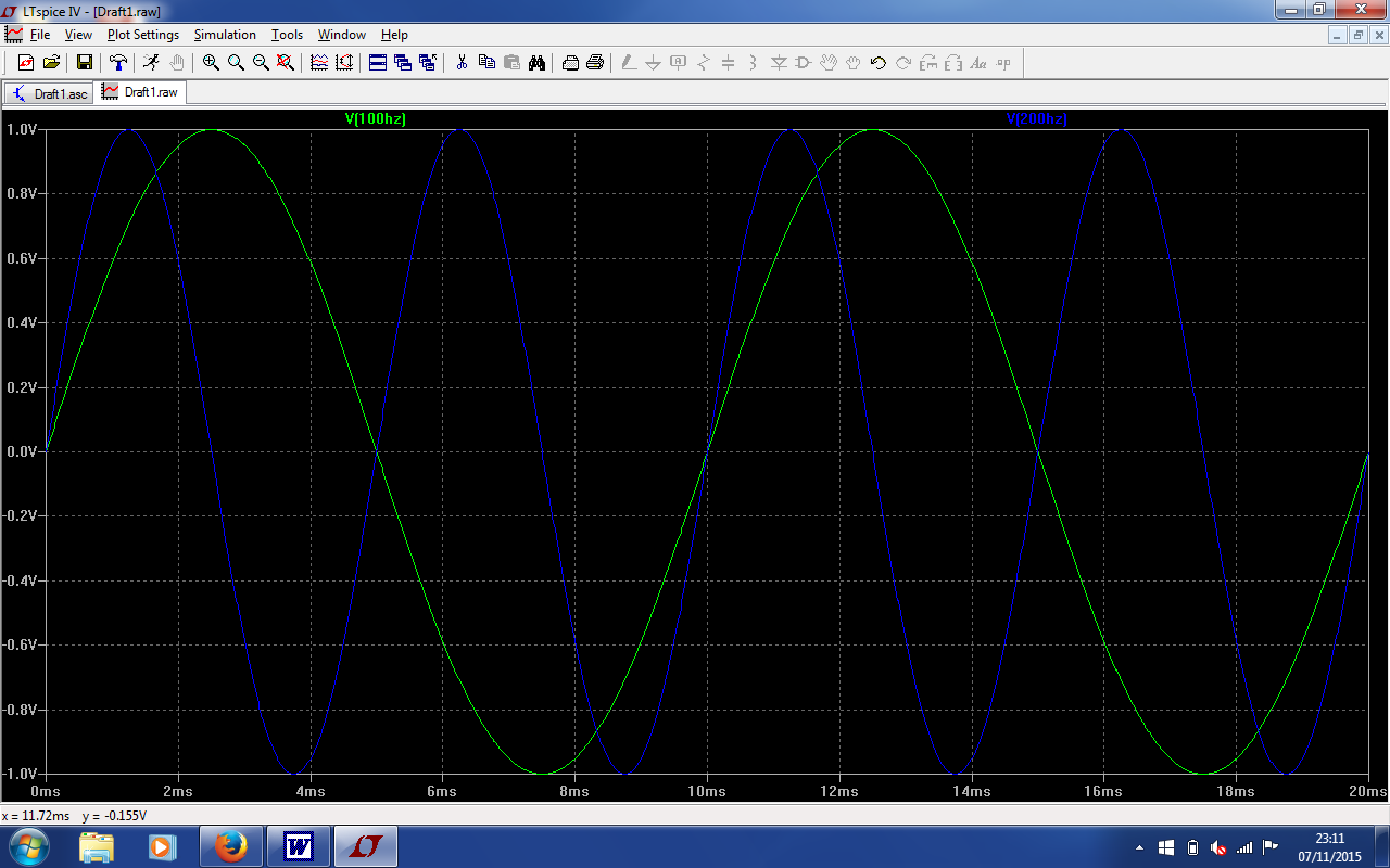

Hi Sumaudioguy,
Thanks for your response. So, hypothetically speaking, if I connect the outputs of two phase locked oscillators, one at 100Hz and the other at 200Hz together, via two 1K resistors, with the junction of these two resistors applied to the input of the power amplifier that powers the loudspeaker under test, I would be all set to run the test you describe – yes?
I entered this circuit structure into a Spice simulator as shown in Fig1 attached, but without the power amplifier. When I run the simulator, it shows the two generator waveforms as in Fig2. If I now plot the sum of these two generators that appear at the junction of the two resistors, I get Fig3, which is the signal that is effectively applied to the loudspeaker via the power amplifier.
This is also the same shape of signal that appears at the output of the microphone, assuming the speaker+microphone combination do not have any significant magnitude and phase distortion. But the zero crossings on this waveform, do not seem to indicate that the 200Hz generator is in phase with the 100Hz generator.
If I were to reduce the voltage of the 200Hz generator by 3dB and change the phase to –90 degrees, the summed output would be as shown in Fig4, which appears to show even less info about the phase relationship between the two generators.
Please let me know what I am missing.
Peter
Peter

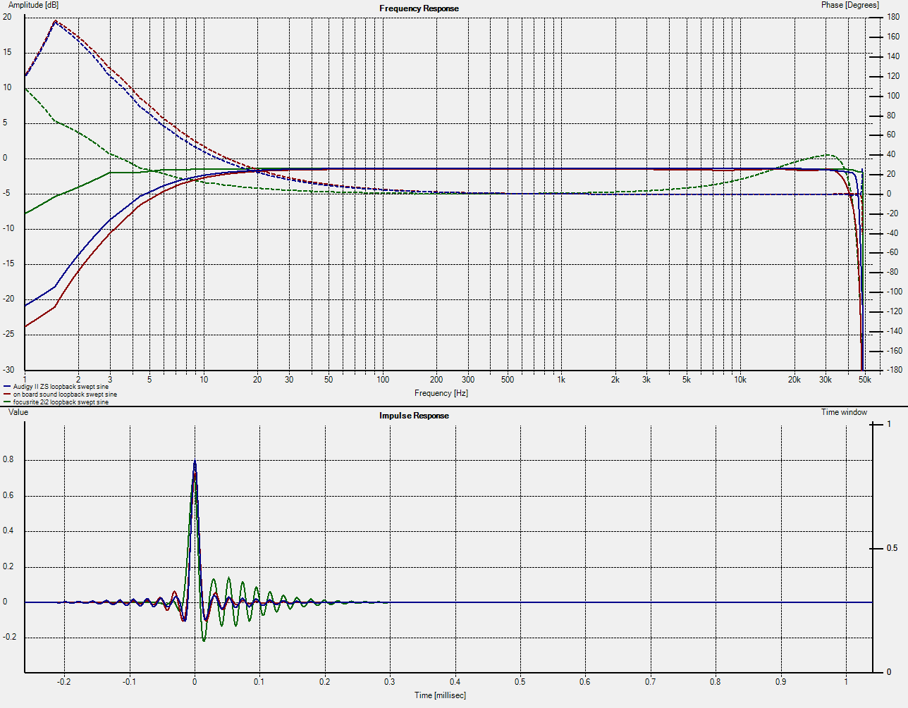

You need a better soundcard or driver, Tony!None I have used have anything but flat phase thru the audio band.
Funny you should say that, as I decided to do some tests to demonstrate what I was talking about.. previously my focusrite 2i2 gave the closest to flat phase of any of the three sound cards I can use. The audigy II ZS was the worst and the on board sound was not much better. I've just done loopbacks of all three, and now the audigy and on board sound are almost perfect, and the focusrite 2i2 is as it always has been....
I suspect that the direct sound drivers have improved, and that the asio driver for the 2i2 is not so crash hot. I unfortunately don't have asio drivers for the other two, and the 2i2 only works with asio.
One interesting thing, both the audigy and the on board require me to invert the measured signal, the focusrite doesn't.
Tony.
OK I checked and didn't have the latest version of the 2i2 driver. I installed it and it didn't make any difference to the phase response... However what it did make a difference on is that I was able to successfully calibrate the card without it crashing on me! Below is the calibrated measurement using the focusrite 2i2. Note that all the previous measurements were uncalibrated.
Just have to hope that it keeps on working with the calibration file!
Tony.

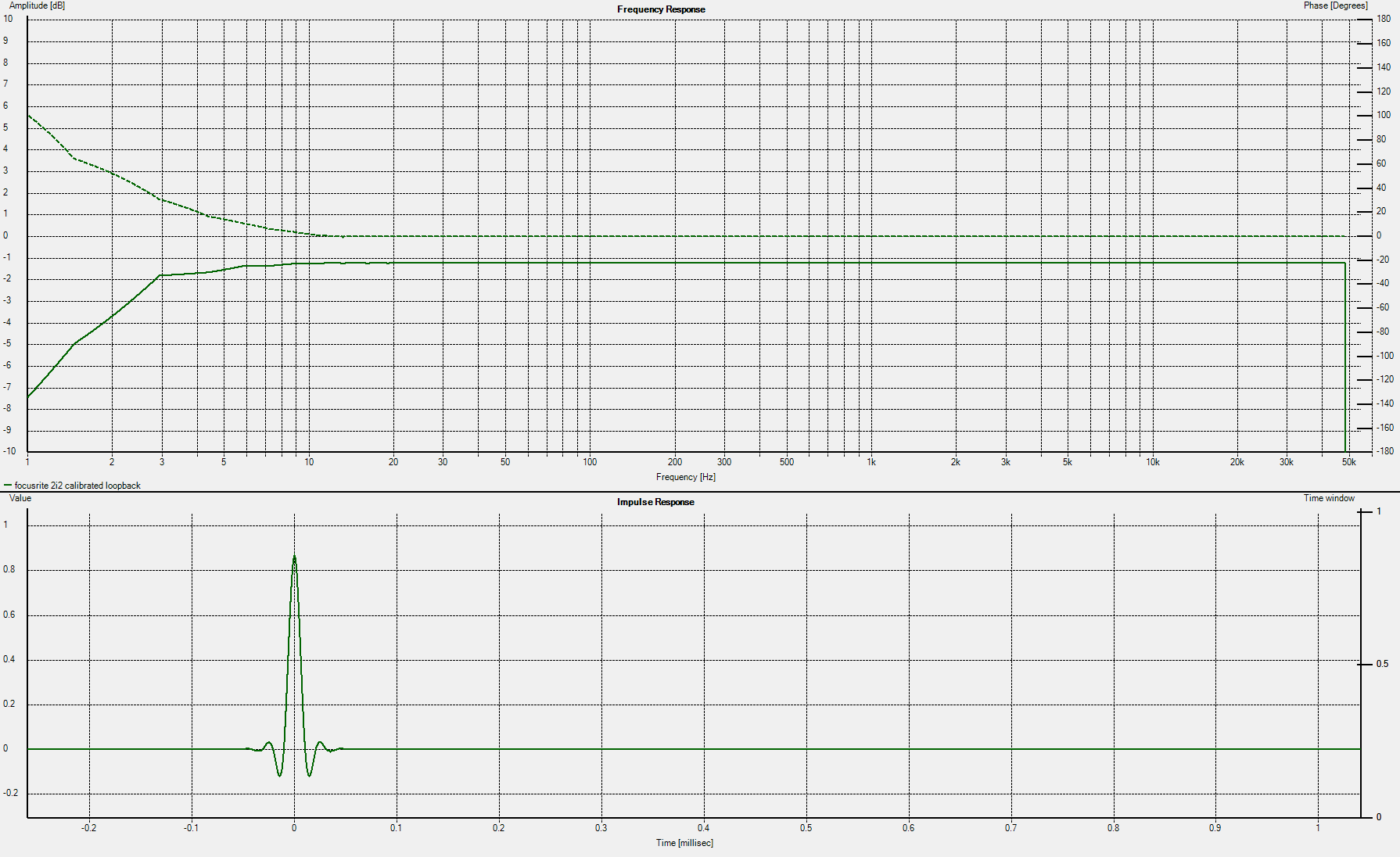

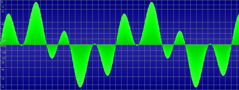

Checking HOLM phase results against sine waves at 100Hz and 200Hz:
A full bandwidth sweep is used to measure loopback response of soundcard that has typical high pass filtering due to capacitive coupling of output and input stages.
HOLM export impulse response is used to save waveform starting from 10000 samples before t=0, and ending 65536 samples beyond.
HOLM software in Manipulation tab provides division function labeled as C=A/B. This divides the spectrum of A with the spectrum of B, and transforms result into an impulse response in time domain. When A=B the result is single sample of high magnitude at t=0 surrounded by samples of zero magnitude; this is Dirac function with flat spectrum with zero degrees phase throughout. This is also exported with 10000 sample before t=0, and ending 65536 samples beyond.
The phase plot for loopback measurement is zoomed in on at 100Hz to read off phase with result appearing to be about 5.885 degrees. Zooming in on plot at 200Hz shows phase at about 3.185 degrees.
The two saved impulse responses are opened in Cool Edit.
Stereo tracks of several seconds duration are created. One is made with 100Hz tone, and a second track is made with 200Hz tone. The left channel of each track is convolved with the loopback impulse response and the right channel of each track is convolved with the Dirac function impulse response. The result in each case is a stereo track where the zero crossings of left and right channel do not line up. For each stereo track time is zoomed in until little more than a single wavelength is viewed. Next the amplitude is zoomed in on until zero crossings appear as single pixel wide vertical lines. Measurements of distance between zero crossings for left channel and right channel are made, and distances for zero crossings of single wavelength are made. Pasting screen shots from Cool Edit display into Photoshop where distances may be readily displayed in pixels conveniently does this. The ratio of pixel offset of zero crossings between channels with number of pixels per wavelength multiplied by 360 degrees per wavelength gives the angular displacements.
Results:
100Hz is 5.86 degrees, 0.43% difference from HOLM display.
200Hz is 3.21 degrees, 0.78% difference from HOLM phase display.
