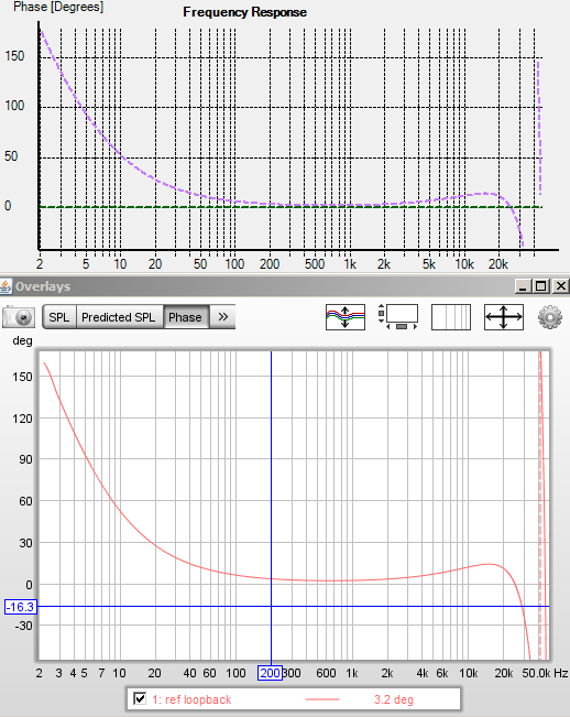

Continuing on from post #978:
Importing the impulse response measured with HOLM in REW with peak sample value located at t=0 produces nearly identical phase plot:

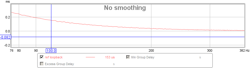

REW is able to display group delay:
Group delay for 100Hz is reported as 153 microseconds.

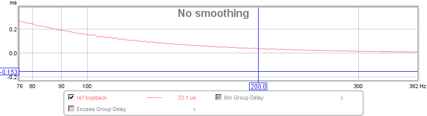

Group delay for 200Hz is reported as 33.1 microseconds.
The difference is 119.9 microseconds. At 96kHz sample rate this equates to 11.51 samples. This means that if a mixed signal of 100Hz and 200Hz with the components sharing same zero crossings is passed through signal chain used in HOLM in prior post then the zero crossings of 100Hz and 200Hz components will be separated by 11.51 samples. The signal synthesis and decomposition is readily accomplished with Cool Edit. The test signal is saved, then played and recorded with loopback setup using soundcard. In Cool Edit, the recorded waveform is made into stereo tracks with identical waveform in each channel. One channel is tightly band pass filtered to recover 100Hz component, and the other channel tightly band pass filtered to recover 200Hz component. The filtering is accomplished with FFT filter with linear phase that does not change zero crossings relationship of 100Hz and 200Hz components when applied to original test signal. Inspection of the decomposed loopback recording shows zero crossings of 100Hz and 200Hz components is 11.46 samples. The difference from predicted offset of 11.51 samples is 0.44%.
![FCA610 phase HOLM v REW.png FCA610 phase HOLM v REW.png](https://www.diyaudio.com/community/data/attachments/465/465652-14e9d02034080c94e6f61cf8929e92e9.jpg)
![FCA610 GD 100Hz 153us0 .png FCA610 GD 100Hz 153us0 .png](https://www.diyaudio.com/community/data/attachments/465/465666-3d2da431709e10f5efe82d4f2807cda2.jpg)
![FCA610 GD 200Hz 33us1.png FCA610 GD 200Hz 33us1.png](https://www.diyaudio.com/community/data/attachments/465/465685-882e1375860b97b9252242270e834400.jpg)
Since all phase is relative - to what is arbitrarily called t=0 - then as long as any piece of software is consistent, then it is as good as it can get.
t=0 is based on impulse response of test signal. Convolution of test signal with its corresponding inverse returns a single sample with a normalized value extremely close to 1, with all other sample values extremely close to zero. This is readily observable in HOLM using digital loopback with software set to detect time zero and using zoom features in the display panels.
With such loopback measurement use of Offset[samples] in the measurement's options panel may be used to shift measurement relative to time zero by fractional sample values, which leads to greatest shifts in phase display at high frequencies.
With analog loopback of soundcard, low pass filtering in conversion stages in conjunction most often with digital anti aliasing leads to some vagueness in what the high frequency phase plot should be. Once again, tiny fractional sample offset adjustments lead to shifts of phase plot at high frequency. An approach to this is modeling the low pass behavior of the soundcard's loopback response and adjusting the measurement offset to closely match phase response to the modeled phase response.

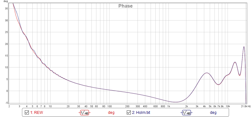

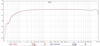

From that data It wasn't clear to me how closely the REW and Holm Phase aligned to each other across the range though so I did a somewhat similar test to find out. This possibly just supports his finding. Since I did the work, I decided to share it.
> Focusrite 2i2 soundcard at 44.1kHz with no cal files applied in either Holm or REW. [At this sample rate the 2i2 SPL is not as flat as it is using the native 96kHz sample rate.]
> 3 loopback measurements were made with both REW and Holm to confirm the SPL and Phase are repeatable.
[Both REW and Holm measurements overlaid like a single trace even at the very high magnification used in the charts below so both programs are very repeatable (not Shown, but available).
> One of the Holm measurements was then exported as text (500 points). The file's magnitude was adjusted +120dB so it could then be imported into REW to compare to one of the REW measurements.
> The Holm SPL magnitude was then adjusted about -5dB in REW to best overlay the with the REW SPL trace (see chart Below).
> The IR offset of the REW measurement was adjusted about -0.00051ms to best align the phase of the Holm measurement at 20kHz (see chart Below).
![SPL.png SPL.png](https://www.diyaudio.com/community/data/attachments/467/467879-0a1a2841ebe5dcb8ea1e5c8aa5e0f51c.jpg)
![Phase.png Phase.png](https://www.diyaudio.com/community/data/attachments/467/467897-19b5153281befadb876446e19e8fcfab.jpg)
Conclusions:
> REW and Holm measurements are both highly repeatable.
> REW and Holm measurements agree very closely for both SPL and Phase.
In addition - both are perfectly correct.
