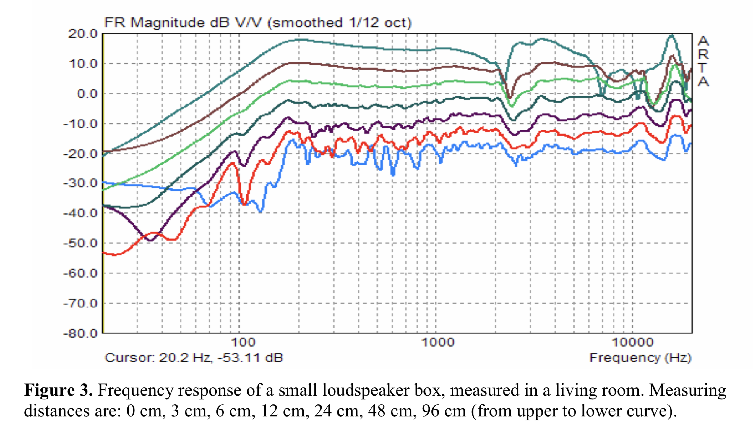

I read an article by ARTA (http://www.artalabs.hr/AppNotes/AP4_FreeField-Rev03eng.pdf) where you can see measurements done at 0 cm, 3 cm, 6 cm, 12 cm, 24 cm, 48 cm, and 96 cm.
Although the industry standard is 1 meter, it seems to me that 1/2 meter is a "good enough" middle ground between near field and far field.
Any thoughts on this?

I believe farther is always better. The near field has things going on that don't get top the far field. You don;t want to measure those. But you do need to gate, otherwise you have altogether another problem.

It depends on what you want to see in the measurement. A single driver's spl-response with typical narrow speaker baffle is ok at 50cm. Wider baffle and multpiple drivers summing up needs more distance. Also reliable off-axis measurements should be done at at least 1m, preferably 2m distance.
Reflections start to show in measurements only after a few milliseconds, depending on distace to boundaries and by ratio of direct vs. reflected sound energy. FFT analysis with variable impulse response gating enables the user to see reflections in impulse response and help to decide IR gating for spl/F, short gating doesn't show spl well in low freq. So, it is always a compromise.
Distortion is typically measured very close to a single driver, but the problem is to be able to use high enough voltage/spl, because mic easily gets overdriven. At 1m distance spl should be at least 95dB, preferably 100dB, depending on the level of ambient noise.
For an amateur measuring her/his own project, it is very easy to get blind to artefacts. It is a bit more difficult to learn to "see through" those artefacts!
Comparing measurements done by others is always problematic, because we don't know excact conditions of the measurement
Should've mentioned I was indeed referencing single driver measurements for XO simulation and so forth :)
Doing measurements at 1m I actually usually don't get much different results with and without gating (typically 3ms)

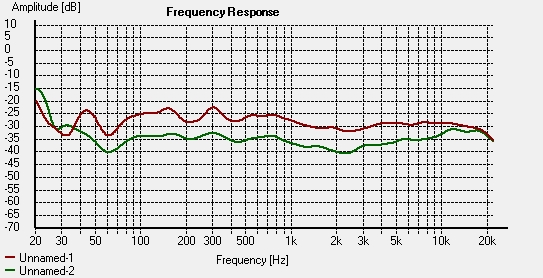

Very strange results after importing a mic-calibration file.
Hello
I need some help or advice. Am I doing something wrong?
E888F_dir_00d.mic is the original calibration file done by professionals.
It's working in ARTA as expected.
When I imported it in HolmImpulse the results were very strange as you can see in the picture (green = FR with cal-file, red =FR without cal-file)
I have replaced all tabs with semicolons (E888F_dir_00d.cal) but nothing changed.
At least I found the cause. In C:\user\...Holmimpulse a new calibration file had been created (CalibrationMic.cal). And HI uses this file for FR-correction.
The values obviously have changed in a way, I can't explain and I do not understand.
Does someone know what is happening here?
Did I something wrong?
