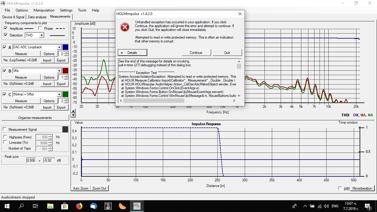

Often while using Holm I get an error message and application closes. If i try to do a loopback calibration, it would pop up all the time and even if I chose "continue", it closes. I use it on a core i5 with 4GB of memory, Gforce 920 and Windows 10. The HOLM is 64 bit version.
Second problem is I am unable to measure distortion now, it just doesn`t show up. Tried anything, no luck. The driver in use is Asio in HOLM, installed is Asio4all, but I also tried MME with no resolution. Harmonics now just show NA.
Tried reinstall, reboot and etc, nothing works. Here is a screenshot of the error message (pic below).

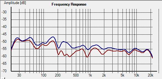

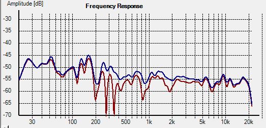

Best smoothing method for measuring at listening position.
Amplitude or complex? Which one is better? They give me dramatically different results. See the pictures (1/3 and 1/6 smoothing). Same measurements, different smoothing methods. I'm trying to eq speakers to target curve.

Complex smoothing is what you want. The term "complex" is poorly chosen since it is not "complex" in the mathematical sense, but in the fact that it is more complicated.
Complex smoothing is not constant across the bandwidth, but gets wider as the frequency goes up. This is much more like the way that we ear. for EQ purposes the "complex" 1/3 octave would be your best choice.
It does appear to me that your gating is too long - too many room reflections.
