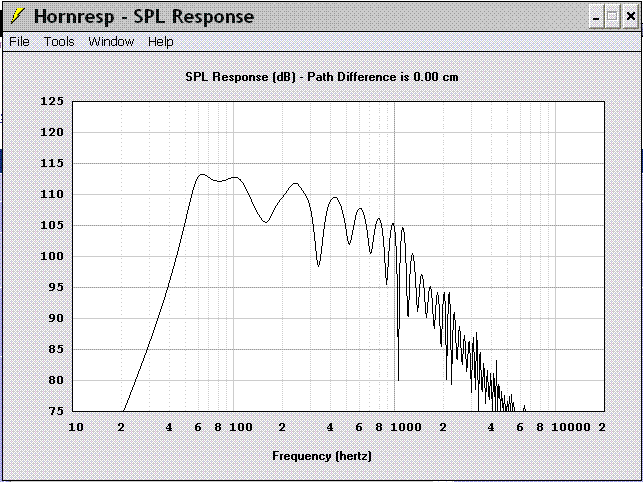

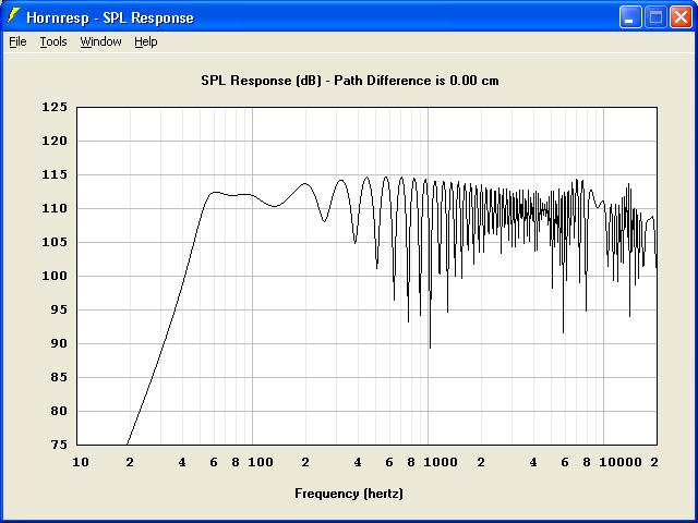

brsanko said:Why does the combined response always drop off after 1khz?
Hi brsanko,
Mainly because the driver diaphragm is modelled as a rigid plane piston, and directivity effects are not taken into account. See Note 2 in the Hornresp Help file for further details.
Note however that it is theoretically possible to produce a more extended response - it all depends on the input parameter values.
Kind regards,
David

brsanko said:In otherwords the parameters don't tell hornresp that there is a whizzer cone?
Hi brsanko,
That is correct.
Kind regards,
David

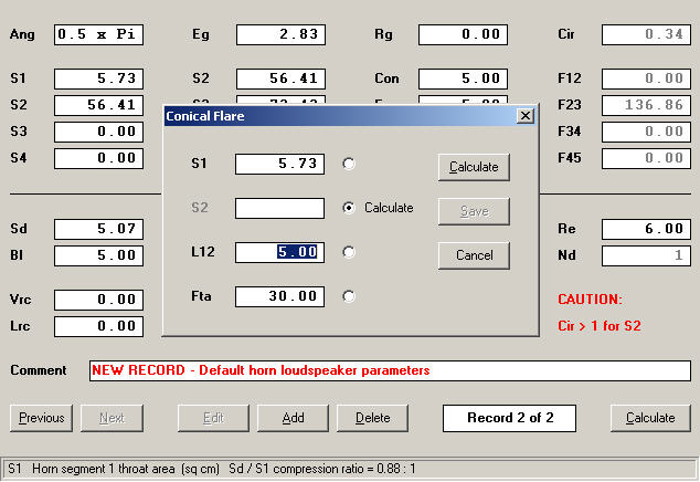

I just downloaded the latest Hornresp, and have some difficulty creating the model. In the help file it tells you to when you have L12 in focus you can type H, L, O, etc to get the type of flare you want. However, when I do this, nothing happens.
Appreciate some help. The attached pic shows where I'm at.
