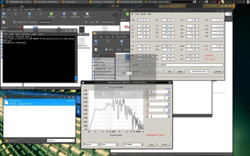

For what it is worth - I have noticed no instabilities with the new 32-bit version, though I had no issues with the previous versions (I am currently using Intel CPUs, and have been since I discovered Hornresp).
For those who are interested (Jbell), the 32-bit version runs under Wine 1.0 on my Linux computer (Ubuntu Studio, Kernel 2.6.24-19 on Intel Core2 architecture), though I had to install the core truetype fonts package in addition to Wine to get it to work. I have not really had a chance to wring it out, but it does work, and results of the simulations appear the same.

littlemike said:For what it is worth - I have noticed no instabilities with the new 32-bit version, though I had no issues with the previous versions (I am currently using Intel CPUs, and have been since I discovered Hornresp).
Thanks littlemike.
