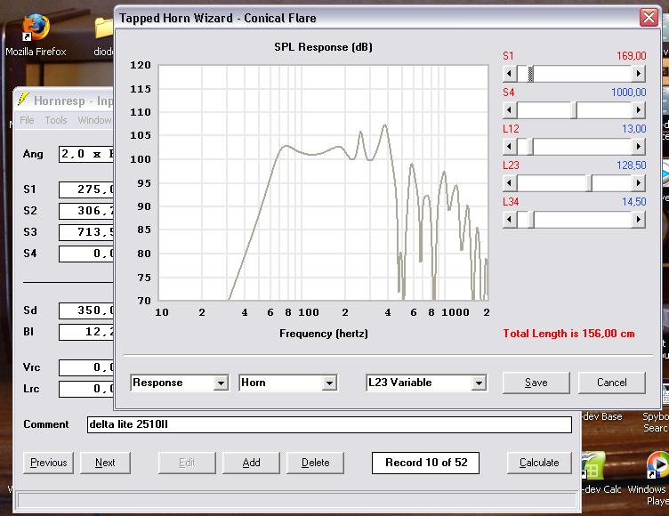

Helmuth said:Only I can not find the tapped horn wizard

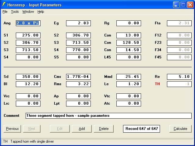

Hi Helmuth,
Try using the input parameter values shown in the attached example, if you are still having difficulties activating the Tapped Horn Wizard menu command.

David McBean said:
Hi Helmuth,
Kind regards,
David
Thanks David,
It works and it is really great.
How can you make such a nice program are you programmer with a audio hobby?
It would be nice if also the total volume is shown when that would be possible. Because when simulating this is one of my biggest problems.
Regards Helmuth.Lageschaar

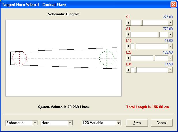

Helmuth said:Are you programmer with a audio hobby?
Hi Helmuth,
I am a retired electrical engineer and self-taught amateur programmer, with a long-standing interest in horn loaded loudspeakers.
As Johan has mentioned, the system volume is shown on both the Tapped Horn Wizard schematic diagram (see attached) and the main program schematic.
Kind regards,
David

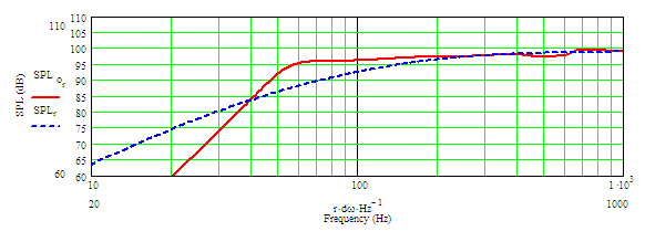

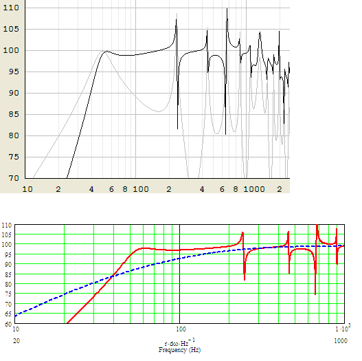

It is the Tractrix-man from audioasaylum speaking !
Did a few sims with a small ML TQWT called Tabaq. The speaker is from the beginning modeled in MJKs worksheets with a small Tangband.
These are repective results. Both undamped. The difference is that Hornresp predicts a lower resonance-point. Please comment as I find this very interesting.
One difference is that in the worksheets you can add damping at whatever part of the line you want, to see how this affects resonaces etc.
revintage said:The difference is that Hornresp predicts a lower resonance-point. Please comment as I find this very interesting.
Hi Lars,
I must be missing something . Both the undamped frequency response charts in your comparison have a low frequency roll-off at about 55 hertz, and the higher frequency resonance spikes are all in effectively the same places. Where is the difference?
Kind regards,
David
revintage said:When I read it -3dB in Hornresp is 45 and MJK is at least 50Hz. This means ca 10% diff.
Hi Lars,
I suspect that it may have something to do with the way that eighth-space loading is modelled by the two programs. Is there much of a difference in the results when the radiation angle is changed to 2 Pi half space?
How do the individual responses from the front and rear sides of the diaphragm compare?
Kind regards,
David
