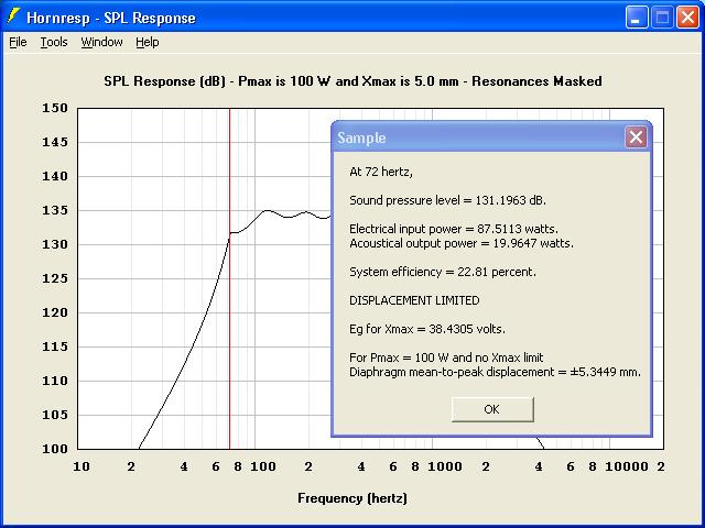

Sabbelbacke - The frequency at which the response changes from displacement-limited to power-limited is usually signalled by a slight discontinuity. For example, with the default record this occurs just above 72 hertz (see attached).

Of course, somtimes the point where xmax is reached often is seen quite good. I had more things like this in mind:
The first dip (from the left) is replacement related, the second one power limited. But his really is a very insignificant, it would be "nice to have" but just doing xmax once again with a higher power rating gives me an instant overview which is a good workaround.

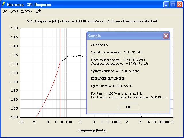

Could the max spl graph be duo-chrome? The electrical limited parts could be, lets say red, the ones where max-excursion is reached... black? This way it would be quicker to see which limit is reached at which frequency.
Hi Sabbelbacke,
I couldn’t resist implementing your suggestion - see attached 🙂.
The only difference is that I have used red rather than black for the displacement-limited portion(s) of the chart. Note that the feature also works with the Tapped Horn Wizard response chart when the ‘Other’ input parameters Pmax and Xmax have non-zero values.
Hornresp Version 20.20 refers. Thanks for the idea!
Kind regards,
David
