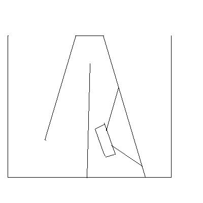

Dumb question, how would you model something like this in hornresp?

I'm seriously confused by something I read in another post, and while having 6 cabinets almost done realize I may have a problem.
Modeling a tapped"
In the hornresp schematic, when the driver's area extends outside the horn throat..... Is that area omitted? does this mean you have a reducing plate the driver fires through? While this doesn't make sense to me since the area of the horn with the driver firing through is not listed anywhere.... don't tell me that's s2!! Something doesn't make sense so I'm missing something.
Am I incorrect to squash s2 physically to fit the driver width while maintaining the area?
How do you actually build what you modeled?
How does hornresp deal with a throat that is smaller than the drivers surface area (flat plane not SD) in normal horns?
Hi screamerusa,
screamersusa said:
Modeling a "tapped"
The Hornresp schematic is a notional diagram only. The total driver diaphragm piston area Sd is always taken into account when simulating a tapped horn - no area is omitted.
screamersusa said:
Does this mean you have a reducing plate the driver fires through? While this doesn't make sense to me since the area of the horn with the driver firing through is not listed anywhere....
As explained in Note 8 on page 16 of the Hornresp Help file, Vtc and Atc can be used to specify a chamber between the diaphragm and the throat entry point. Ap and Lpt can be used to specify a port opening between the chamber and the horn (not required if the cross-sectional area of the opening is equal to Atc).
Select the 'Schematic' and 'Chamber' options in the Tapped Horn Wizard and try altering the values for Vtc, Atc, Ap and Lpt, to see how it all works.
That sounds like a reasonable approach to take.
I will have to leave that for you to decide :).
It is not a problem - the simulation models are designed to handle this. Although not essential, a throat chamber would be normally be specified in such cases.
Kind regards,
David

tb46 has an interesting point. usually I manually "lock s2" by working outside the tapped horn wizard. I label any sims messed with this way "DNTW" Do Not Tapped Wizard so I don't screw up.

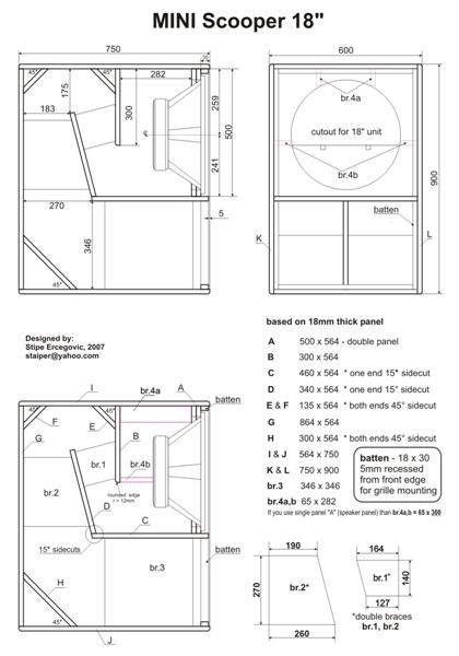

Trying to learn Hornresp.
I saw one new HR( hornresp) info at speaker plans with the design.
It is as under :
S1 = 750
L1 = 100 CON
S2 = 1951
L2 = 50 CON
S3 = 1951
Vtc = 85000 (85ltr.)
Atc = 1400
"Atc" is average cross section area of throat chamber and roughly said defines shape of throat chamber ..(for example when "Atc" is set small it makes throat chamber appears long-tube like .. in HR simulation that have effect on throat-end-correction factor and make horn apear a bit longer.
Atc is quoted as 1400. If i take the average of 750 & 1951, then it is 1350. Just correct me , how Atc 1400 is arrived.
Also attached the full plan.
Thanks in advance.
Possibly in one of two ways:
- practical (size) considerations, or
- by "cut-and-try" and observing the resulting response (note that throat chamber and rear chamber resonances must not be masked when doing this).
I usually set Atc = Sd, more or less, this is in many cases what will be used in practice. As far as I know, there is no exact formula for determining the optimum Atc. It's not a big issue for bass horns anyway, as long as it is not too small (Atc > S1).
