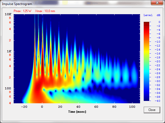

Hi David,
that's nice not to have to wait for the calculation every time.
Here is the spectrogram of same box which I posted before.![flame :flame: :flame:](https://files.diyaudio.com/forums/images/smilies/flame.gif)
http://www.diyaudio.com/forums/subwoofers/119854-hornresp-123.html#post2217369
Thanks vadi.
As you can see, there is more detail in the spectrogram generated using Jean-Michel's latest code.
Kind regards,
David

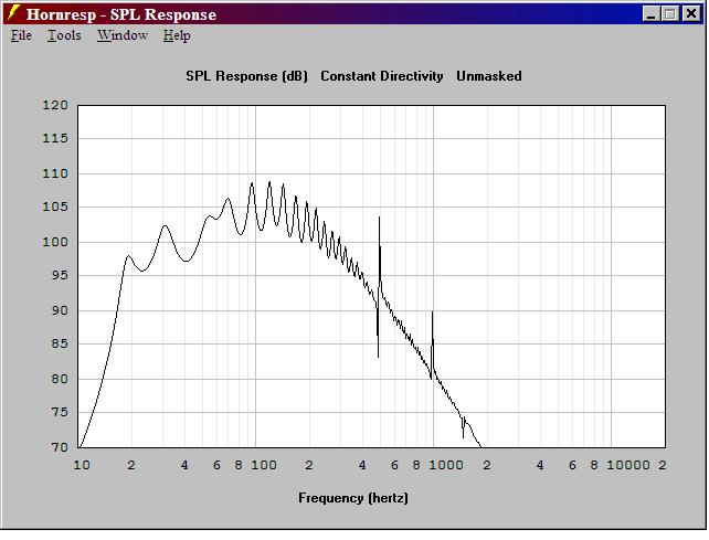

Impulse Response - Post #1249
Hi David,
Thanks to you and Jean-Michel for the quick fix (Post #1249), and the color change. There seems to still be something minor amiss with the impulse response tool, even though it is very much improved. Please, see attached impulse response comparison, same simulation as before, Lpt changed from 1.78 to 1.79cm.
Hi David,
Hi Oliver,
Many thanks for this.
In my testing I had only compared Lpt = 1.78 against Lpt = 1.82, and because the results were almost the same I had assumed that the problem was fixed. I think this is probably one for Jean-Michel to look at. He is currently unavailable, but I will try to contact him early next week.
Kind regards,
David
