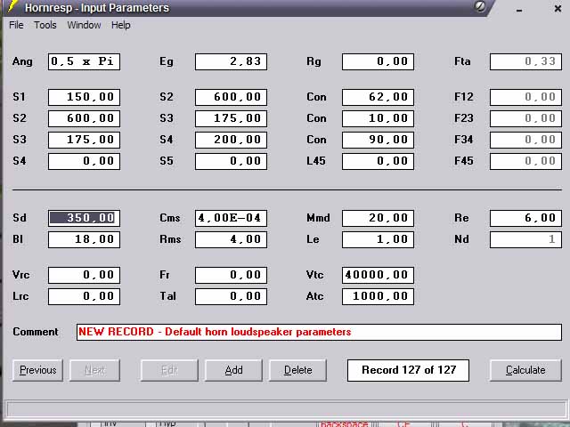

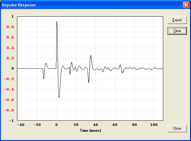

There seems to still be something minor amiss with the impulse response tool, even though it is very much improved. Please, see attached impulse response comparison, same simulation as before, Lpt changed from 1.78 to 1.79cm.
Hi Oliver,
I have found a way of preventing the anomaly in the impulse response for your Lpt = 1.79 cm test example, but I would like to check with Jean-Michel to see if he is happy with the method I am using before releasing any update to Hornresp. Hopefully this can be done early next week.
The attached screenprint compares the impulse response results for your tapped horn example with Lpt = 1.79 cm (black trace) and Lpt = 1.78 cm (red trace). You can see that the difference is now minimal, as it should be.

Hello Oliver,
There is 2 points in your question:
High frequency resonances due to the throat chamber depth induce rapid variations of the phase and therefore to large amplitude peaks and dips of the group delay curve (at HF)
Now, when one wants to perform minute changes in the front chamber the resonance frequencies are more or less far from the discrete frequencies used by Hornresp. This explains why the height of peaks or dips on the group delay curve becomes larger sometimes.
Then, as the Impulse Response module of Hornresp uses the mean group delay at high frequency as an internal parameter, in some cases the mean HF group delay may be noticeably larger or smaller than when the depth is a bit larger or smaller (because the resonance frequencies don't coincide anymore with the discrete frequencies used in Hornresp) .
One solution I found and which is currently under test is to use the median value of the group delay between 10kHz and 20kHz in place of the mean value.
The negative time impulses are due to the fact that we choose to use as a time reference for the spectrogram -as it is usual- the time at which the energy of the spectrogram is the largest inside a very large of frequency.
This peak of high energy (having also a large HF content) is normally related to the wave emitted by the front of the loudspeaker (that's why the upward front of the corresponding pulse ).
Now in TH, depending on the paths of the front wave and the rear wave, a wave emitted by the rear of the loudspeaker (and having a "downward" front pulse) may arrive before the "front wave" and therefore that lower energy pulse will be seen as having a negative time relatively to the main pulse taken as a reference. This is probably counterintuitive but it is also very convenient for the operation of the automatic scaling module I wrote for Hornresp.
To conclude, this is not related to the shape of the Fourier window (raised cosine having a frequency dependant width) . (Please note that the Impulse Reponse calculation in Hornresp is not based on an inverse FFT but is a proprietary algorithm of mine adapted to a discrete frequencies problem...)
