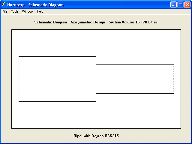

I'm playing around with Ripol right now and would like to ask for some advice / help in simulating it (if thats the right thread for such).
To get started I checked out your H-Baffle simulation setup at the audiocircel posting and got this results:
Already pretty good. What can I do to improve for Ripol ?
What I built is a "as compact as it gets" (38x38x42cm) design - a dual 15" box with two Selenium 15PW5 and a "mouth" area of roughly 10x35cm each.
Could you possibly help on my project in setting up a "correct" simu for Ripol speakers?

It was Rudolf's work to simulate H-dipol and Ripol in the AJ-Horn programme that got me interested in what Hornresp could do. In fact with the use of the Compound Horn model it is very easy to set up these models. And I think that the results are valid. H-dipol simus I have compared to MJK's models and the difference is very small.
Here is a Ripole example, which is the same as Rudolf use in his paper in the Download section on his Web: Offene Schallwand (OB) . I think that the pictures tell the story, combined response is calculated with 37 cm difference as in Rudolf's example.
The Hornresp results are a bit different from Rudolf's and I am no Ripol-expert, so it would be nice if he could comment on them.
/Erling

As I see it for now, the Ripol compared to a H-dipole has the additional complexity of closing the radiating area - very much like a front chamber for horns - just the horn omitted.
It should be possible to do that in Hornresp as well.
The other added complexity IMO is that the membrane is not at the "back" of the front chamber but "to the side" (more like the pleats of an AMT configuration) - not knowing if Hornresp simu would be any affected ?
Michael
I have simulated the Ripol also with front and back chambers a bit like I did the original H-dipole model. The results have been identical. The Compound Horn model has the intuitive easy understanding coupled to it so I would go for that.
Hornresp is very versatile, in fact you could simulate the now popular baffle-less speakers also.
Perhaps David could comment about the 'mismatch' of membrane surface and hornsegment surface, if that would have any effect on simulations ?
/Erling

Yes - that would be good to know - to my understanding the "hornless front chamber" of a ripole includes some volume that might make it behave a little bit like a band-pass or like a transmission line - but with kind of "distributed drivers" along the line.
Or possibly seen otherwise - like a tapped horn with no horn afterwards.
I just do not know how Hornresp deals with such things ?

Perhaps David could comment about the 'mismatch' of membrane surface and hornsegment surface, if that would have any effect on simulations?
Hi Erling and Michael,
For the example you have given, I would think that the Hornresp predictions should be reasonable. Obviously though, as the difference in areas becomes very large, the accuracy of results will decrease. The program assumes that the driver is loaded by the throat acoustical impedances of the cylindrical horns mounted on each side of the diaphragm.
