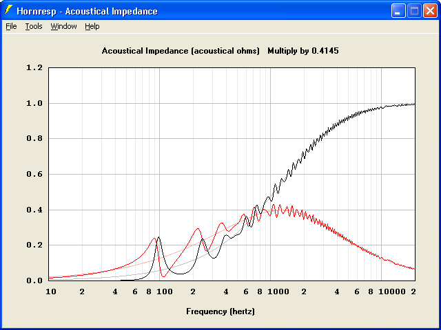

Thanks Andrew and Mark.
Bjørn derived the finite parabolic horn throat acoustical impedance expressions from first principles - a very impressive achievement (it was not a trivial exercise by any means). The results have been extensively tested, and we are confident that they are completely valid. As a simple example, the attached screenprint compares the throat acoustical impedance of a finite parabolic horn with Ang = 2.0 x Pi, S1 = 100 cm2, S2 = 5000 cm2 and L12 (Par) = 100 cm against the results for the equivalent infinite parabolic horn.
Kind regards,
David
