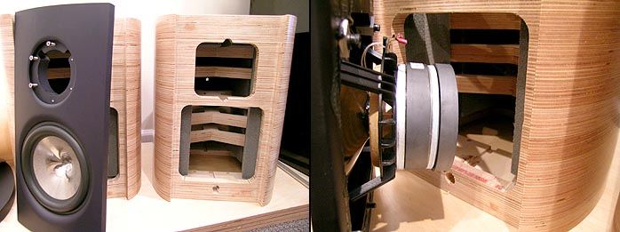

Hi and sorry but i am too interested ...
i was thinking about the damping effect resulting from assembling a cabinet with two different materials, one stiff and one damping
Then the solution of a metal front baffle connected to a normal mdf cabinet should work perfectly.
Am i wrong ?
Even a thick aluminum front baffle with holes for the drivers should not cost that much
And its natural tendency to ring would be stopped by the rest of the cabinet made from normal mdf or better a wood with good damping properties ... even a cheap one properly sized.
Cost for me is an object after all.
This is the solution used for the Magico Mini of which i re-attach a picture
And at least for the Mini the concept seems to work very very nicely.
Am i wrong ?
