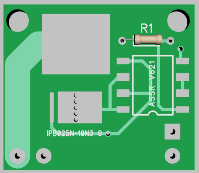

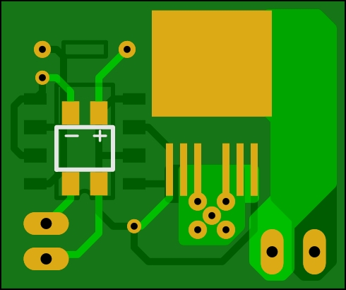

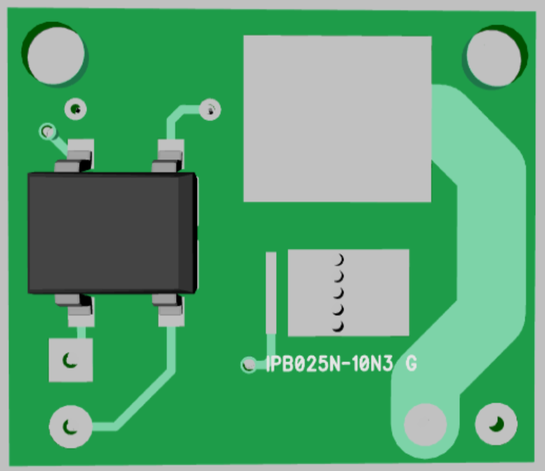

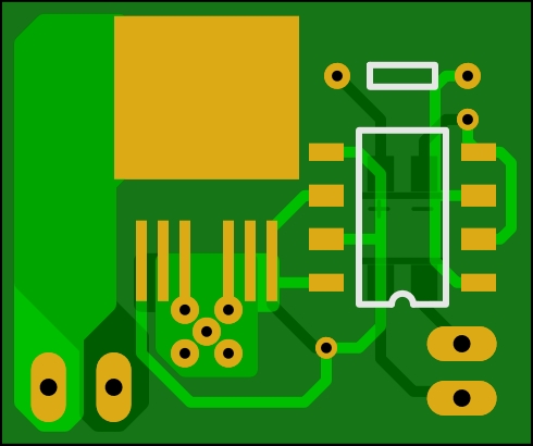

I've layed out a relay module to try based on Esperado's design. I omitted the Zeners across the output though. It's designed to stand upright in place of the Omron speaker relays.
Jeff, can you please drop the schematic for this board here.
Now I just need to figure out how much copper is required to heat sink these things. The data sheet recommends 6 square cm but these shouldn't be anywhere near full output and hopefully aren't dropping any voltage so they shouldn't create much heat.
