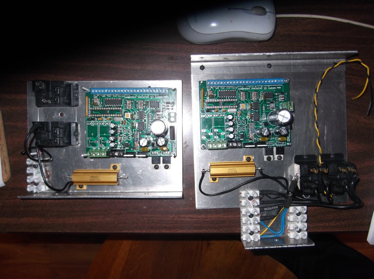

Is there a photo or layout of the new board available? Maybe I missed something...
Photos http://www.diyaudio.com/forums/soli...-century-protection-board-38.html#post4189700
Schematics http://www.diyaudio.com/forums/soli...-century-protection-board-39.html#post4189974

Getting close...
A question for Jeff -
C2 , decoupling for the CMOS 3V regulator input , does it have to
be 152 (1500pf) could a .01uF work here ??
Also , can the 2n5551 (Q4 or Q5) be just about anything.??
They are zener protected and only see logic levels at output.
BC550 would be reverse pin and mpsa42 would be pin perfect.
Any special quality of the 5551 for this part of the DC detect circuit ?
Want to be perfect with both (below). Designed "anal" control
assemblies for both sub and main amp applications.
Since I only have enough MOSFETS for the main amp SS relay's ,
the sub will be paralleled mechanical's ( good enough).
SS relay PCB's might have to be trimmed down a little (tall) -
I'll have to check when I install.

C2 sets the speed of the AC failure detector. I installed 1500pF because it was in front of me at the time. It can likely be much smaller. It just needs to take enough ripple off the half wave rectifier to keep the voltage detector from triggering.
The DC detection circuit is Valery's design but I don't think there's anything special need there.
You can chop the top off the SS relay. The mosfets run stone cold with 400 watt sine waves running through them (I think I did the math right. 40VRMS into 4 ohms?)
Cool. I have 470p (silver) 680p , 1000p for C2.
So thats the AC detect , I thought the ATmega needed another supply.
All it needs is just 5V (Vcc).
