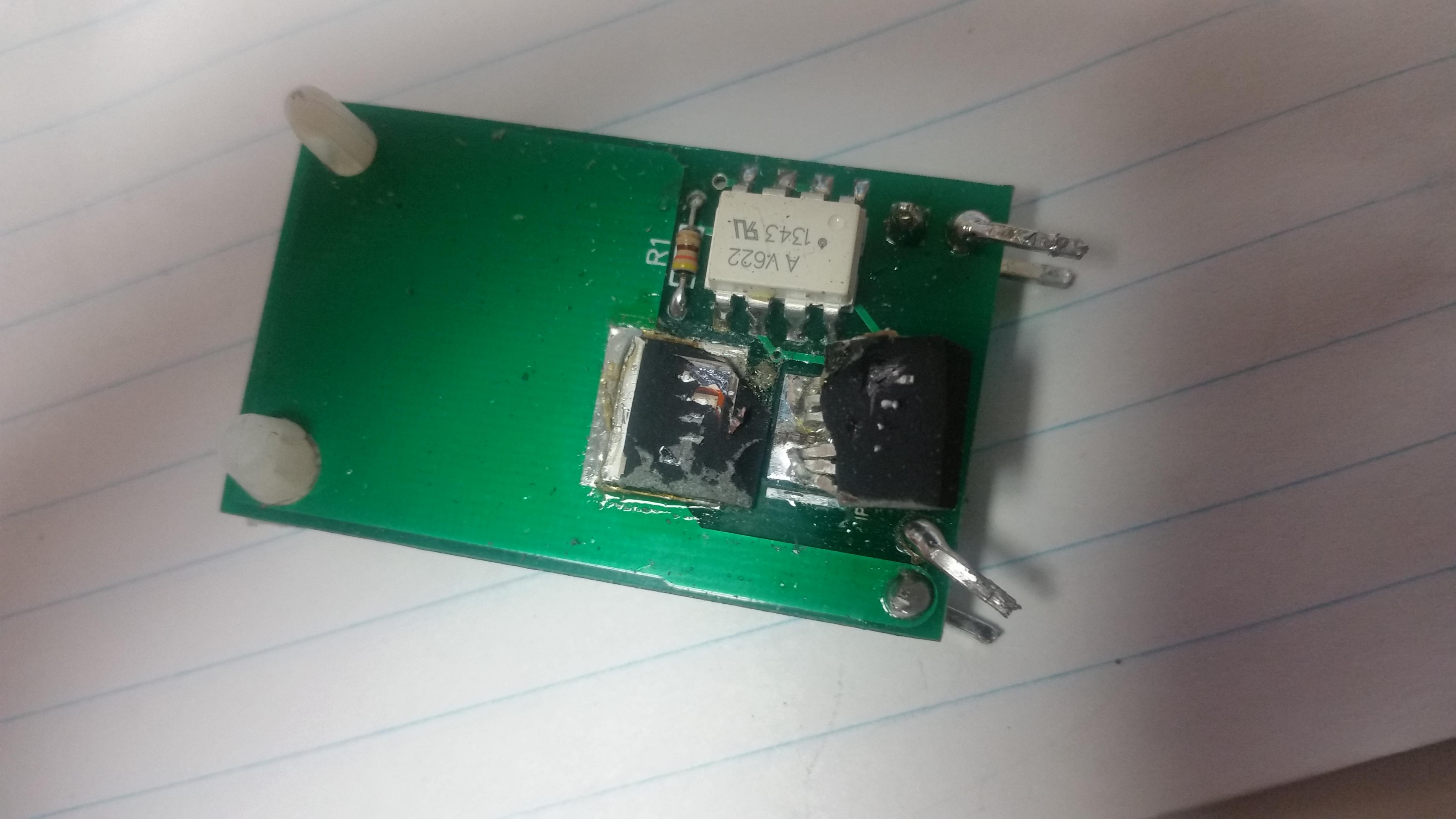

On the 3 pair MT-200 , I shorted it out accidentely. Just blew the 15A fuses ,
fired right up after. But it was not oscillating (wolverine).

I always assumed it was like shoot through in Mosfets. There was likely a pretty good voltage spike when the transistors blew that took out the Mosfet on the relay.

They are only 100V mosfets. Maybe higher Vdss (300V is common) ??
OS
They're 100V mosfets in series so 200V. I think these did good. I was running everything hard for 10 minutes before I manged to get the meltdown to happen. The 1kva transformer was even pretty warm.

Actually, though the MOSFETs in the relay are mechanically in series, electrically speaking it is really just one or the other. When the relay is 'open' the voltage applied appears across one or the other MOSFET depending on polarity. This is due the the fact that a MOFFET has a 'parasitic' body diode that forward biases leaving the other MOSFET to block the full voltage.
So long as catching diodes are installed the relay should work for any reasonable DIY build with no problem. If you go full paranoia you would really go for 200V or higher Vds devices, at the expense of Rds specification. That is the beauty of the devices chosen, the Rds specification is really good for a 100V device.

Yes you are right again. Even at 100 volts these should be good for just about any amp though.
The test was a success anyway. The relays run cool. I wasn't able to measure any voltage drop across them in operation. The catching diode in the device withstood current better than the mosfet itself and the mosfet went open circuit on failure. All good.
