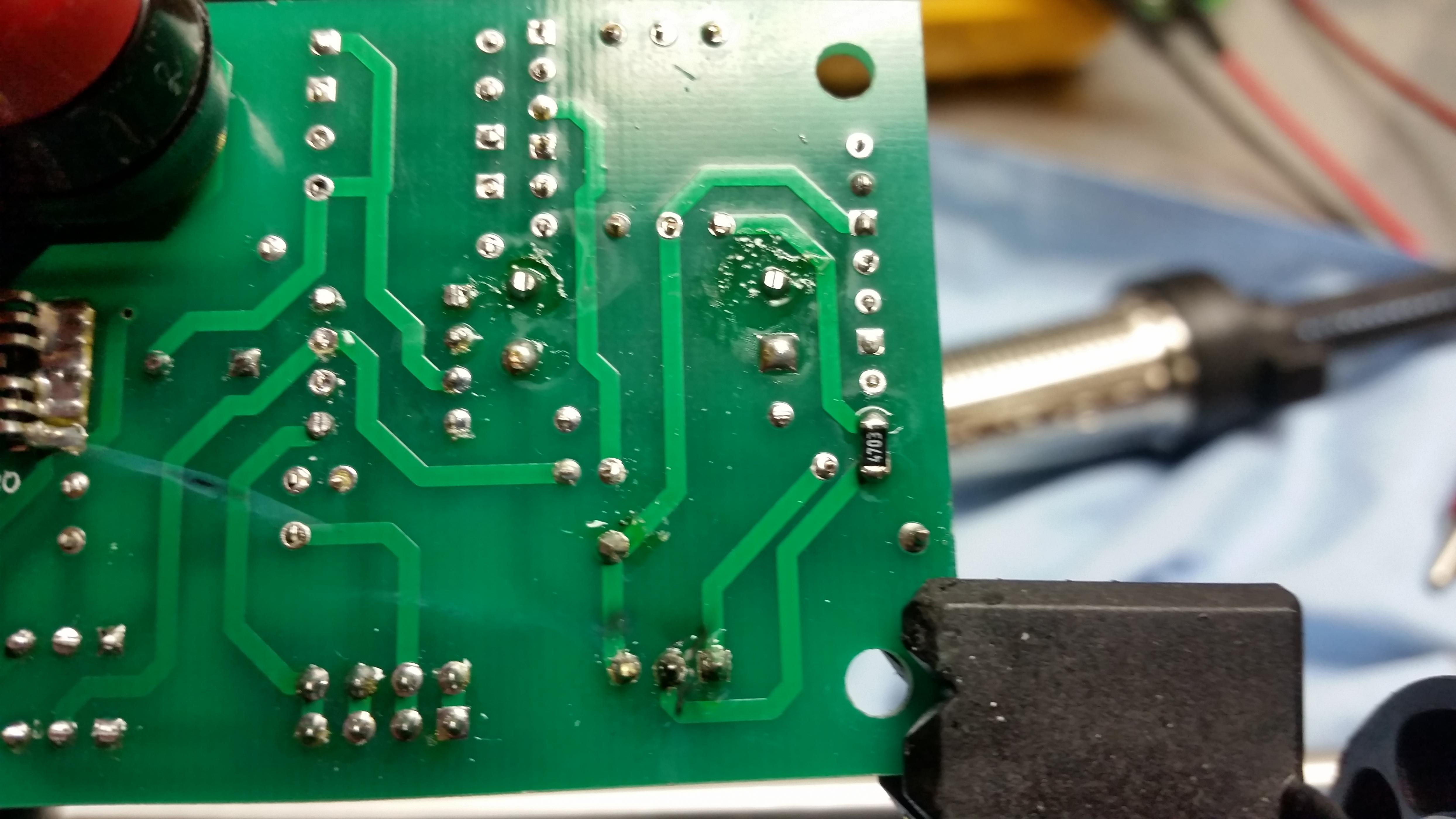

Thanks for working this out. Also 470K from B to E on Q4.

The extra 470k resistor is an easy addition. I used a 1206, but an 0805 would fit better.
