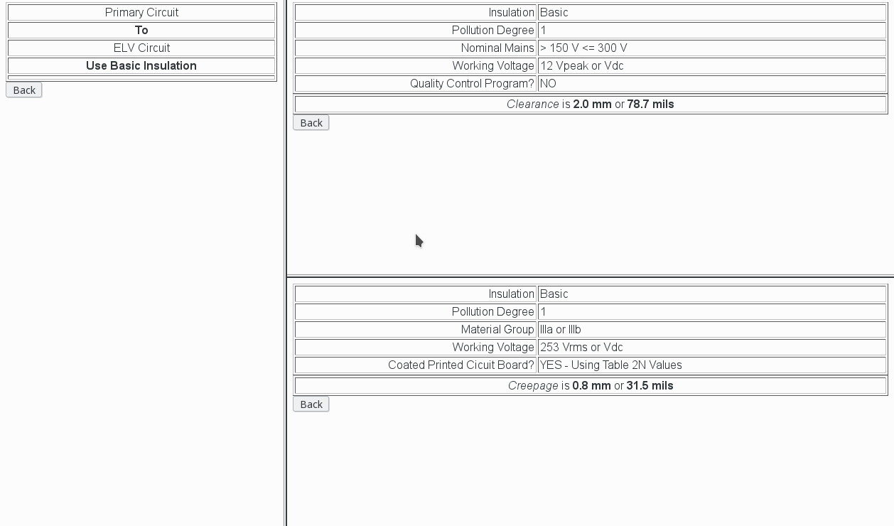

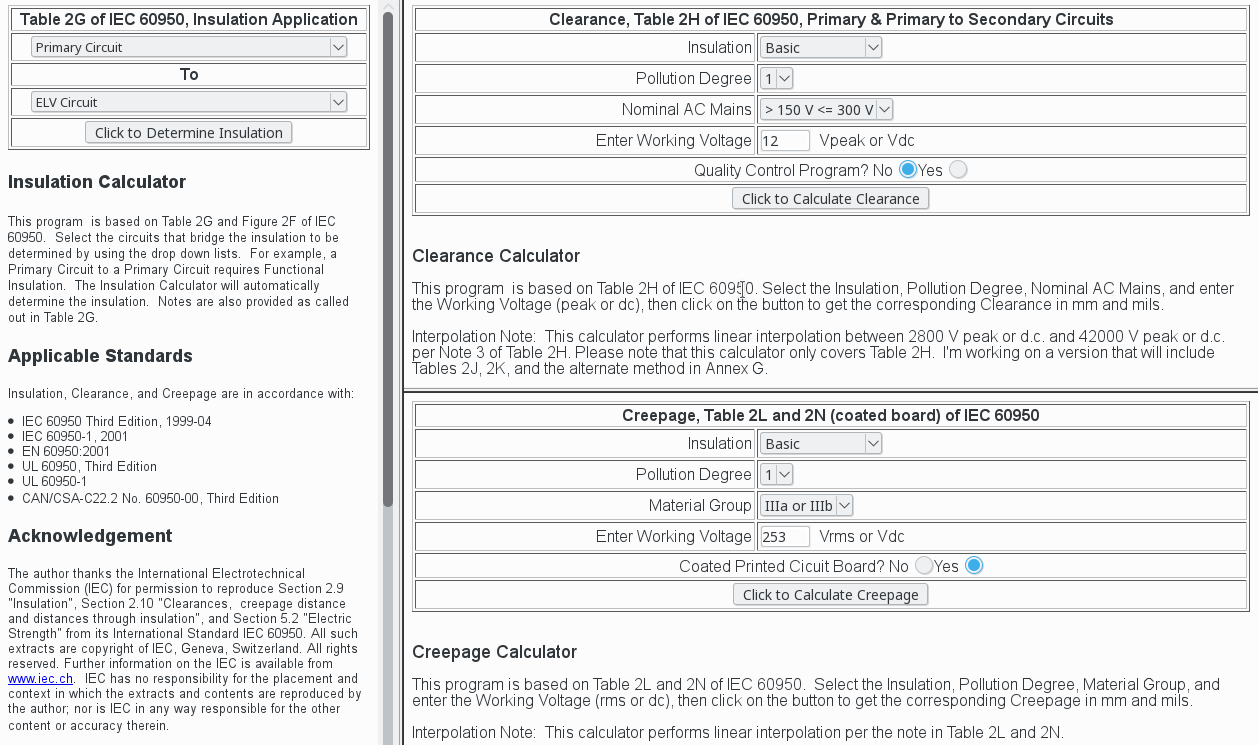

OK! I still think there must be more distance to small signal voltages ...Yes that was a typo. I meant to say 32 mil. The traces aren't anywhere near that close. If anyone is concerned about it, they can remove the top unused mount lead on the relay.
IEC60950 calculator: WWW.CREEPAGE.COM Welcome!
The resulting values are minimum values interpolated.
IMHO: DIY PCB's should/could deliver higher safety as industrial minimum as most of us do not have the testing equipment to check the safety...

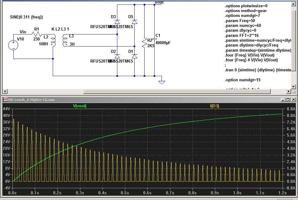

I simulated it, may be a bit overly simplified, but it should give a valid idea. Assuming the bleeding resistors are the only load, the DC rail voltage should be able to reach 42V at 1.2S mark.

Perhaps not so quickly. I mean, the simulation shows even with a 230-ohm inrush limiting resistor, the DC rail should be far greater than 10V as you measured after a few seconds. Something is not quite right.
