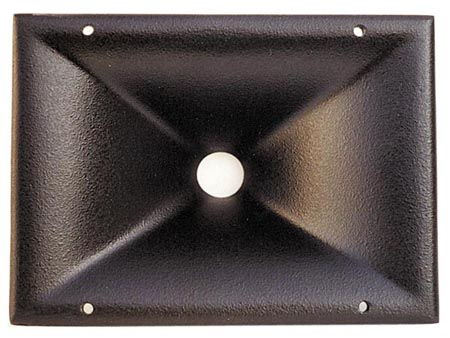

It is mainly for curiosity and measurements because this horn is very, very cheap. The build quality is simply atrocious and i will never mount it on a loudspeaker cabinet since the surfaces in contact with the wood are not flat at all and the entry of the throat had been massacred with a cutter.
Simply unusable... but ultra cheap
Edit : the pocket knife modified entry measure more than Ø28mm on a horn and Ø24mm on the other

I'd rather prefered to do it by myself, since i'm one of the rare people who are graduated to make mecanical parts with abrasive hand tools.
I've got a recognized diploma and valuables professionnal experiences in aeronautics, it would be a intense pleasure for me to show my skills.
This massacre seems to be executed by a drunkman with a chainsaw and there is too much damages to repair it.
Metal casted horns produced by high quality brands will be my future choice, but my 5€ Fane horns are very well molded, the problem is not the price tag IMHO... no the real problem is the COMPETENCE![clown :clown: :clown:](https://files.diyaudio.com/forums/images/smilies/clown.gif)

7mm of curvature on the horn straight lines (or supposed to be), i can't deform it to flat even with all my body force, even with a thick joint it will never be air tight.the problem is not the price tag IMHO... no the real problem is the COMPETENCE![]()
It also feel some waves in the horn profile, there is so many defects that simply impossible to list them since i would be ridiculously long.
![](https://nsa39.casimages.com/img/2018/02/16/180216103428992484.jpg)

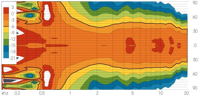

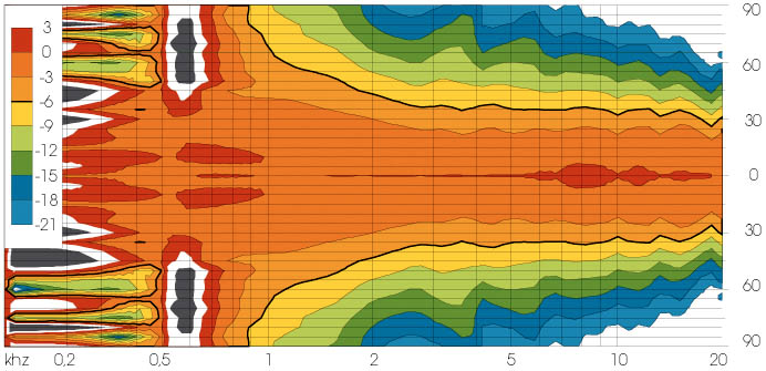

That's unfortunate and unacceptable, maybe yours are from a different manufacturer.
These are supposed to be very good, expensive though:
Or these if you want a "true horn". Cut off = 800 Hz (around €30):

The manufacturer don't respond to my mails because he is probably thinking that the quality is "good enough" for a PA application.
It seems to be a gobal POV in the whole PA world, i don't really like it and this is also why i dont buy ready made PA stuff.
Nothing will ever change on this planet (and i don't care)... that's why i've choosen to DIY my horns.
