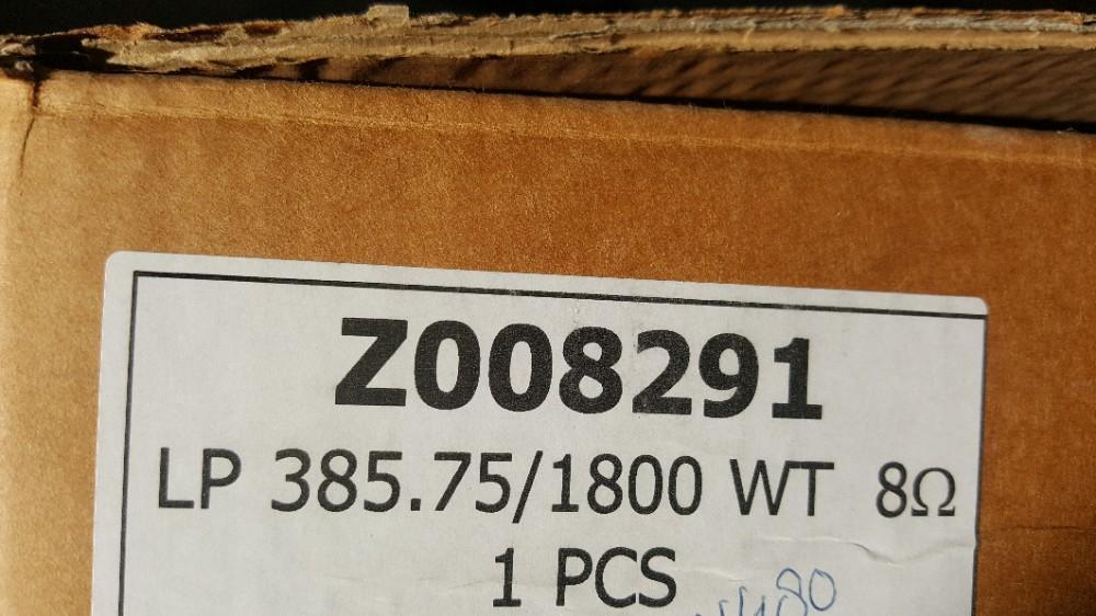

Yes, the measured T&S differs a lot from the manufacturer ones and the effciency is around 97-98Db, it starts to decline rapidly under 200Hz.
Sorry i'm too lazy to do the maths, but the efficiency is physically limited with 25 liters, this driver will not go higher.
This unit looks like a rebranded celestion.
That's not far from the truth. Celestion and IMG Stageline/Monacor are brands from the same holding company.
Aside from very few exotic exceptions, most larger cones will be physically limited with 25L.

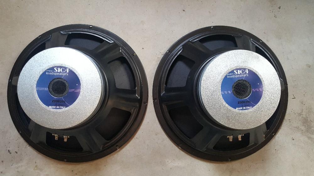

I've bought some specific MDF (resin doped) with diferents colors in order to make great modular orientable enclosures.I have these as well.
Sherefore, Silverprout is working hard on the cabinets
The response graph I posted a few pages back is from a Sica 15"
You may consider this woofer, beautifully made (in Italy) with only a few parts from China:
and this Compression driver (the Poly version, though the Titanium version is cheaper and also very good):
Very high value for money, but compare prices between different shops, because they tend to vary.

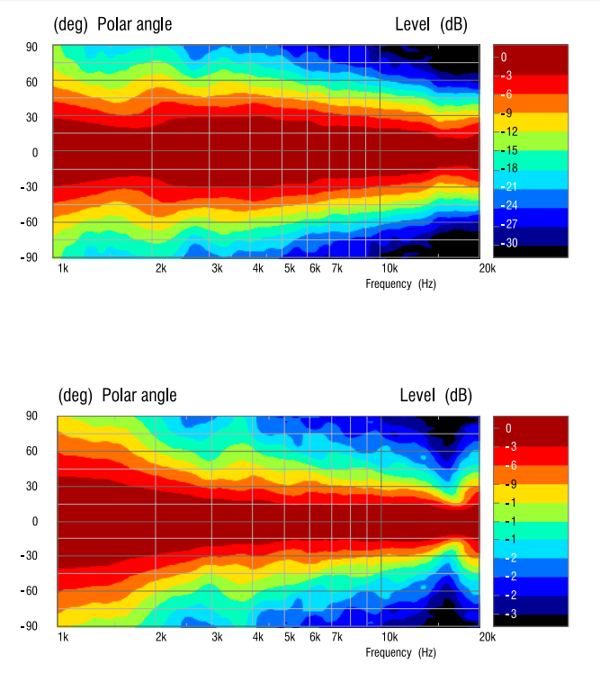

The throat is quite smooth, similar to the QSC/PRV waveguide:
Response with the comp. driver from above:
![Sica_q07015a_Horn.jpg](https://h-audio.de/images/product_images/popup_images/Sica_q07015a_Horn.jpg)

It's deeper and its initial expansion rate at the throat is lower compared to many known waveguides, which isn't necessarily a bad thing. I skipped the SEOS for this reason. Does this make it a typical horn? I don't think so.
The polars aren't too bad and it definately doesn't sound like a typical (diffraction) horn. I think I'll customize mine somewhat by adding roundovers at the mouth. Might even make a mold from the innards with added roundovers and "press" a horntop in liquid wood.
