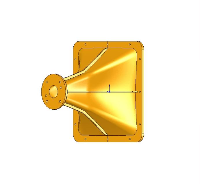

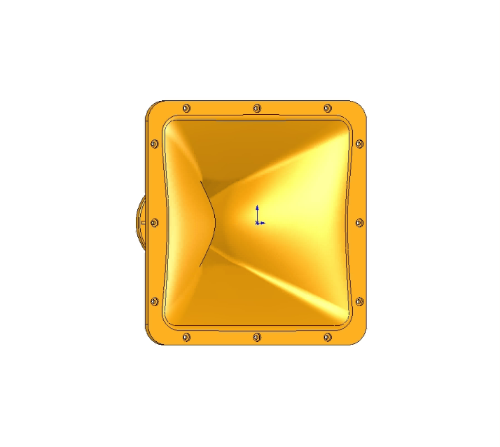

In essence, the PT and Image Control waveguides are much the same. I've included 2 images from a CAD drawing in which similar features can be distinguised, including knuckles that mitigate the diffraction slot.

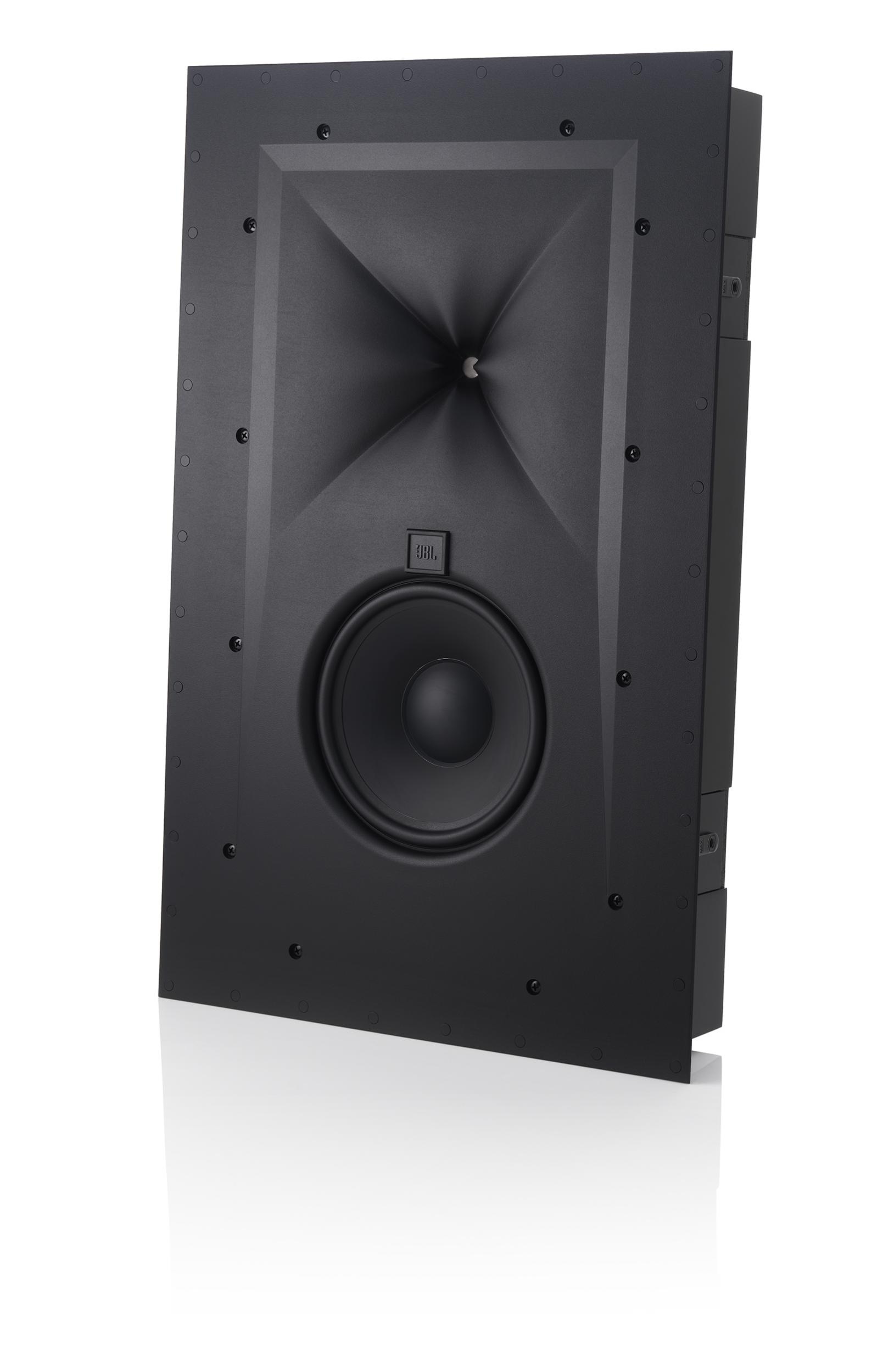

Within the Synthesis line there is an exception: the recently launched SCL In Wall series, that use a WG similar to the M2 (image below).
You saw this coming: these are intended to be wallmounted in a multi channel cinema setup and could be located quite close to some seats > nearfield.
