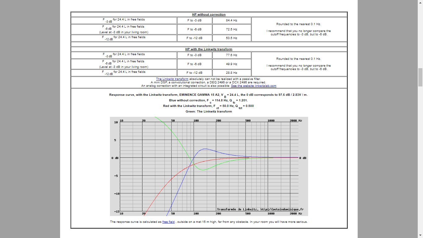

I'm building a Geddes inspired desing apdapted to a small bedroom for a near field very low listening level purpose.
The goal is to keep the sensivity as high as possible around the multisub crossover frequency and an Eminence Delta15A2 can reach more than 97dB at 100Hz (25L-1.10Q)

Do you mean the Eminence Delta 15A, or perhaps the Gamma 15A-2?
Yes, sorry for the mistake, i mean the Gamma 15A-2.
Is this something you had in mind?
The LT is the worst thing i ever tested with a closed box loudspeaker, it make every parameter worse in every area.
The closed box configuration can be good enough for me if you reduce the mecanical overshoot of the damped oscillation of membrane by filling all the internal volume with long fiber whool, the Q should lowered about 10% IMHO.

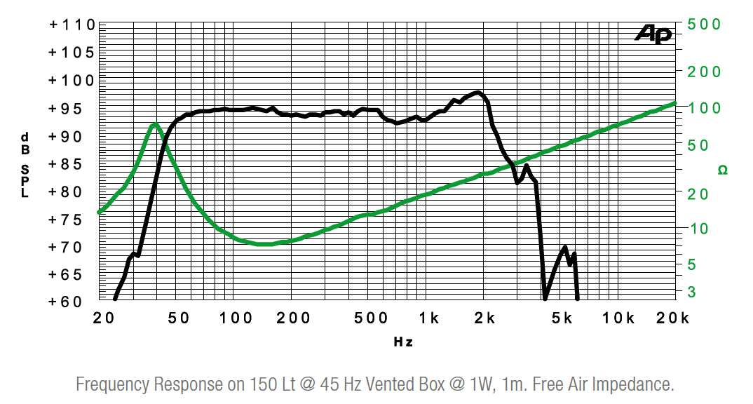

I am not a fan of LT either, but that Gamma 15A-2 is not designed to be used in a closed box. Moreover, it you won't give you 100dB @ 100 Hz.
Admitted, it's not the best graph ever and it's only 95,8dB, but this is a very good, well-behaved driver from a brand I know well. You could build a Geddes Summa style (BR) 2-way with this for little money. There is a build to order version available through a local dealer that's even better. Not available in the US though.
The 25 liters stuffed closed box solution with an Q around 1.07 will have an efficiency around 94dB at 100Hz.
My final choice with a 12' in 25L gives me around 92-93dB at 100Hz, if you have a solution for going higher in 25L...

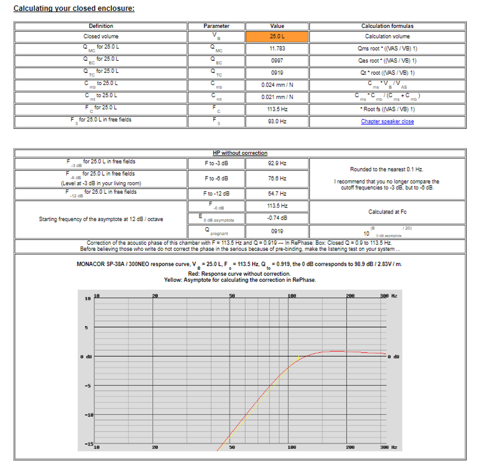

This one, it's expensive for a pressed steel chassis, largely due to the neo magnet. The Germans love it.
It's not optimal, but at least close to your target of 100dB.
Here's the driver in a 25L and a 30L CB:
