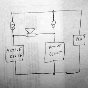

I maybe flogging a dead horse here, but I still don't get it.

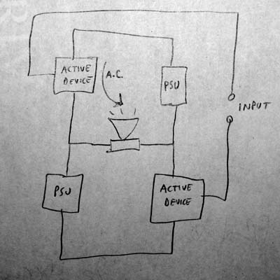

I've attached a sketch.
Forget the DC currents, there's no signal in there.
The arrow indicates an AC current, the signal, flowing out of the top active device and then through speaker. Current goes in loops, it has to find it's way back to the other side of the top active device again. It does so by going through the top psu, which is floating.
So the signal current goes through both psu's.
There are only so many ways we like to build an audio power supply. Transformers with rectifier diodes or switch mode power supplies are not conducting constantly. Recitifier diodes only conduct when they are forward biassed and have to be followed by either a capacitor or an LC filter. Switch mode supplies have to have an LC filter. Any AC currents flowing through the Circlotron power supplies flow through the last capacitor in the power supply.
So as far as I can see, the Circlotron always has a capacitor in the signal path.
Sure you can use batteries, but they're just really large capacitors !
I don't believe I've ever seen an audio amplifier design without a capacitor in the signal path somewhere.

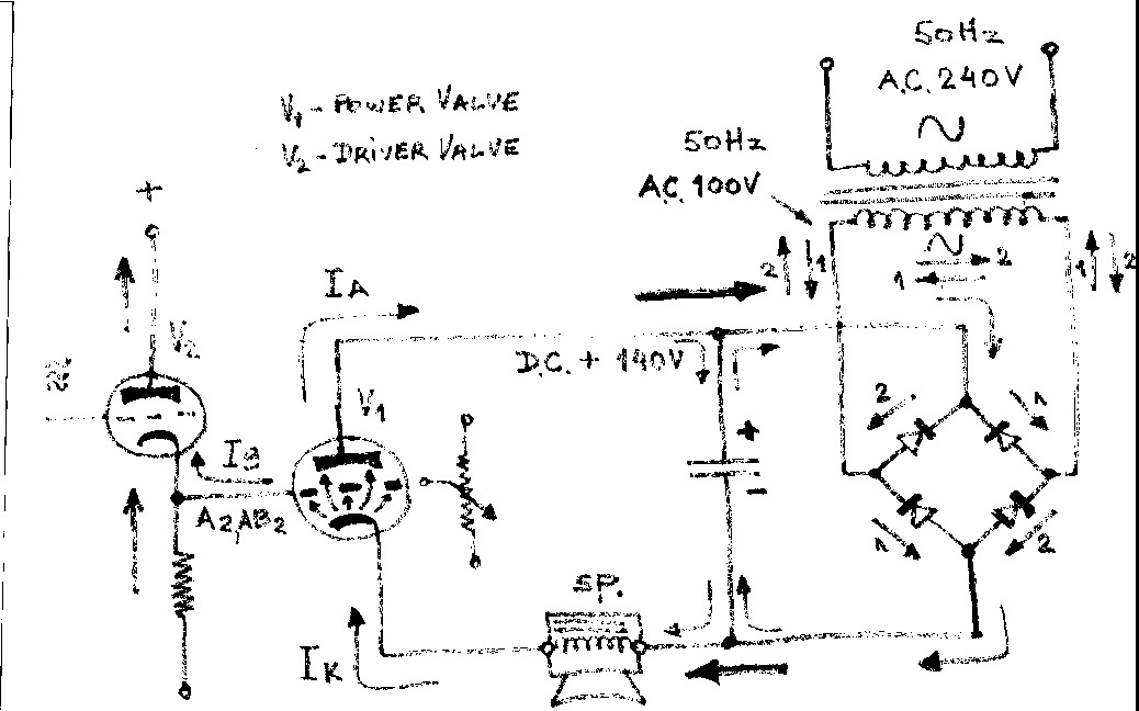

Here is two simplified schematic with DC flow analysis.
One picture is only for half Circlotron circuit,and second is for whole Circlotron circuit.
Same analysis is valid for SS Circlotron Amps when we use SS aktive elements,similar like in
Audiodesign Diy Member Hybrid Amps.
Conclusion:AC power goes Only trough the Load(Speaker), like produkt of Oposite kathodes
PP DC curent flow, aranged in Circlotron PP output power stage circuit.
Best Regards for All:wave:

Look at your picture on the left. The signal (i.e. the AC current, not the power from the wall socket) flows through the two capacitors you've drawn.
I hope we're talking about the same question ? I'm just trying to explain why the Circlotron has two capacitors in the signal path. I'm not talking about DC at all.
Nope,This four small arrows on the half Circlotron circuit picture sign the charge/discharge current direktions of this kapacitors(C).
They are constantly charged from the bridge rectifier with 100Hz DC pulsating current,and constantly discharged from Output power Tube and Load(Speaker), both conected in series.Mentioned before:This two kapacitors are just two Big energy(DC current) reservoirs.
But trough this Kapacitors dont flow any DC or AC current,except if this kapacitors `leak` or is internaly shorted,(but that well be produce Amp mallfunction kondition).
