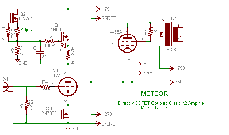

My 0.02 here:
Just because signal current is supplied by a capacitor does not automatically mean that said capacitor's dynamic resistance appears as distortion of the signal.
Consider the example circuit attached. Q1 drain is supplied by a bridge rectifier and a single cheap-az electrolytic capacitor. It has a few ohms or even tens of ohms dynamic resistance at audio frequencies.
Q1 source-drain dynamic resistance is in the megohm range at audio frequencies.
Q1 transfer conductance is about 50 mA/volt which provides a dynamic source resistance wrt the input signal of about 20 ohms.
So the equivalent circuit is say 1 megohm (MOSFET s-d) in series with the generator, with an equivalent "load" of say 100 ohms (the capacitor) "reflected" back to a 20 ohm source resistance.
Not a lot to worry about, I would say, in this case.
If the active device is a triode or something with local feedback then the dynamic resistance to the capacitor becomes much smaller and we start seeing significant effects.

Hi Michael;
the same current flows through both drain and source, so dynamic load resistance is exactly reflected on drain & filter capacitor.... What AC flows through Miller capacitance of output tube, is added to AC through filter cap.
True. The feedback ("miller") capacitance is a big component of the megohm dynamic resistance that isolates the 20 ohm source from the ~100 ohm "load" made by the dynamic resistance of the electrolytic cap. So the audio current imposed on the cap is indeed equal to the audio current at the stage's output. But the back-reflected dynamic resistance of the cap is attenuated by that megohm (or so) dynamic resisitance of the MOSFET (in this example).
What I'm saying is that the PSRR of something like my example is very high, and that self-same PSRR also functions to isolate the potentially nonlinear dynamic resistance of the power supply output filter from the audio "signal path". In the case of my example at least.
Michael
PS Would the effect of the back-reflected nonlinear dynamic resistance of the power supply filter be measurable as an added component in the output spectrum of the amplifier?
