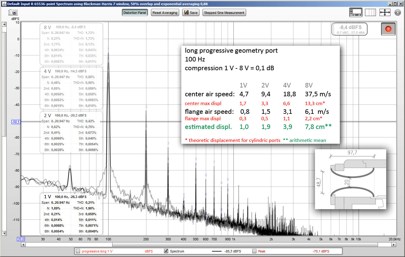

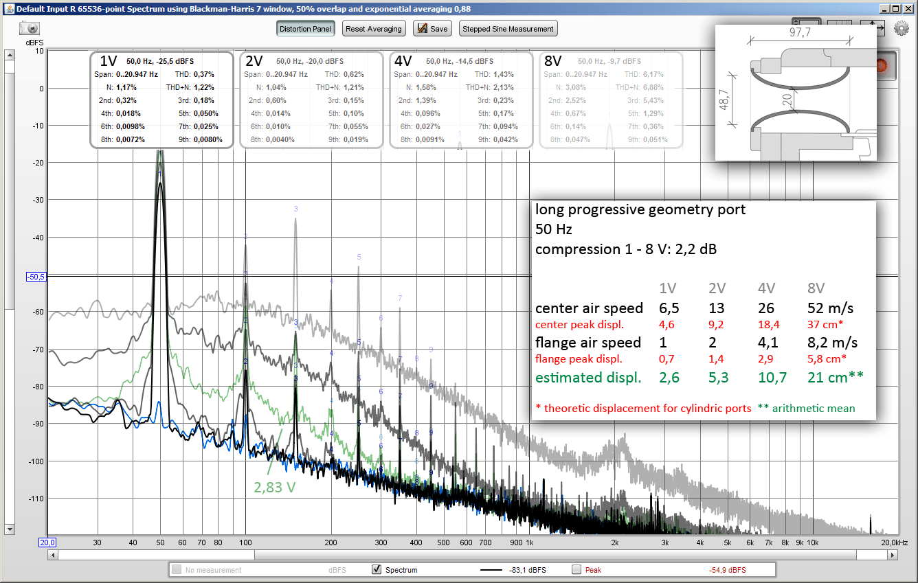

air particle displacement estimation
from the simulated peak air speed in the port (simulated in hornresp for two corresponding ports with the minimum and maximum diameter of the curved wall port) I calculated the theoretic displacement for air in a virtual tube port.In a curved wall port the air is being slowed down when travelling to a wider port section, so as a first very rough estimation I just took the arithmetic mean value (green numbers).
again, this is for the long progressive port, 50 Hz and 100 Hz (same graphs as in post #349, with added information):
![240129-pro_lo_50Hz.png 240129-pro_lo_50Hz.png](https://www.diyaudio.com/community/data/attachments/1174/1174472-b03c81e4046a36172b04f109a3907659.jpg)
![240129-pro_lo_100Hz.png 240129-pro_lo_100Hz.png](https://www.diyaudio.com/community/data/attachments/1174/1174473-8b5b03429b0149436ae719fa8354b02b.jpg)
OK! now it's getting clear:
the low frequency turbulent flow in the port relates mostly to the displacement.
the 100 Hz fundamental and harmonic peaks start to widen up at 8 V, corresponding to an estimated displacement of 7,8 cm.
looking at the 50 Hz graph the widening of peaks will be similar a bit above 2 V (corresponds to 5,3 cm).

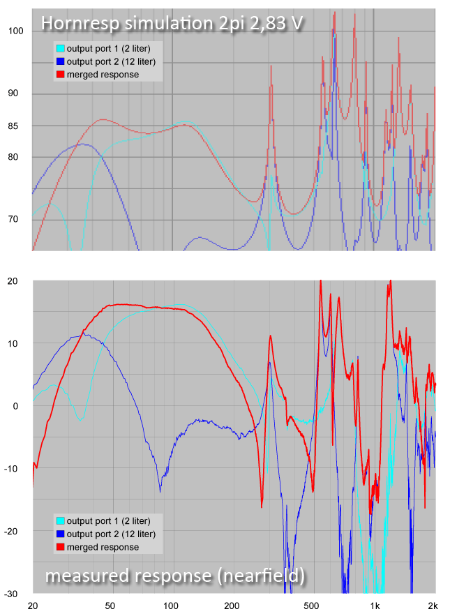

Quick question, isn't this port tuned to 100Hz? So 50Hz would exhibit far different behaviour than at or above tuning.
Also maybe I'm being dumb (had a few beers tonight, worked all weekend!) but why does it matter physically if the displacement equals the minimum diameter of the port? Like why does that matter to the way the air flows longitudinally?
here is the simulated and measured response (port 1 in cyan):isn't this port tuned to 100Hz?
![230721-DSA135-BP6_resp.png 230721-DSA135-BP6_resp.png](https://www.diyaudio.com/community/data/attachments/1174/1174487-b74ee0a4fd89739228b6e4d61b964ca4.jpg)
the small chamber with port 1 is tuned to about 70 Hz, but as this is a 6th order parallel bandpass there is output from about 50 to 110 Hz.
the max SPL is around 100 Hz, but the max port speed (and displacement) is at 50 Hz. I did not realize that myself and kept testing the max output frequency (100 Hz) instead of the max airspeed/displacement frequency (~ 50 Hz) until recently.

this was introduced by strouhal and I guess there is no strict physical causality but a correlation caused by more complex mechanisms. It's probably just a rule of thumb.why does it matter physically if the displacement equals the minimum diameter of the port?
in my intuitive undestanding the directed air flow to the outside is separated because when air flows back into the port from the sides (thus -> radius) it separates (constricts) the air that still travels out and away from the port (port blowing).

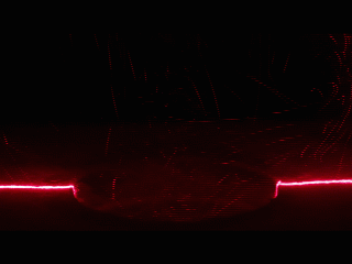

... just a quick little teaser, prior to my small knee surgery tomorrow:
the 120 fps camera did provide some interesting results!
this was a first test, to confirm feasibility, using a cheap rented DSLR (canon 90D).
the more expensive 300 fps camera (panasonic GH6) comes next!
this is the setup:
the laser is aligned to the port axis, the speaker and the laser are slightly rotated, so i can pour flour from above into the laser plane.
the camera is more or less perpendicular to the laser, because the macro lens has a tiny depth of field with the wide open diaphragm. this is necessary, because the laser has only 5 mW and the frame rate sets the limit for maximum exposure time.
as a first test i took three port openings of the lower tuned chamber two (35 Hz).
the ports have a 4 cm interior diameter cardboard tube and different port openings:
here come three short GIF excerpts of the videos, with 8 Vrms input (click thumbnails for animation!):
keep in mind that 8 V rms is quite high for this small woofer, air speed and displacement are also high (simulation results will follow!).
1 - hard edge:
no, no. no! we don't want to see that!!
actually, we don't even see the highest speed central "jet" created by the blowing port... particles are to fast!
2- rounded flange:
well, maybe a bit better, but there is still a lot of high air speed turbulence going on.
3- flared port opening:
YEESSS! this is better! oscillating particles from center to perimeter of the port! all particles seem to just travel forth and back. this is an ideal velocity-pressure transformer!
it seems incredible, also to me, but the input voltage was exactly the same for all videos!
and of course the visible turbulences were VERY audible!
I plan to edit a short video in full HD, showing port particle movement at different voltages and edit in the (real time) audio.
have a nice evening!

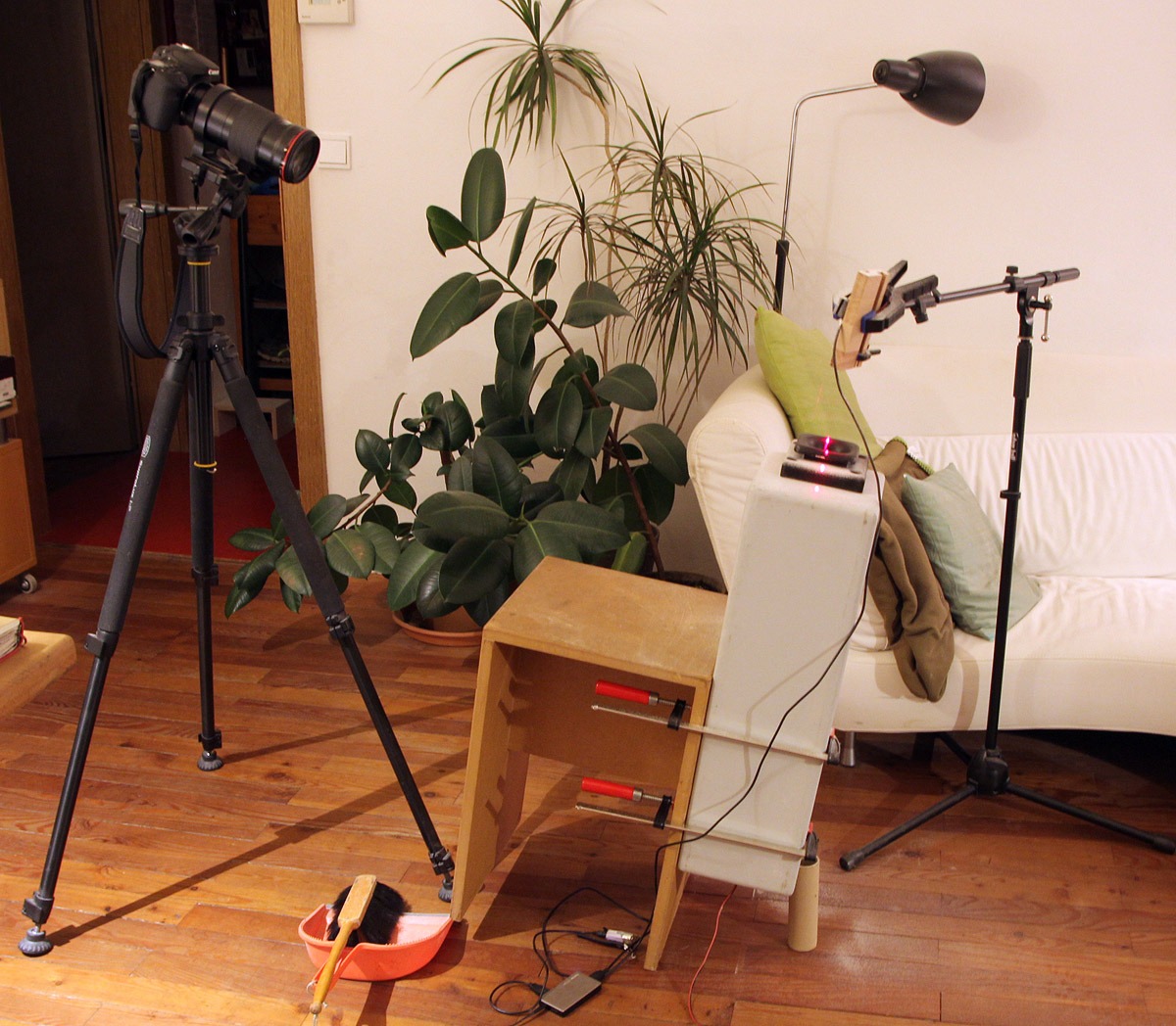

this is the setup:
![setup.jpg setup.jpg](https://www.diyaudio.com/community/data/attachments/1175/1175073-a8d9988c27eb60e6448a9cfe6f8ce9d5.jpg)

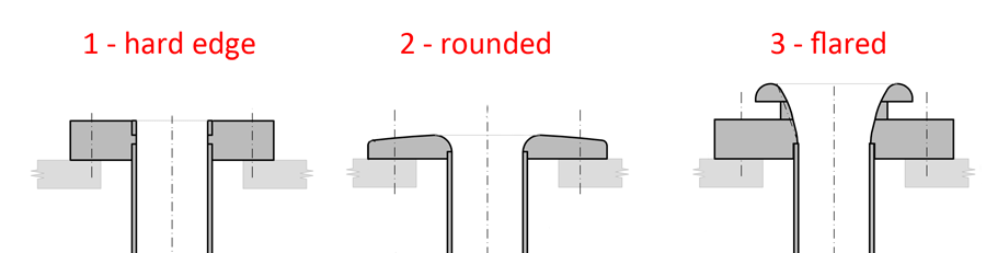

![240130-flare_variants.png 240130-flare_variants.png](https://www.diyaudio.com/community/data/attachments/1175/1175074-8a100f54a51fa881bfcda0085b1c66f0.jpg)

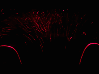

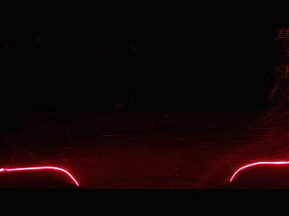

1 - hard edge:
![hardedge.gif hardedge.gif](https://www.diyaudio.com/community/data/attachments/1175/1175076-35b074bb5e1358dbc66ca865b24f66da.jpg)
2- rounded flange:
![rounded.gif rounded.gif](https://www.diyaudio.com/community/data/attachments/1175/1175077-1085950cb4926c128fcdf85d99fe995f.jpg)
![flared.gif flared.gif](https://www.diyaudio.com/community/data/attachments/1175/1175075-13a5dc16fba03a43f3933447df9e0413.jpg)

Thanks @horn_power !Nice pics and nice overall analysis.
Hope you enjoy the latest animated pictures!

sucking and blowing is just what the air in the port is doing. I want to reduce the speed of that motion as much as possible towards the exit to get a efficient (big surface) transformation to pressure outside the box.transport of the particles by sucking and blowing?
The problem with high port air speeds, big displacements and hard edges is that blowing tends to move into the center of the port ("jet" mentioned by roozen, i called it "blowing") but sucking happens at the port perimeter. This creates a steady airflowflow and turbulences (thus noise) and eats up precious bass energy.
Also, a hard bass reflex port edge will always create some small turbulence at this edge. Therefore noise and chuffing start already at low spl.
as the turbulences outside the port are quite chaotic (also see andy19191's explanation of vortex buildup - if i understand correctly) the noise has a quite even noise floor spectrum of straight hard edge port in post 349.
The vortex buildup inside the port for flared ports however is limited and guided by port expansion, thus seems to have a lower frequency spectrum, maybe related to helmholtz frequency, see same post (not yet sure about that).

With 120fps, you only have limited resolution. Anything above 60Hz will give problems.
Since the signal and camera (sensor) are out of sync, you can use averaging techniques over time to get a (quasi) better result.
35 Hz, port 2 of my 6th order parallel bandpass woofer.What was the tuning frequency of these ports?
That gives 3-4 frames per cycle, which is ok for a first feasibility investigation.
The third (flared port) gif animation shows it quite well, the oscillations are clearly recognizable.
The two other animations are more difficult to interpret, because airspeeds due to turbulent "blowing" is far too high and the particles already leave the picture after 1-2 frames.
A much improved video will follow soon.
Also, I will rent a 300 fps cam to catch particle movement more in detail.
