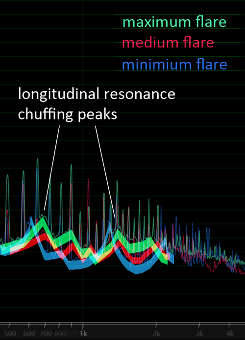

some remarks, considering my investigations so far:
even if the longitudinal resonance chuffing peaks are "buried" in the harmonic distorsion peaks, they are the annoying and audible noise.
they are NOT related harmonically/musically to the fundamental and mostly, they are being modulated by the 80 Hz fundamental tone, which makes them most audible.
a very rough overlay of your spectrum graphs with very roughly marked chuffing peaks:
![chuffing_pk.png chuffing_pk.png](https://www.diyaudio.com/community/data/attachments/1177/1177280-a19c98538c882f336e58a838f89a5e0d.jpg)
these chuffing noise spectrums make the differences in port sound, as far as I can tell.
also note that some chuffing peaks match harmonic peaks and may be masked and less audible.
as far as I can tell from my investigations the chuffing noise is heavily dependent from the port terminations.
the port terminations are responsible for (small) turbulent airflow at the port edges that again induces longitudinal resonance ("blowing noise", just like a pan flute; this is not the vortex shedding, happening at very high displacements). here the exterior termination has the advantage of being flush mounted to the enclosure, thus less turbulent airflow "around the port edge".
therefore I think the differences of your ports do not so much depend on the flare rate or the central spacing, but much more on the different internal port endings:

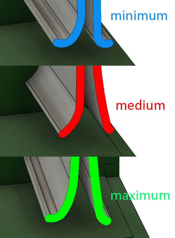

![tenson_flares.png tenson_flares.png](https://www.diyaudio.com/community/data/attachments/1177/1177283-07ba737911fbebd6249adbd3528f1ffe.jpg)
the "minimum" port has the best internal ending, having more than 90 degrees of flange bending on both sides. I suspect that is the reason for it's best behaviour.
I also think that you could try minimizing your port, for example by including a curved width. by doing so you would reduce the port lenght and improve it's resonant behaviour (better "diameter"/length ratio).
As I heard in your sound examples and can be seen in the spectrum graphs, there is no sign of vortex shedding creating wide band noise.
the exit cross section surface and thus the "virtual port radius" is probably high and for 80 Hz the particle displacement also should already be quite low.
thus the "strouhal number" will be quite high (good).

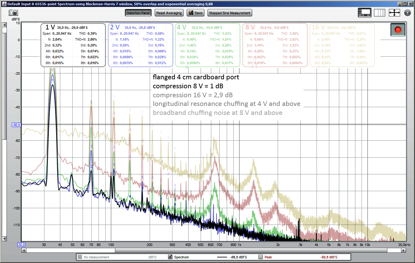

slow motion port air movement video 2: big flared port
here is video number 2:again a 4 cm cardboard tube, but with a generous flare and roundover at the exterior end.
you can find a drawing in post #103.
and the correlating chuffing spectrum measurement graph:
![240203-P2-flared_big.png 240203-P2-flared_big.png](https://www.diyaudio.com/community/data/attachments/1177/1177306-62b20c64d8b1de95491606212d8aca54.jpg)
a clear correlation between visual turbulence and the wide band noise in the spectrum can be seen!
up to 4 V the air movement in the port opening seems to stay visibly laminar and does not produce broadband noise.
the longitudinal resonance chuffing noise peaks at 650 and 1300 Hz are most likely generated at the small rondover at the interior end of the port.
once the air movement gets turbulent (big circular movements at port exit) there is noise shown in the graph from 20 Hz up to around 3 kHz (for 8 V) and further up (for 16 V).
of course and again, the higer SPL do not seem to be usable for any decent music reproduction!
compare the turbulences and the laminar air flow to the "hard edge tube port"!
I did not use water mist for this port because the air motion seemed visible enough with the flour particles.

A quick note regarding distorsion of ports:
Taking the sensible and still non-turbulent 35 Hz port output at 4 V, using the flanged port shown in the video above, the port (edit: of course the entire speaker) produces:
H2: 1,4 %
H3: 0,26 %
The measurements of hificompass of a similar size but much better driver (dayton RS-125) show the following distorsion numbers for frequencies at 100 Hz and 4 V (315 mm distance):
H2: -30 dB (= 3,2 %)
H3: -35 dB (= 1,8 %)
Distorsion rises further below 100 Hz.
So, I guess the port is usually no relevant contributor to low frequency distorsion. On the contrary: bass distorsion will usually be minimum at the port output maximum, unless the port output becomes turbulent or the driver is exceptionally good.
