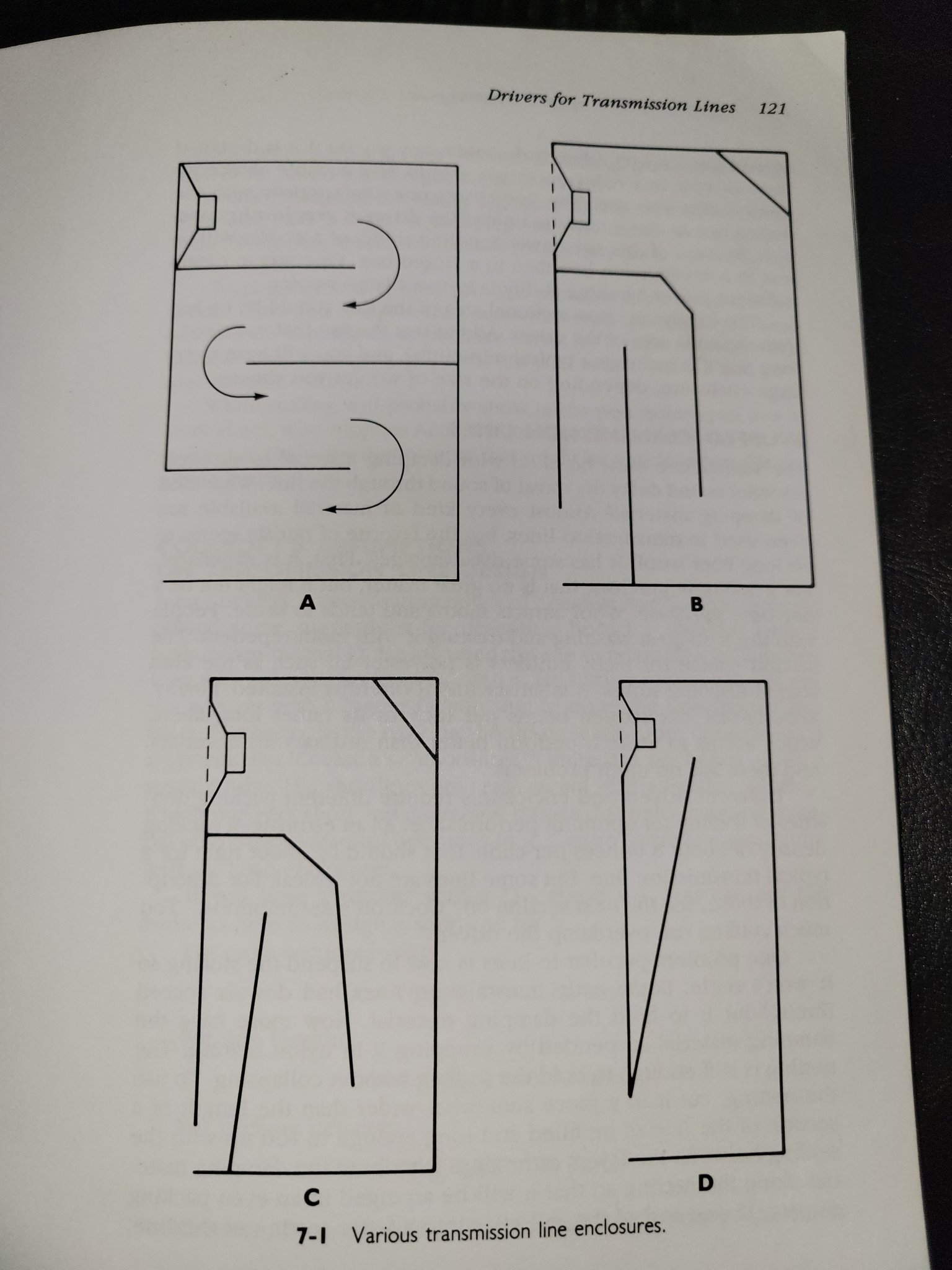

72" or greater length port equals a transmission line.

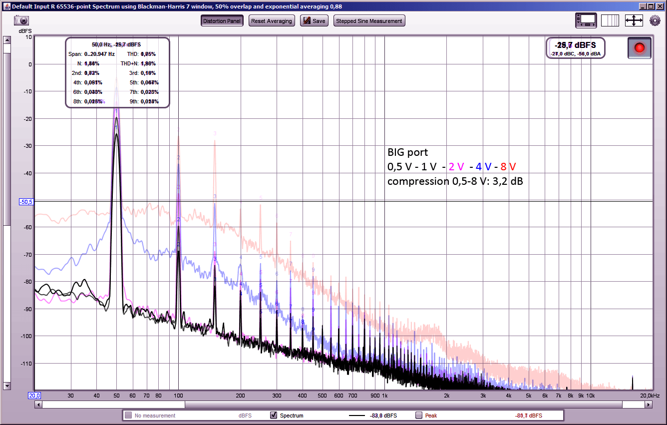

RTA graphs of tuning frequency port output​
here are the "chuffing"/"noise"/"distorsion" RTA graphs for the mentioned ports.
these images visualize intuitively
  • chuffing at port resonances
  • low frequency noise once the inside/outside directed flow separate
  • general noise of turbulent air flow
I will provide more easily digestible and comparable graphs in my next message!
one general comment: once there is visible noise in the spectrum the port is already unusable for serious music reproduction. the most annoying noise is port resonance chuffing, followed by wide range noise.
the low frequency noise is not as noticeable by itself, but it's always correlated with heavy compression, which makes noise and distorsion VERY audible!

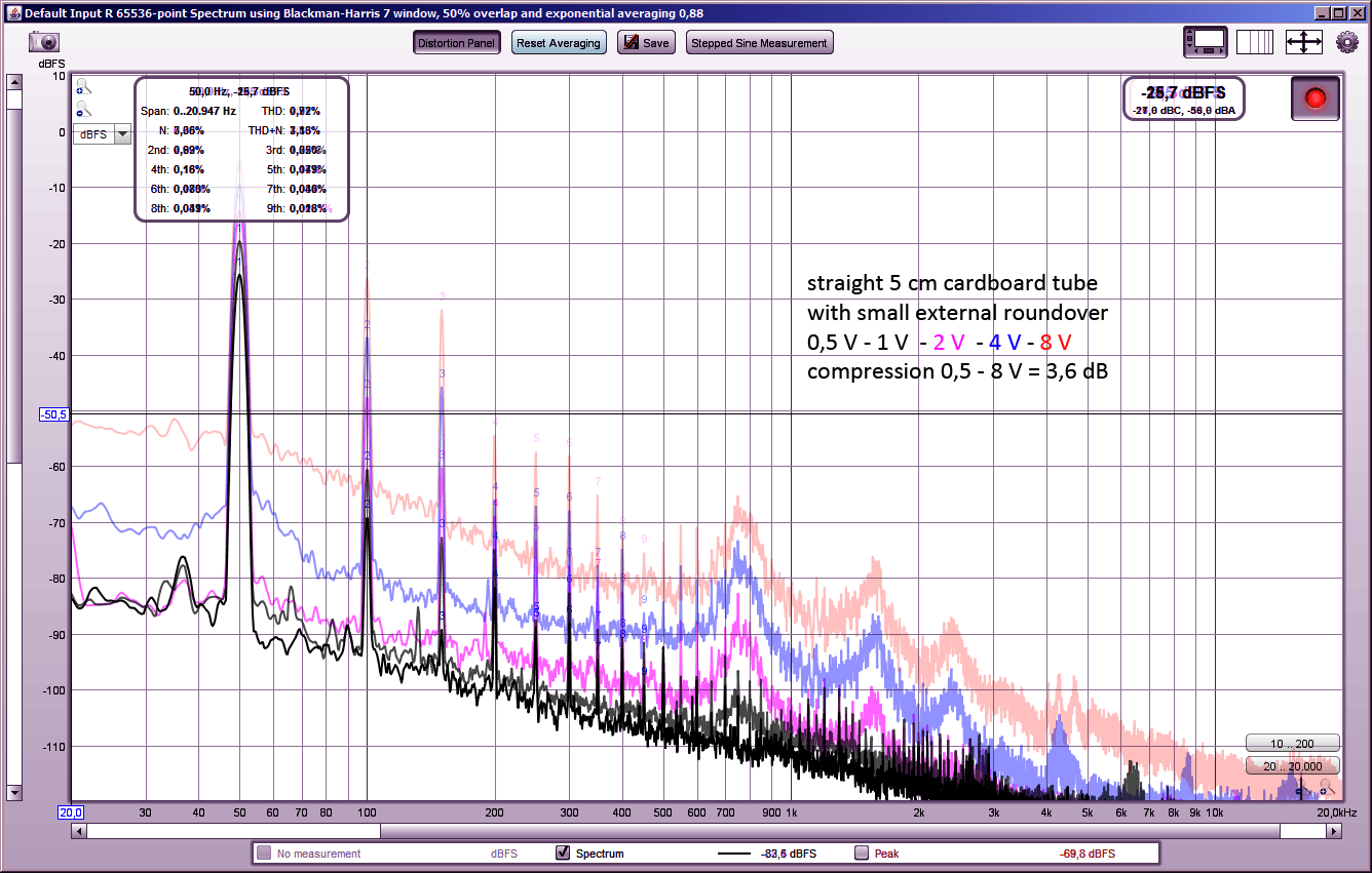

1) tube port
port resonance chuffing (760 Hz, refer to response graph above!) and general noise start at low levels. no sudden "collapsing" of output and quite good high level compression.

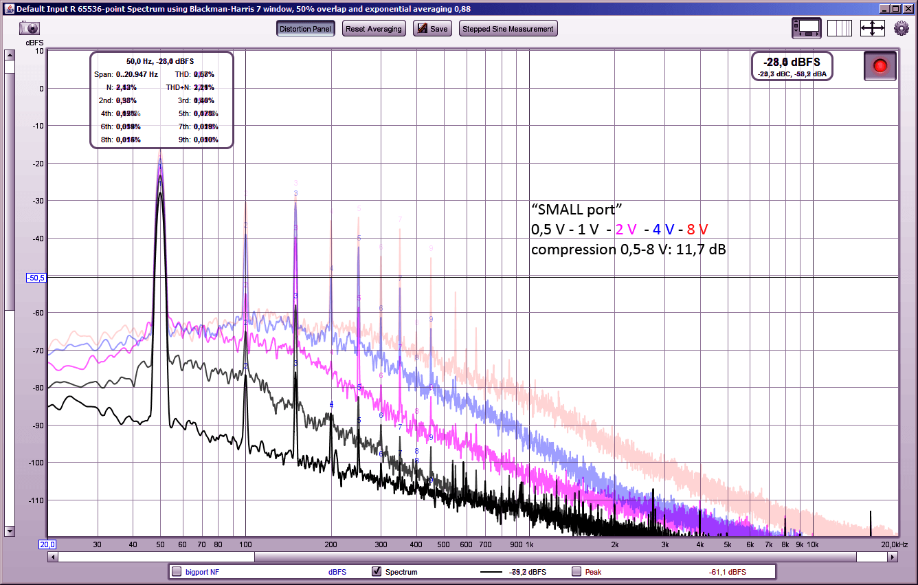

2) small port
very characteristic low frequency noise starting at low levels, indicating flow direction separation. heavy compression. no resonance chuffing.
this port is unusable for any signal above 0,5 - 1 V.

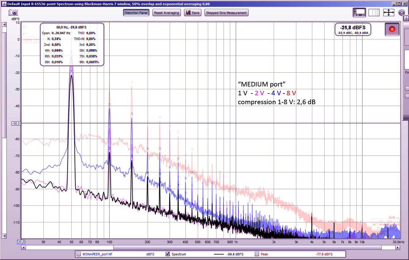

3) medium port
no resonance chuffing. rather low compression (this port is slightly more tubular than the next one!). seems usable up to just below 4 V.

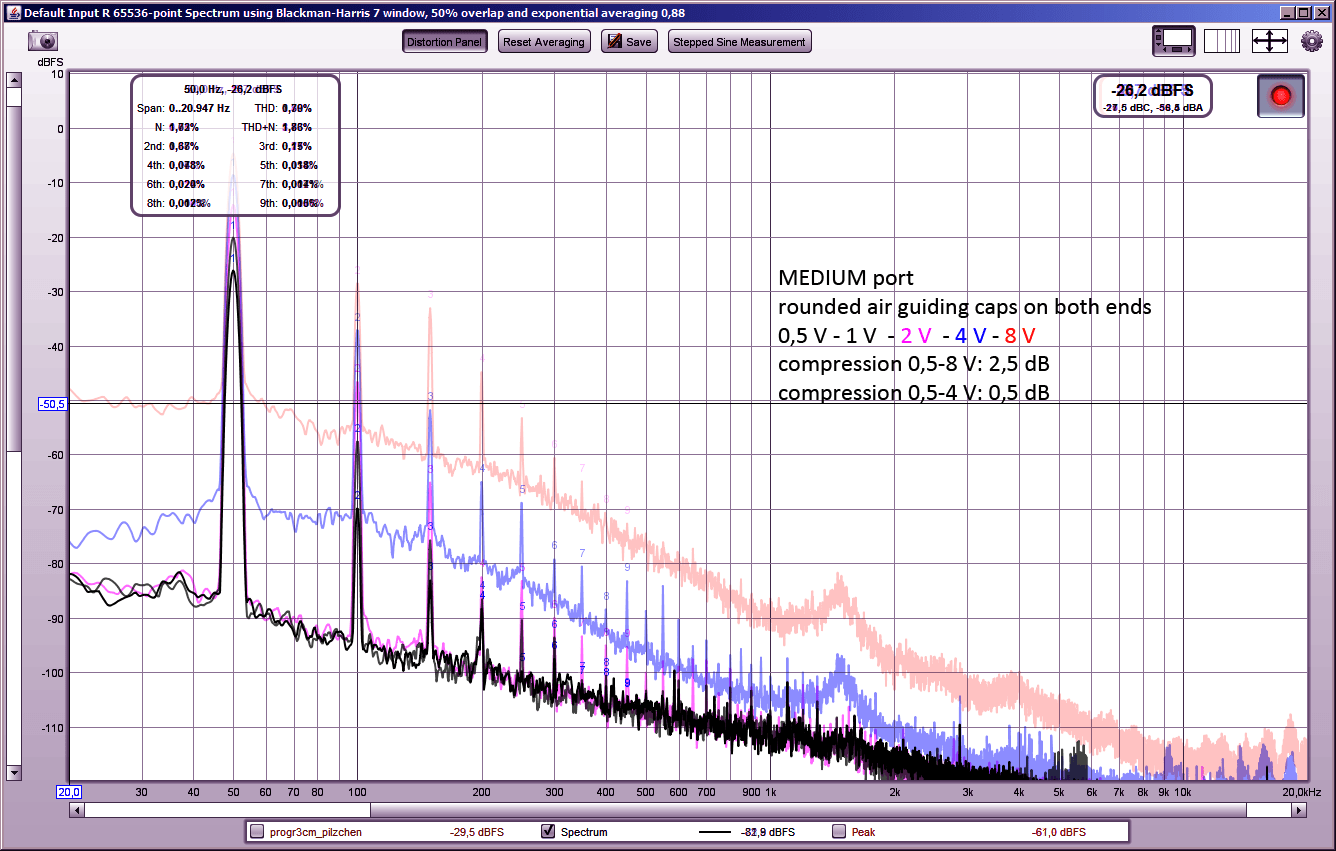

3a) medium port with "caps" on both ends
some resonance chuffing at high levels. I think this is caused by the two facing surfaces at both port ends. slightly less compression.
I will provide H3 distorsion graphs in the next post. H3 reduction is the most obvious benefit of "caps".
however the positive effects of caps are only apparent at very high levels, far above usable for high quality music reproduction.
4) big port
a very small sign of port resonance chuffing at 8 V (port length/diameter ratio is "worse" than small and medium port). a bit more compression than the medium port. however, that relates only to un-musical levels.
as I will explain in my next posts the small, cheap, and spec wise outdated monacor SP60 driver cannot provide sensible output above 3,5 V in the bass range. thus it seems ok to use a port that starts "collapsing" already at 4 V, just for this investigation case.

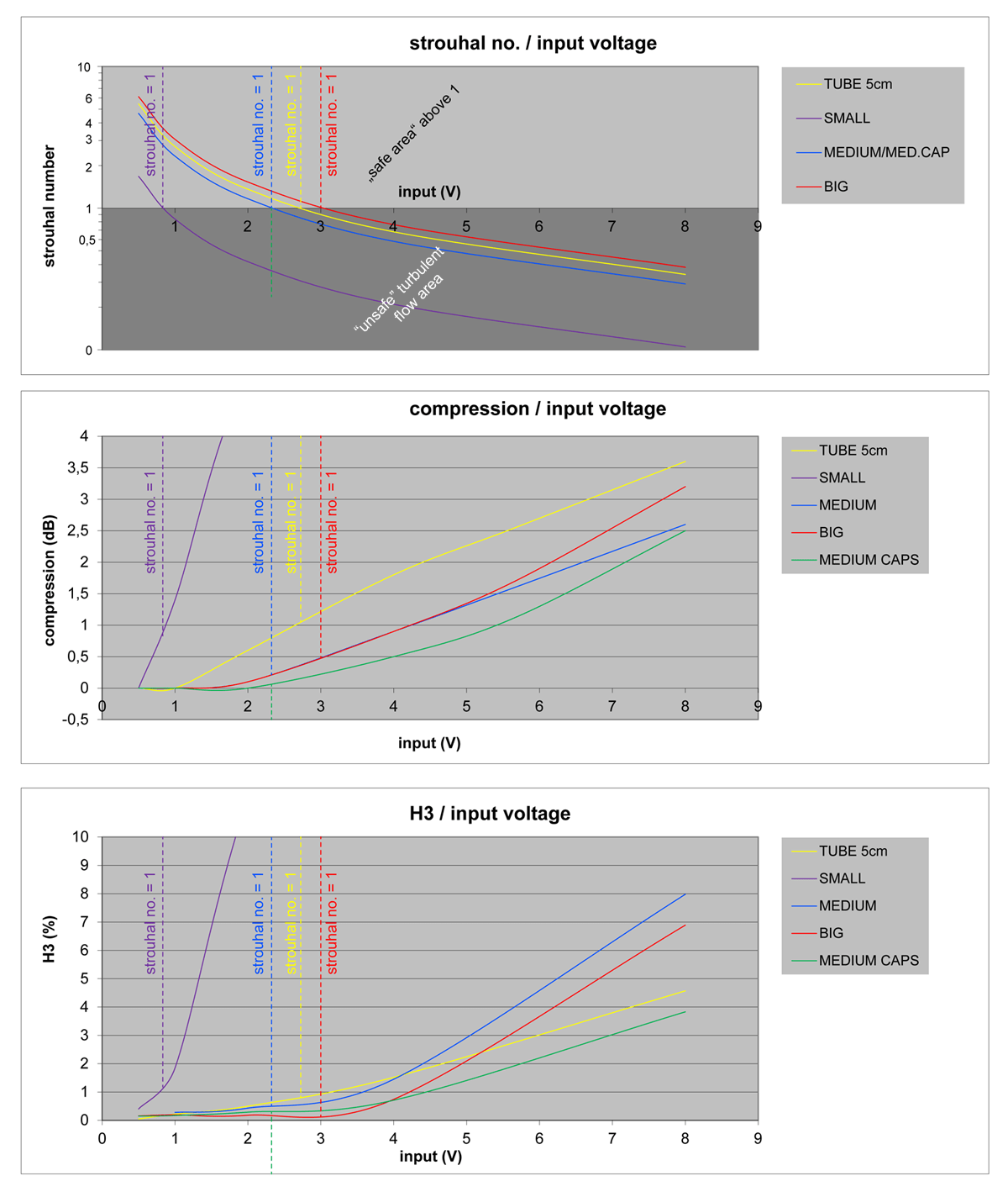

stv
Joined 2005
relating the strouhal number to compression and distorsion​
here is the data collected in the RTA measurements, processed in a more easily readable way.
the most revealing graphs:
  • strouhal number, calculated for the port variants at respective input voltages (referring to port exit radiusses).
  • compression ratio (dB), referred to the lowest input signal
  • 3rd harmonic distorsion
some observations:
  • the graphs don't have many data points (0,5 - 1 - 2 - 4 - 8 V, additional 5,66 V for selected compression graphs). so there is some interpolation going on.
  • tube port, as mentioned earlier (also in the papers), starts compressing early, but there is no sudden "collapsing of output". also H3 increase does not get steeper after strouhal number dropping below 1.
  • 3rd harmonic seems to be particularly revealing regarding the usable output / input range. sensible output range should stay below 1% H3
  • H2 distorsion is not reliable with nearfield measurement - if I'm not mistaken. also H2 will not be musically annoying.
  • the "capped" medium port variant does not have a separate strouhal number. I'm not (yet) sure if and how to calculate a number based on the exit surface...
  • "capped" port seems to behave quite well, but H3 and noise is still better with the "big" port - in the usable range of strouhal number above 1.
  • I chose input voltage as X-axis reference, that's mostly just for convenience.
let me know if you spot any mistakes or unreasonable simplifications!

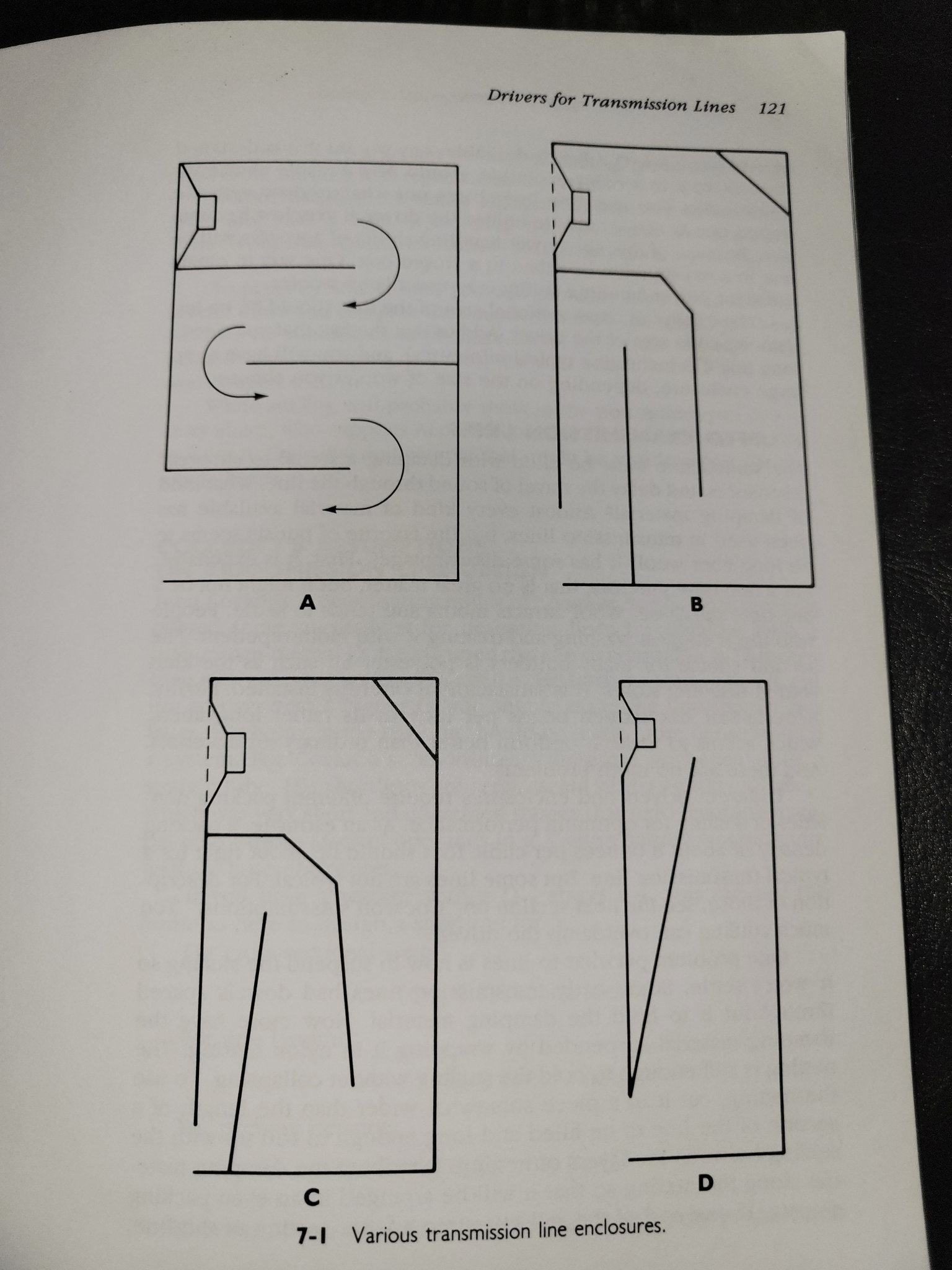

Keep in mind that none of those TL diagrams are mass loaded - which we are discussing here in this thread about ports.
Hope it's ok to ask to keep it that way.
If Vtc is big enough to mount the driver and the other 5 segments were smaller than Atc, then why would that TL not mass load in a stepped scenario?
Example:
Vtc & Atc = 12" H x 12" W x 6" L.
Ap1 & Lp = 6" x 12" x 16".
S1-S2 & L12 = 5.5" x 12" x 16".
S2-S3 & L23 = 5" x 12" × 16".
S3-S4 & L34 = 4.5" x 12" x 16".
S4-S5 & L45 = 4" x 12" x 2".
From what you are saying, there cannot be ANY venting directly behind the driver in order for mass loading to work.
