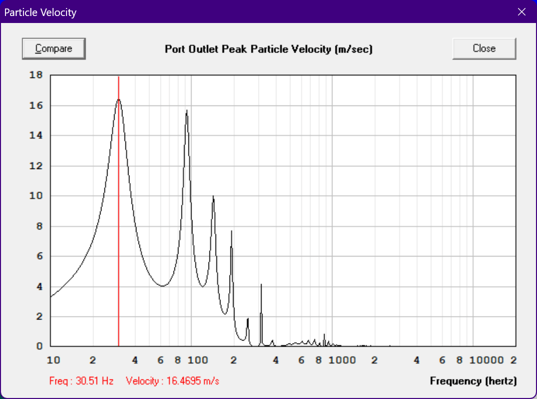

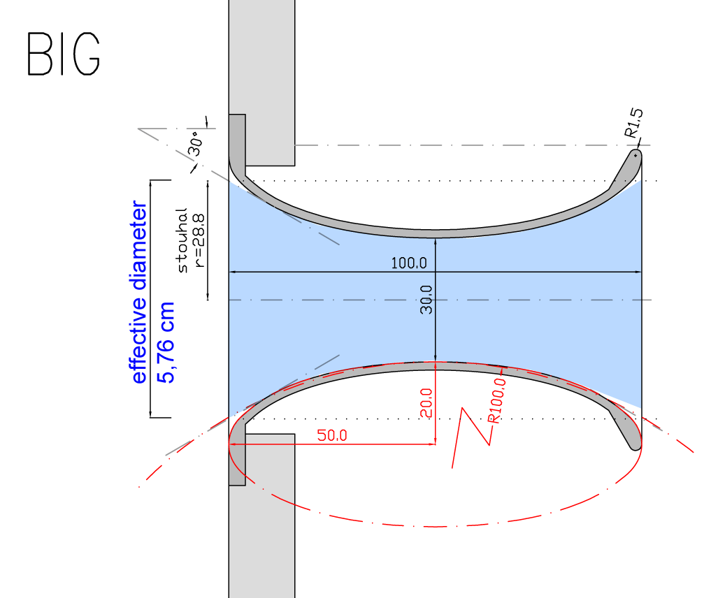

@Tenson
By "port exit diameter" I mean the effective opening diameter from port to the "outside".
have a look at post #526 regarding the "effective opening diameter" or radius, for strouhal number calculation.
The central narrowest part of the port is actually not that relevant - however there is probably a limit of useful air speed and respective air linearity.
As I tried to show and investigate, the crucial part of the ports is EXCLUSIVELY the transition from moving air zone to pressure variation zone and vice versa, thus the intake/exit. this is where all turbulent airflow, flow separation and noise generation happens and this is why we need a minimum cross section for useful ports (actually only for the intake/output).
Using the BIG port (see plan in #529) as measured in the previous messages and the max useful input voltage (see above) here are the corresponding airspeeds and particle displacement distances:
the strouhal number is sligtly less than 1 at port terminations, because I have an effective diameter of 5,76 cm (28,8 mm * 2), but my calculation above actually gave a minimum of 5,95 cm!
the "strouhal number" (not sure whether it can be called so) in the central, narrow part is only 0,13 cm! But it's no problem, because there is no sudden change from directed flow to pressurized "open space".
the profile woul look very similar to the BIG port:
I will post a method for defining the geometry of such a port using:
but I'm still working on that!
effective radius | effective surface | particle velocity (at 3,3 V) | p-p particle displ. (at 3,3 V) | strouhal number | |
port exit/intake (port ends) | 2,88 cm | 26,06 cm² | 5 m/s | 3,18 cm | 0,9 |
central port section | 1,5 cm | 7,07 cm² | 18 m/s | 11,46 cm | 0,13 |
![MP-BIG.png MP-BIG.png](https://www.diyaudio.com/community/data/attachments/1224/1224244-9bd52248de266f1e5e7098981b010e79.jpg)
- exit diameter for keeping strouhal number above 1
- exit flare of 30°
- required port length for resonator tuning

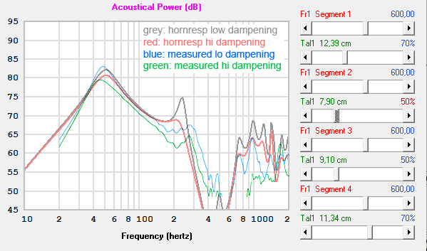

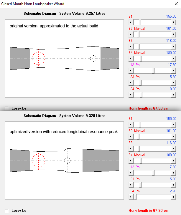

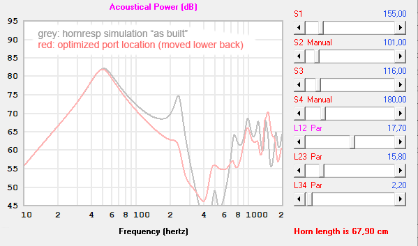

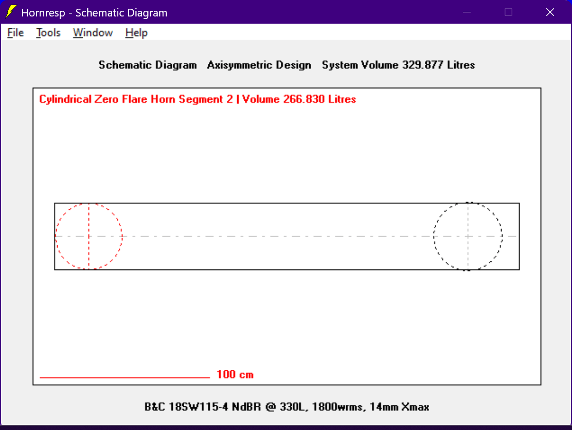

here is a very quick and rough hornresp simulation with measurement overlay of my mass loaded TL test:the TL length resonance at 265 Hz could probably be eliminated or very much reduced by optimizing the line geometry and, more importantly, correctly positioning driver and port along the transmission line.
![240530-MLTL-simu_meas.png 240530-MLTL-simu_meas.png](https://www.diyaudio.com/community/data/attachments/1224/1224330-5439f0c196206fb79b54db382baf5f7d.jpg)
the TL length resonance is higher in reality, but the rest fits quite well.
due to folding of the line the higher resonances are less prominent in the measurement.
I should add that the resonance peak was not steep enough with the standard setting of QL=7.
I set it to 17 in the image above - is this effect of a perfect (low-loss) port?
the steeper low frequency rolloff is caused by the out of phase signal from the driver.
The complete isolation of hornresp's port output cannot easily be replicated in the measurement.
and by just moving the port down by 12 cm (towards the driver) the TL length resonance can be eliminated:
![240530-MLTL-simu_optimized.png 240530-MLTL-simu_optimized.png](https://www.diyaudio.com/community/data/attachments/1224/1224331-3900348b22a8ed50ab7ff8b9baf80aaa.jpg)
I'd have to check this solution in reality, but it seems to be incredibly easy - much too easy not to follow this path.
and the "TL" boards have an additional bracing benefit!

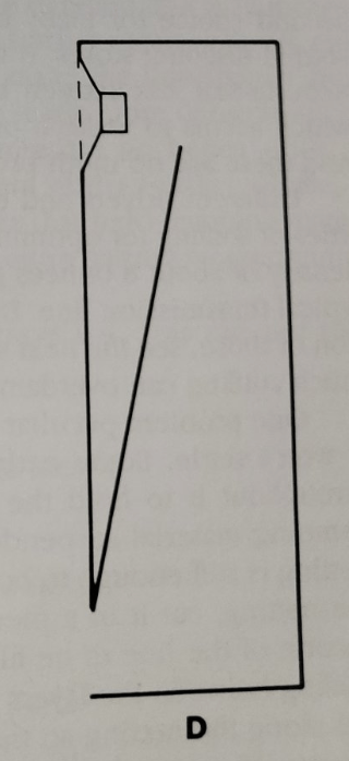

I think I get where you are coming from.
The mouth in pic D needs to be a couple inches off the bottom of the enclosure in order to achieve true mass loading.
MLTL's are a PITA to model. Ap needing to bigger than S1-S4 was throwing me off.
Internally, the enclosure is 108" high x "18.5" wide x 10" deep.
The port is 14" high x 14" wide x 0.75" deep.
Single fold with the above rear firing port = 55.5" high x 20" wide x 22.25" deep externally.
Double fold with the above rear firing port = 28.5" high x 20" wide x 43.75" deep externally.
Trifold (?) with the above above rear firing port = 37.5" high x 20" wide x 33" deep externally.
I see moving the port up 8" changed the upper resonance. It also gained SPL at the expense of port velocity.

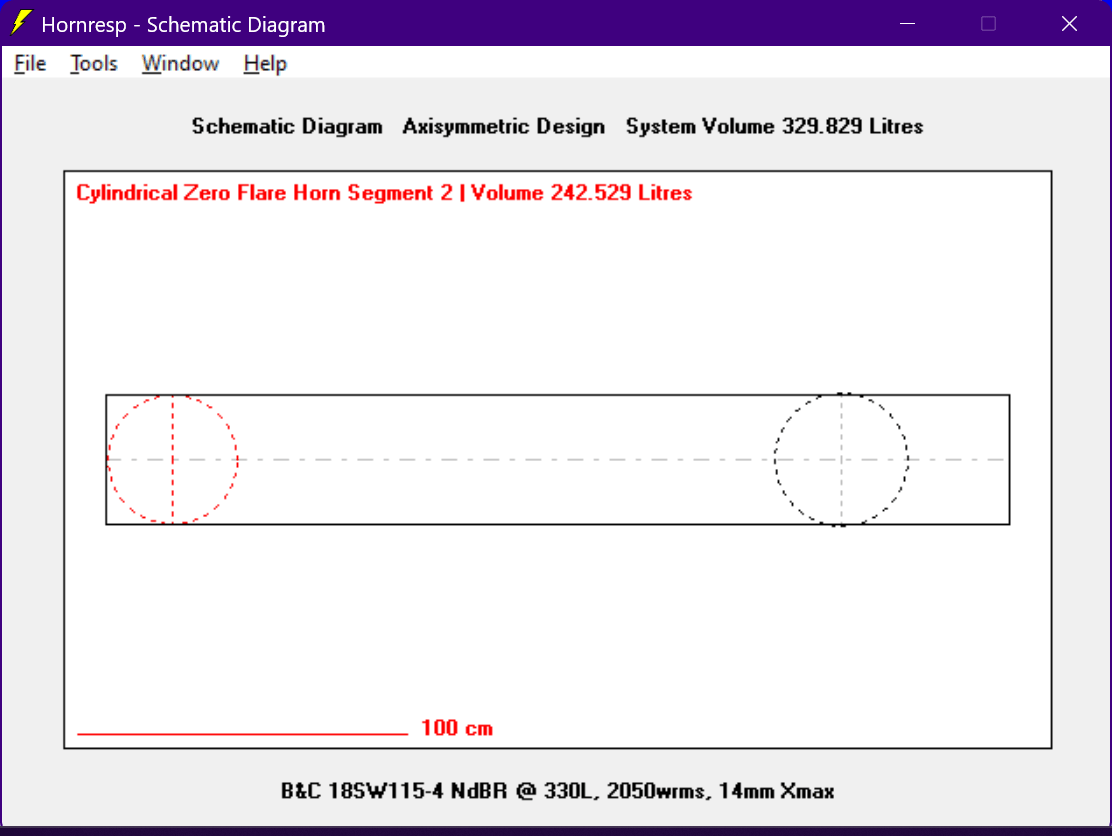

here it is, also the "optimized version"!do you mind showing the hornrsp system schematic?
I tried to follow the "centerline" unfolding technique.
attached also the hornresp record of the original version, just in case.
I should add that there is still a small wiggle in the combined frequency response.
![240531-hornresp_schematic.png 240531-hornresp_schematic.png](https://www.diyaudio.com/community/data/attachments/1224/1224485-34e41dfc7556cfd5b749e67379f0eaee.jpg)
