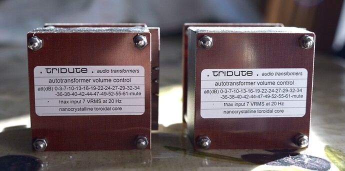

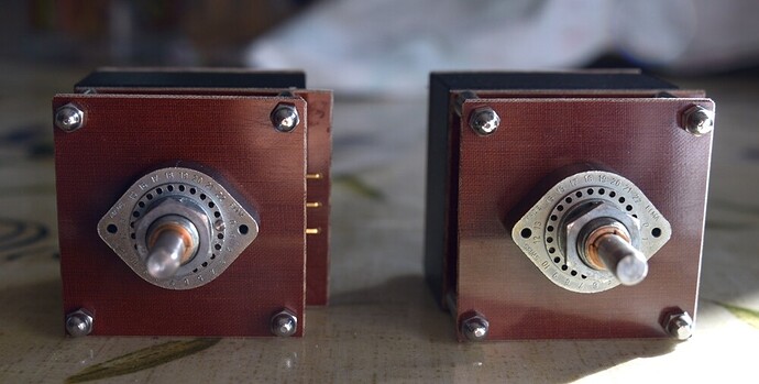

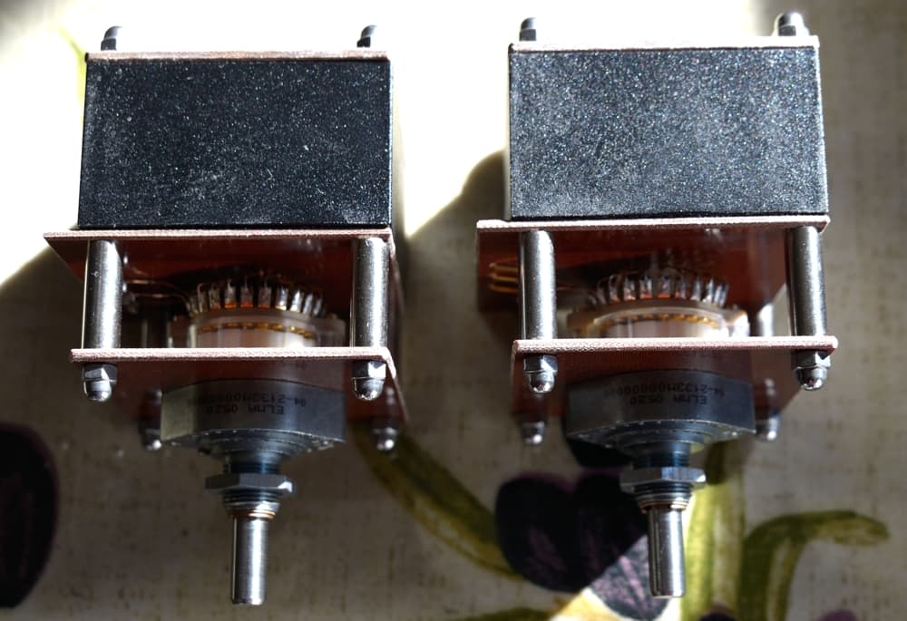

OK, so you have -3, -7 and -10db positions
you need to find those taps physically, same logic applies as
you'll hardly decipher that with ohmmeter, considering that Rdc of winding is low, so you can't differentiate direct contact of switch to resistance of windings - best way is if you have same switch spare so you can measure on it, or simply reading datasheet of switch
there are other ways, all really easy, you can use any sort of signal generator connected to AVC yadayada ....... sole important thing is that you have proper mental image of AVC itself and its function.....
-3db switch contact is one connected to output when switch is in "max-1" position
-6db switch contact is one connected to output when switch is in "max-2" position
-9db switch contact is one connected to output when switch is in "max-3" position
