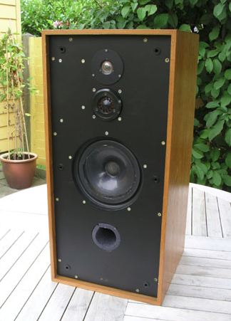

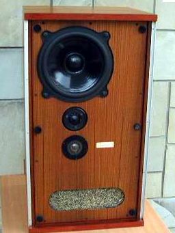

The more I look at Troels Gravesen's SP38/13, the more I like it!
It's in a famous tried and tested tradition of the 13kHz crossover:
Spendor BC1:
Spendor BC1
B&W DM2 v2:
Do you need ears like a bat to hear the improvement? Especially since CD only goes up to about 19kHz, with steep filtering thereafter? Amusingly, there is some evidence your hearing goes up to about 35kHz. But more the hairs on your cheeks and the hairs on the back of your neck that picks it up.
IMO, adding a 3/4" supertweeter just makes everything easier lower down. We can cross the woofer lower, avoiding cone-breakup. We can maintain good dispersion and low distortion above 10kHz where a 1" or 1.5" tweeter struggles.
It's not a bad idea. As ever, time will tell. All speakers are compromise.

Super tweeters were introduced to UK speakers during the 1960s, not so much for fidelity reasons, but more to do with avoiding Purchase Tax. (VAT replaced purchase tax in 1973).
Professional products were not taxed and professional was defined as above 8 inches for a woofer or as a 3 way speaker. The addition of a super tweeter therefore allowed a speaker to be classed as a 3 way and hence avoid purchase tax.
The Spendor BC1 certainly benefitted from purchase tax exemption, but was also a good loudspeaker.
Here's what the designer, Spencer Hughes said:

Theory is all well and good, but really we need good ideas. And a supertweeter is not a bad idea at all.
I remember reading this Steve. However, I can't seem to find any information on the actual audio frequencies produced by '625-line breakthrough'.This addition (of a 4001G super tweeter) was for purchase tax reasons, but it did have two extra gains. Firstly, it improved the overall dispersion characteristics, secondly, from the broadcasting angle, it made any 625-line breakthrough to be more easily detected.
The Coles 4001 unit is available in both 16 ohm (G) and 8 ohm (K) versions from Willys Hifi. Coles 4001G 16 Ohm Super Tweeter - Willys-Hifi Ltd

We must move with the times. This, IMO, is a flippin' good derivative of the ancient Spendor BC1:
SP38/13.
