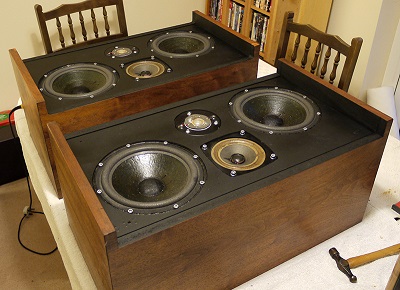

planet10 has me interested in this MarkAudio CHN-50 as a tweeter that can cross low, requiring a small 1L enclosure, but not hard, I think: CHN-50 full range driver | KJF Audio
Supertweeter might be a Spendorish SEAS 22TFF: H1280-06 22TFF
Spoilt for choice on woofers. I've always wanted to try the Vifa PL17WJ polycone:
https://www.falconacoustics.co.uk/drive-units-1/vifa-p17wj0008-woofer.html
Ought to be very good, IMO.

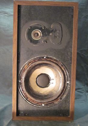

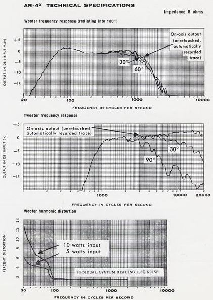

This cone tweeter style, An AR-4 is close to my heart:
But off-axis, it is terrible. But cone tweeters do sound very smooth if rolled off at HF with a coil of, say, 0.3mH. Enter a supertweeter, IMO. It will be in its comfort zone around 10kHZ crossover, for sure.
