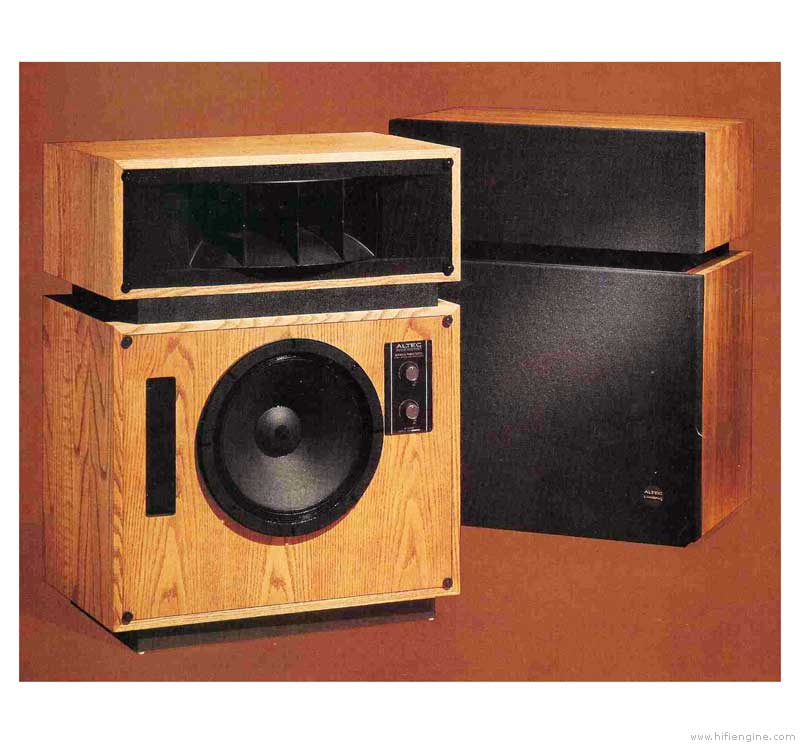

Altec Lansing 19 - Manual - Studio Monitor Loudspeaker System - HiFi Engine
This is another creature from the same manufacturer, I heard many comments that they lacked "deep bass" .....
I have heard these Altec 19 several decades ago, spectacular sound, but look at the specs .... 30 to 20,000 hertz without specifying how many Db +/-
Of course I would have liked to be able to buy them during those times. They sounded splendid.
But the concept of "high fidelity" from 20 hz to 20 khz was already a "standart" universally accepted.
So again, is a subwoofer necessary for music? , it depends on what music you listen to, in my case it is.
But we are talking about supertweeters here, sorry for OT
