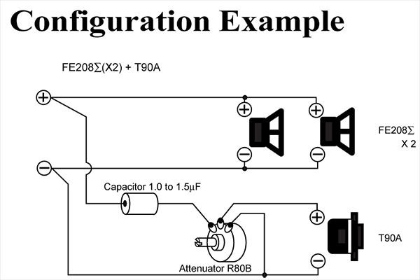

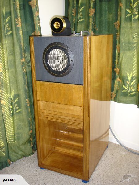

In an extended range speaker a supertweeter that reaches quite low can be a good complement with only a good quality step capacitor without any other component, being finally a simple two-way cabinet.
An example of this is the Fostex horn FE206 with a bullet tweeter, which spoils all the theory of lovers of the single speaker without frequency dividers, to maintain the "absolute purity" of the sound ... (according to them).
Finally, they end up accepting the harsh reality, there are no highs treble !

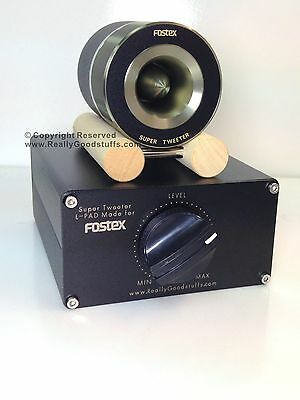

And if the T90a brings back memories of Motorola's first piezoelectric devices, you can add this gadget (L-Pad?) , Before they were called treble control and were a variable wire resistor, I guess this will be an evolution .....

I was referring to the fact that I would not call a simple condenser and an attenuator "network" in the case of the Fostex T90A, which is NOT a piezo.

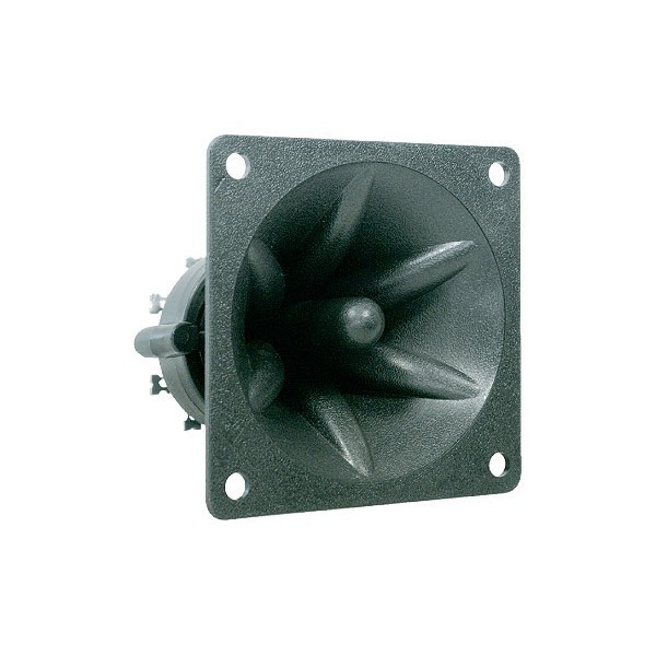

I bet that many of the piezoelectric tweeters (here they copied the Motorola to the tiredness with the Leea brand) used by amateur builders are poorly filtered as I read in your attached article.

Here Audinac used the tweeter piezoeléctrico Lesson, and the DJ guys diyer´s the Leea that as you can see is identical to a Motorola. ( pic of the right )

Supposedly they are ok used with a crossover
Well observed, in this link we can read:
" This post deserves to be read at least by each of the forum participants who do not decide to place piezo tweeters for not knowing how to mitigate or protect them or whatever.
For me it is very well indicated each of the factors to take into account for the use of piezos and I hope that those who do not use them and do not know them, try them, are very cheap and will see that the results are not so bad. "
Como ajustar la respuesta de un tweeter piezo-electrico | Foros de Electronica
So I have to admit that I was a little hard on my judgment about these tweeters, but it's too late to back down, I always argued that they were "crap", but on second thought, the treble of Audinac cabinets didn't sound so bad, and if the Leea, they would be badly crossed ......
