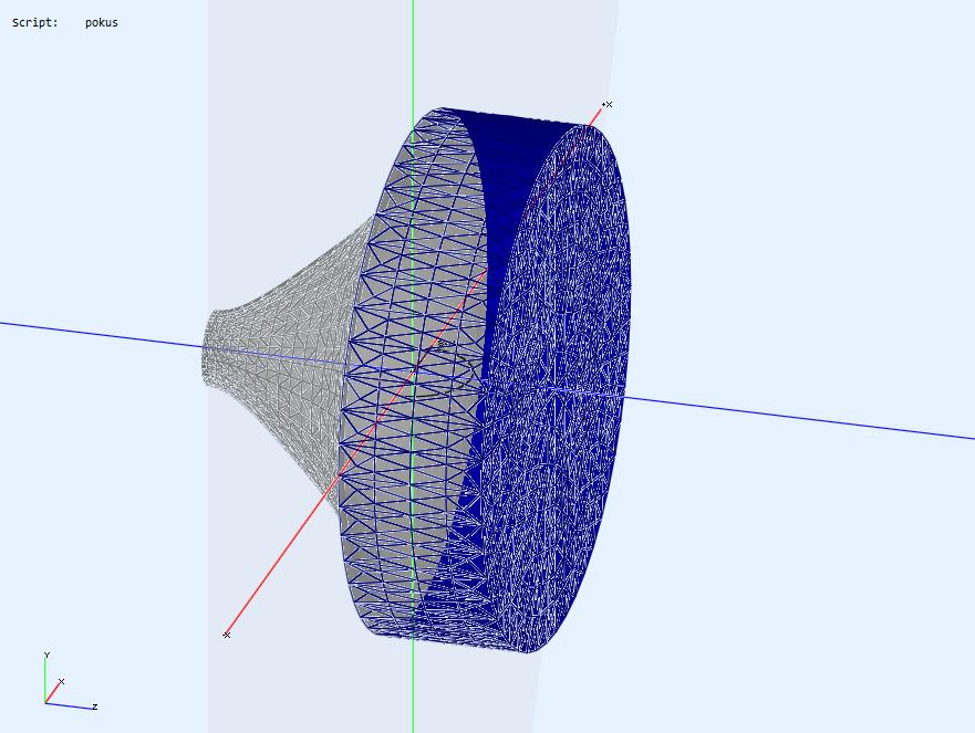

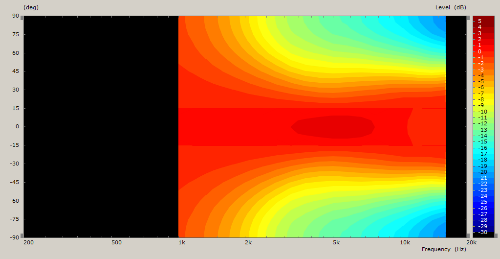

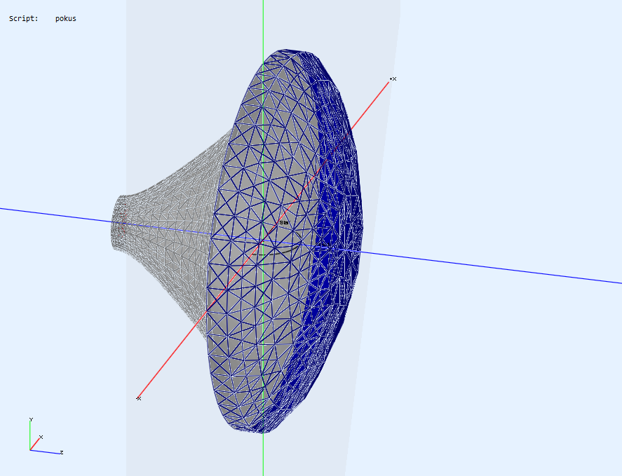

These aberrations?
I'll leave it at that, because I won't take credit for Marcel's (huge amount of) work.
The point of these ABEC sims was to illustrate that 'bigger is better'.
Yes, the axial issues are better represented in those pics. What's the difference?
Do you have any ideas to help me produce a better final product?

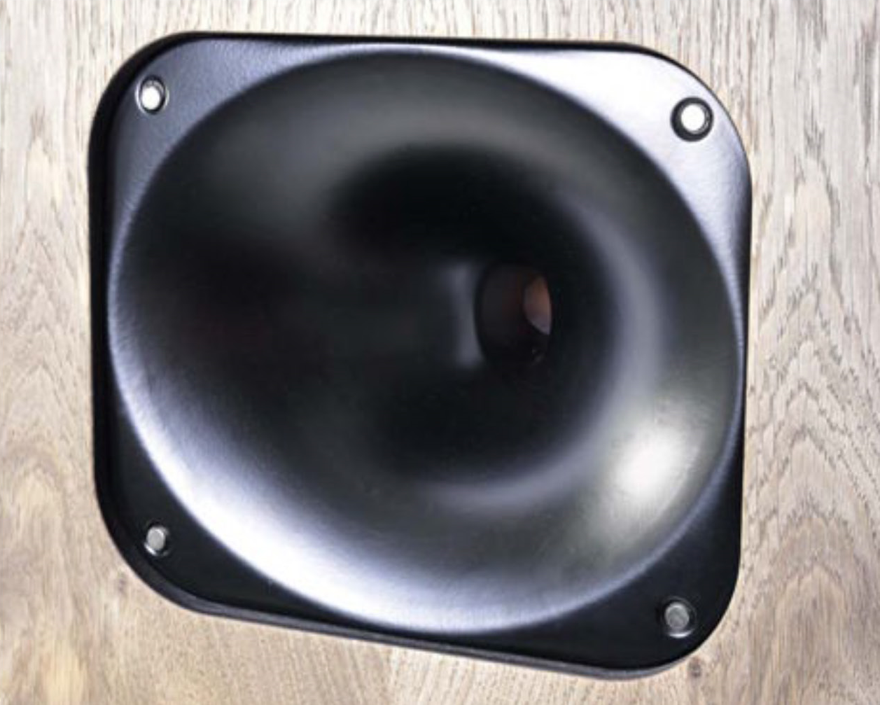

So, they have designed a 50°x 60° horn... only to break the symmetry ?
Probably to narrow the beam (further) to increase output and reduce phase and other interference issues.
This horn was designed in order to cover the vocal range in stacked setups with BMS 4590 or 4592 coaxial.
Size, the latter wg's mouth diameter is about 1/3 of the former.
I believe Marcel largely eliminated the abberations by placing a spherical cap in front of the wg in later sims.
Evidently this isn't correct, because the vertical coverage angle was increased by 10 degrees.

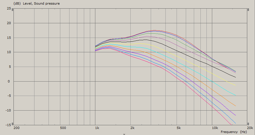

Then I can agree with what you showed. I did not get the scale of the thing, but from what I saw this waveguide was 20" across. My NSW-15 is 18 and while the aberrations have diminished greatly, they have not disappeared. To do so at only 20" seems very surprising to me.
But your point is correct. As the mouth widens, the aberrations move lower in frequency. Hence at some size they will lie below the passband. Is that 20"? I don't know.
What do you mean by a spherical cap? The ideal is a flat piston.

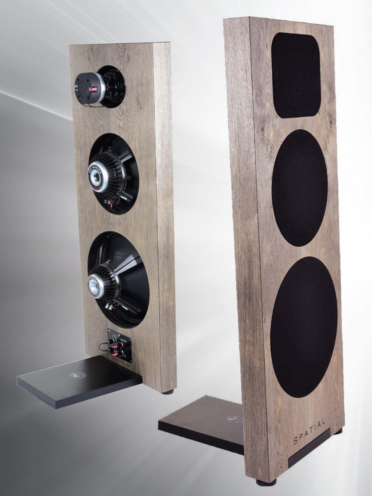

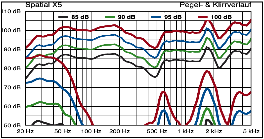

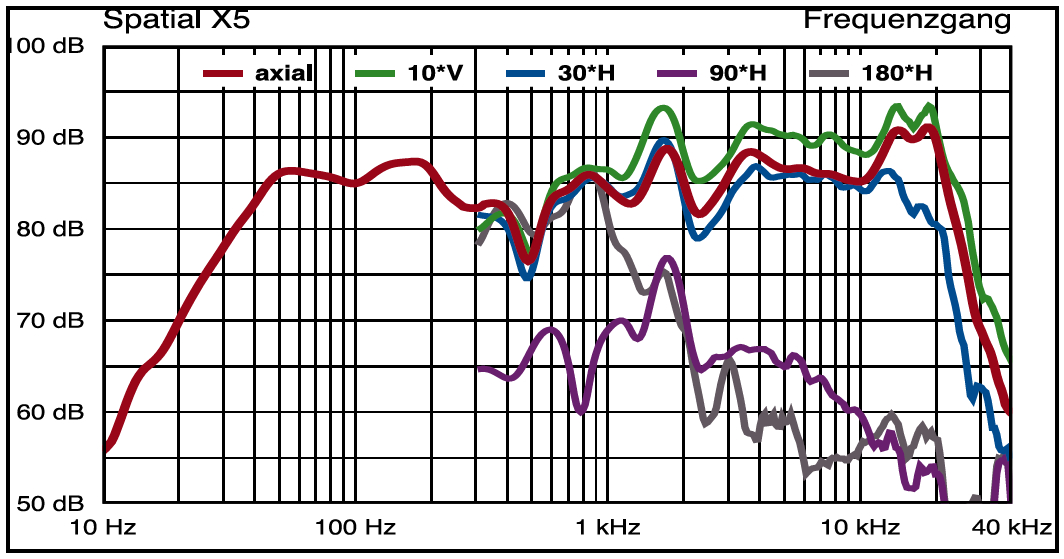

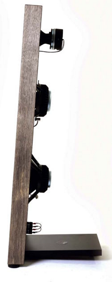

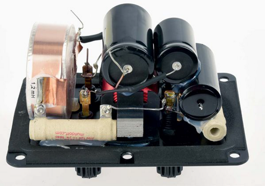

In the current issue of a magazine there is a test of a new Spatial Audio dipole speaker (No 5) using the HF10AK (it does at least look that way) on an XT1086. Unfortunately I couldn't find that model on the web though. It doesn't measure that nicely in this test but I assume this is due to a simplistic crossover. When I did some casual measurements of that driver/horn combination it looked much better.
The comp. driver appears to be the HF10AK, not only as regards the exterior of the driver, the response also shows the 'valley' between 1800 and 3500Hz.
12 and 15" are obviously Eminence Deltalites.
Overall the plots look rather miserable, but this may as well be contributed to the crossover, as you indicated.
Although the magazine acknowledges the mediocre measurement results, it apparently doesn't tamper the enthusiasm of the test panel.
FWIW: The Spatial X5 receives 63 out of 70 points for soundquality and 84 out of 100 overall.
I am not sure, but I think Marcel somehow anticipated the disappearence of the aberrations with a sufficiently large mouth size and roundover.
The sims were posted in his local forum, so I have to rely on google translate for the interpretations of the comments.
This is the translated comment he posted along with the sims of the 52cm OSWG:
"Even with pure OSWG, excellent results can be achieved. As it is obvious from all this, the key is a sufficiently smooth outlet. Specifically, this is already 52 cm in diameter. Then even the circular symmetry will not have any negative effect (at least not visibly from these graphs).
Ie. if you do any horn, the bigger will always be better, and certainly not spare on a smooth outlet."
Outlet translates into "mouth roundover" I would think.
And later:
"The 52 cm was just a random number, of course related to how low it keeps the beam."
This is what he did (in ABEC) concering the 18cm OSWG, in order of appearance from left to right:
- flat 'cap'
- spherical cap
- SPL with spherical cap
- polar map with spherical cap.
