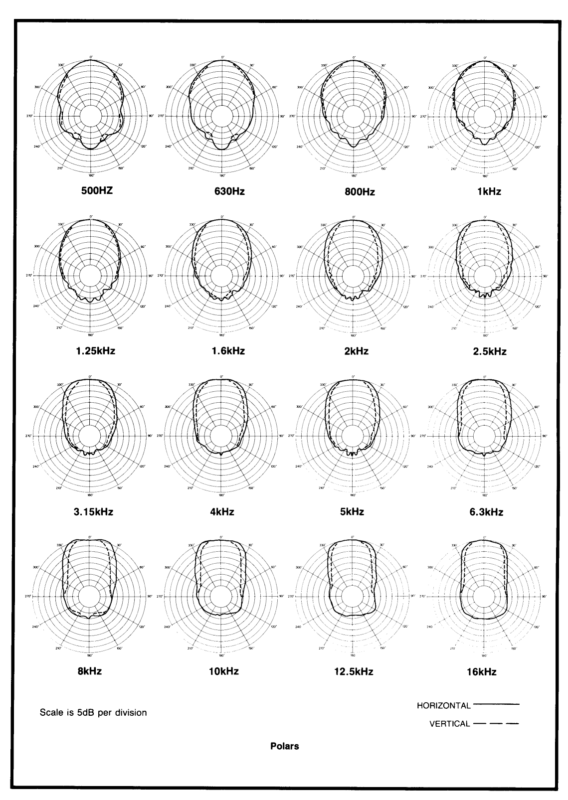

One related question to the experts: how is the function of the diffraction slot influenced by making the horn longer with the adapter?
This kinda sheds some light but doesn't suggest yes or no about the lobing. Lobing on the vertical plane might not be a concern for some, and lobing on the horizontal plane is always more of an issue....
Lobing exists, you don't want it, then drivers need to be < 1/3 WL of the highest frequency to be reproduced for us not to hear it in our acute hearing BW.
Your eyes, ears are horizontally opposed, so vertically oriented sights, sounds have a narrow focus, hence not a lot of spacial information to work with; horizontally though, 'smearing' due to lobing, comb filtering is an increasing problem above the ~800 Hz head transfer function [HTRF].
Anyway, this is [one of] Dr. Geddes's fields of endeavor, so looking forward to any thoughts/corrections/whatever.
