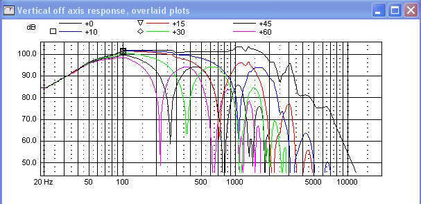

I have never used two woofers so I don;t have a lot of experience. Multiple sources over the same frequency range will always create problems that we don't want so its best not to do that unless it is absolutely necessary, and I have not found this to be the case.Gedlee, I just meant that, one of the drivers will be farthest away from being on axis....deciding which & how to locate the drivers. With TMM, the bottom woofer would likely be that driver. I can angle the horns. I am pondering how dramatic of an angle would still be acceptable given the 630hz xover and 15" woofer size....this is pertinent because of the desired near field listening position. Though not optimal, I must make the best of it.... Using a stand or floor standing, to put the 15"s closer to ear level raises the height of the horn.... I don't know how I'd like the tops to be coming from "above" so if I put the top of the top woofer at ~47" (basically ear level) that puts the center of the Horn 11.5 inches above and the center of the 15", ~8" below....and the center of the bottom 15" ~24" below that....I'll have to go back and read on our last discussion that lead me to feel comfortable with TMM.......If I did the upside down V shaped MTM with the woofers placed horizontal, from my reading, comb filtering will occur.....Read that as "will occur?" Looking for some confirmation I guess...I think someone already suggested that what I believe to be true on the matter, so......so, TMM it is I guess. I've seen upside down V shaped MTM with side by side woofers....Did no one tell them about the comb filtering?

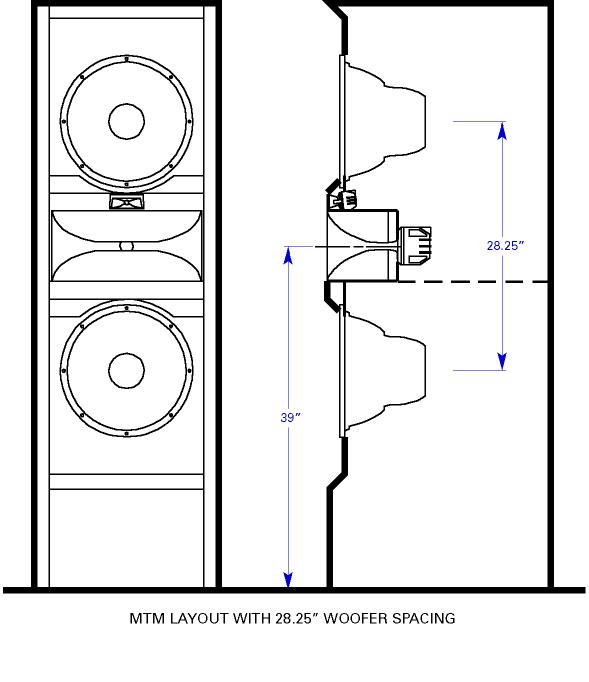

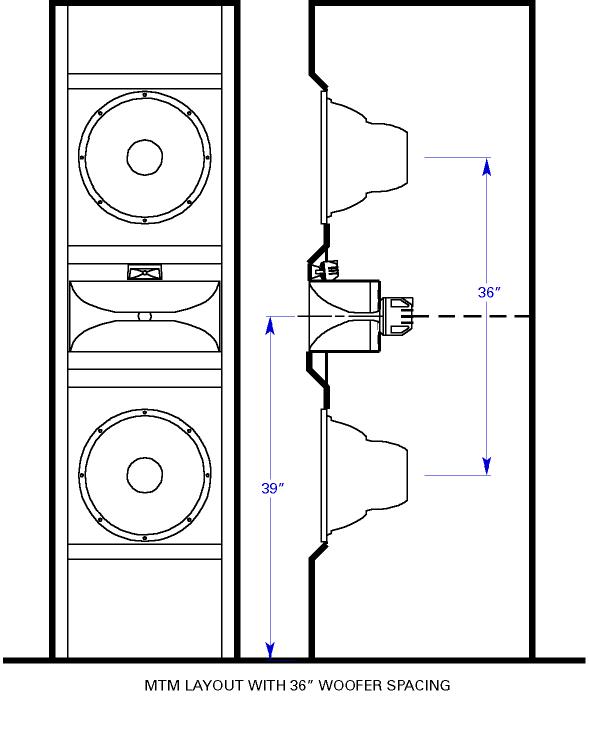

At 10.5 ft3, floor standing is the only practical option to try and eat up some of the volume
H47" W25" D22"
Panel thickness 1"
Actually this is a perfect opportunity to clear up the idea of the formula for KA....I've basically adopted the formula from your paper on directivity, Gedlee, while others have accepted the approach of dividing speed of sound by diameter to discern a KA=2....what do you think of this?
Vertical spacing would be preferred however as it is the horizontal directivity that is so critical, not the vertical.
KA is impy defined as twoPI*frequency * radius / c - anything else is not correct.

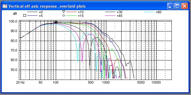

"Don't confuse comb filtering with lobed response. Comb filtering occurs on the horizontal plane only when drivers are horizontally placed. Don't do that and there's no problem. Lobed response can be a problem with vertically aligned drivers at too close a listening position, but at usual distances wavefront integration is complete. Even Joe D'Appolito doesn't worry about keeping CTC to a wavelength anymore, and he should know.
I do question the MMTMM idea. The T might not keep up with all those Ms."
-billfitzmaurice
Both comb filtering and directivity stem from phase differences in sound path, so they are similar phenomena, but yet the two terms imply different things. Comb filtering usually applies to room reflections and not free field issues. Directivity is a free-field issue that does not depend on room reflections, although one can certainly argue thet they result in the same thing in the same situations.

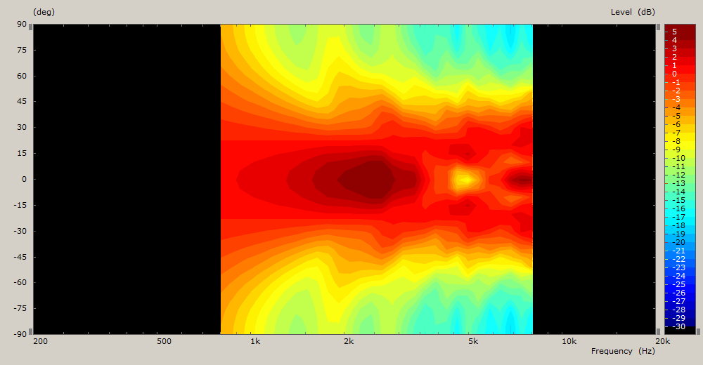

I am not sure, but I think Marcel somehow anticipated the disappearence of the aberrations with a sufficiently large mouth size and roundover.
The sims were posted in his local forum, so I have to rely on google translate for the interpretations of the comments.

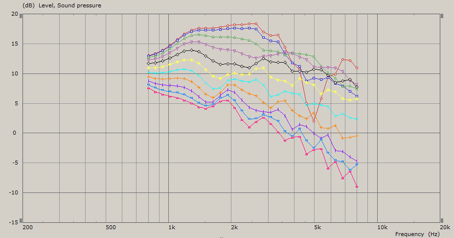

This is the translated comment he posted along with the sims of the 52cm OSWG:
"Even with pure OSWG, excellent results can be achieved. As it is obvious from all this, the key is a sufficiently smooth outlet. Specifically, this is already 52 cm in diameter. Then even the circular symmetry will not have any negative effect (at least not visibly from these graphs).
Ie. if you do any horn, the bigger will always be better, and certainly not spare on a smooth outlet."
Outlet translates into "mouth roundover" I would think.
And later:
"The 52 cm was just a random number, of course related to how low it keeps the beam."
This is what he did (in ABEC) concering the 18cm OSWG, in order of appearance from left to right:
- flat 'cap'
- spherical cap
- SPL with spherical cap
- polar map with spherical cap.

I somehow missed this whole conversation. It's the size and the smooth roundover. I use Euler spiral (clothoid) for the termination, typically from about a half of the depth of the horn outward - it turned out as a really convenient shape for this. Now I have so plenty of such results that I almost could make a proper study for the "axial issues" (as I'm quite busy these days I hoped someone else might do it since I released the tool but that seems not going to happen).Yes, the axial issues are better represented in those pics. What's the difference?
Originally I started to develop on non-axisymmetric designs but when I fiddled with different roundovers and horn sizes I quickly realised that I can still make quite perfect axi-symmetric waveguides. So now I'm kind of returning back to those as I still see some points in the axial symmetry in general and I believe it is a good thing, especially when got rid of these axial issues. It can be done!

To me it was the first step, just to see the basic trends. Any ideas how to make the sims more realistic would be highly appreciated. I'm really not an expert in this - I can't even pretend. I just use what is readily available (ABEC) the best way I can...Uniform velocity is a simplifying assumption that is not entirely correct.
Oh, maybe I misunderstood. As a source velocity I meant the wavefront at the throat. From that on the BEM simulation takes over. I make no other assumptions about the velocities anywhere else.Uniform velocity is a simplifying assumption that is not entirely correct. I have measured standing waves across a waveguide mouth resulting from the edge diffraction. This will not have a uniform velocity contour.
What you saw earlier (a cylinder or a cap) "in front" of the WG is just a way how ABEC organizes the calculations. It called "interface" and its actual shape shouldn't really matter much.
To me that looks quite like my largest waveguide. I would certainly not say that it is any better, or worse.

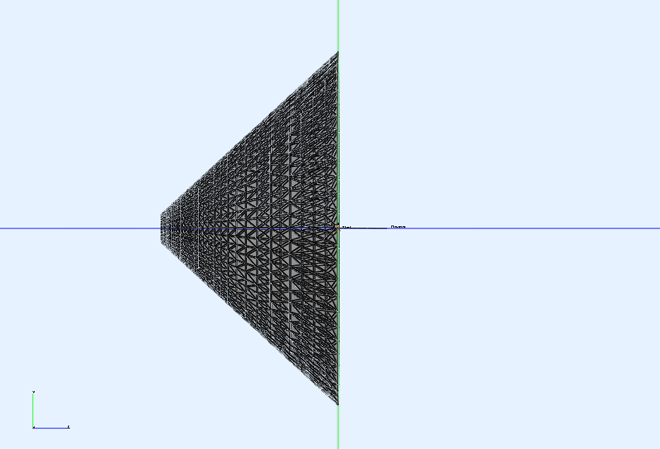

For anyone's interest, this is how it looks like for a straight cone in a infinite baffle (as all the sims I made so far are for IB) -
Ro808: I make no assumptions about the velocity at the mouth - that is really calculated and I would guess it will be quite right. I only assume a flat wavefront at the throat.

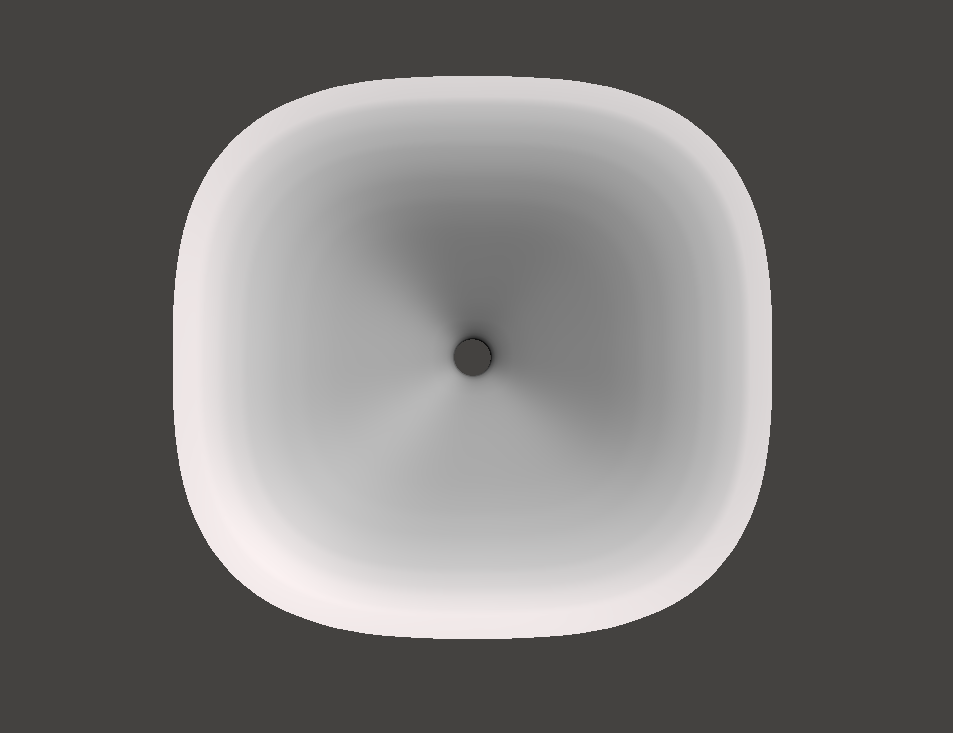

I'm glad you say that because this horn is only 374 x 351 x 130 mm.To me that looks quite like my largest waveguide. I would certainly not say that it is any better, or worse.
Attached is the STL file. It's basically an OSWG with a bit of induced non-axisymmetry.
