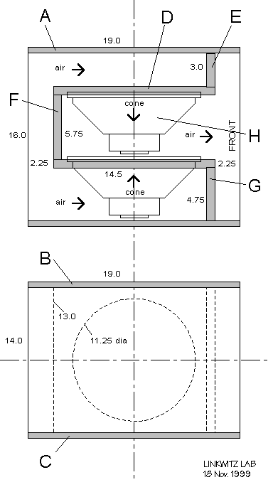

I'm using an arrangement similar to SLs. Drivers are 13" SS Revelators, four drivers in two boxes almost touching the back of the couch. These are crossed at 80Hz to dipole L&R mains. Very little eq is needed to flatten response to 20Hz. One most interesting feature is the complete lack of bass bleeding into adjacent spaces. This will be used to great advantage when I downsize into an apartment in a few years.

Whats the formula for this type of enclosure? Since The waves of sub bass are so large a di-pole/open baffle sub is comparable to sealed/ported correct?
How can I predict potential spl levels for this type of appliocation?
Lots of great info on the late SL's site. Nearfield the low frequency loss is much less than at a distance.Whats the formula for this type of enclosure? Since The waves of sub bass are so large a di-pole/open baffle sub is comparable to sealed/ported correct?
