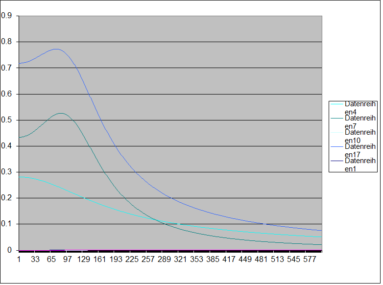

I "abused" my group delay EQ spreadsheet in order to show the difference in group delay behaviour between my crossover and a LR4 crossover both at the same x-over frequency (at data point 138 on the x-axis). The frequency scale is only relative (and linear) but it is still interesting IMHO. The blue trace has no meaning in this comparison. The cyan one is my crossover and the green one is the LR4. The slopes of my crossover are less steep however with 2nd order lowpass and 3rd order highpass. But a 2nd order LR2 for instance would not be an alternative due to the even less steep slopes and the needed signal inversion of one of the filter branches.
Regards
Charles
Edit: Forgot to Mention: The Y axis is also only relative of course. For the Xover frequency of 650 Hz that I use the max GD of my topology is 450us at 0 Hz and for the LR4 it is 690us at 0 hz.
Regards
Charles
