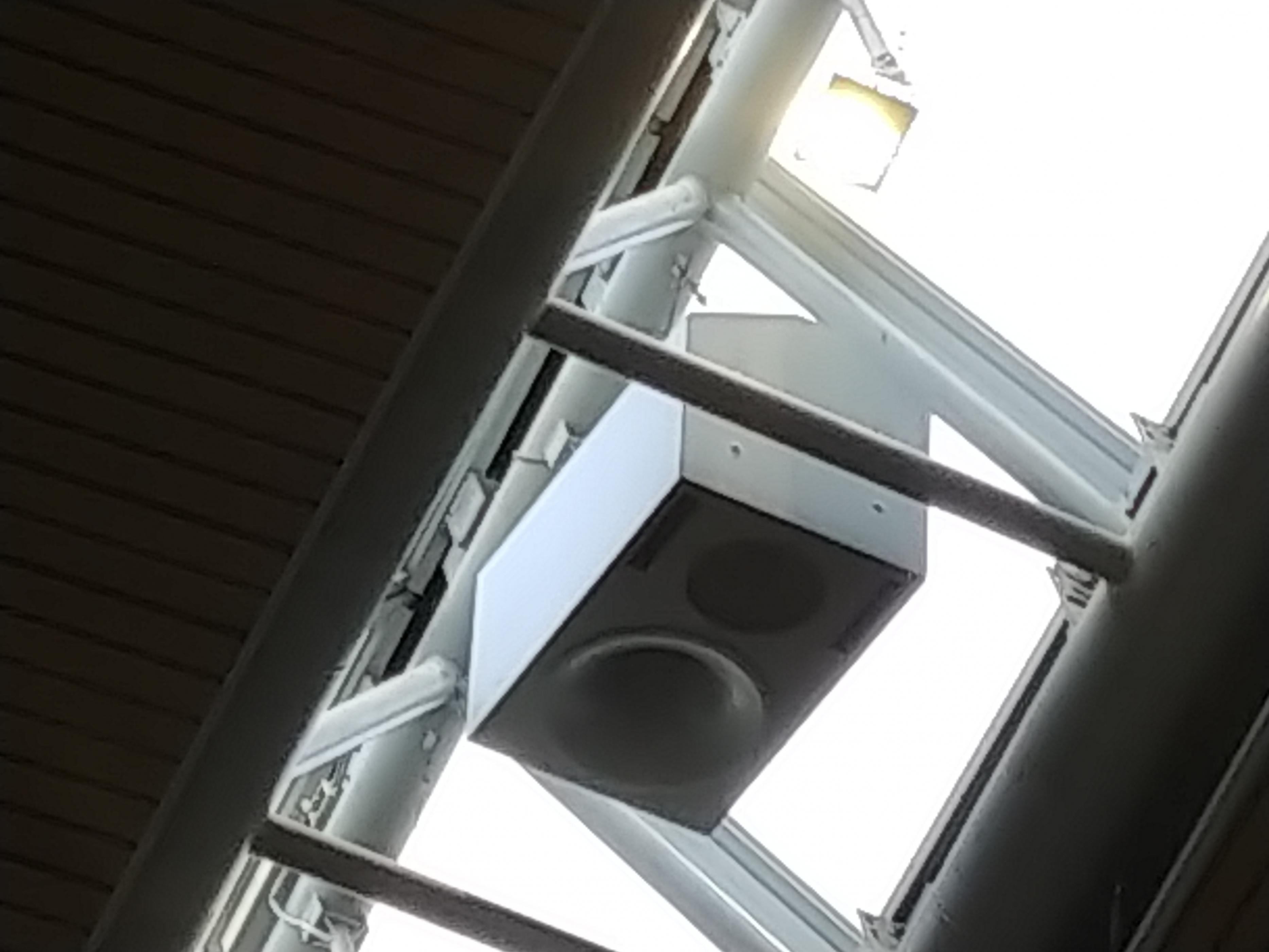

Wow, what a beast.
Yup. They caught my eye. It might be interesting to find out who did the audio install of the KLIA departure hall. They have hung dozens of these monsters from the roof.

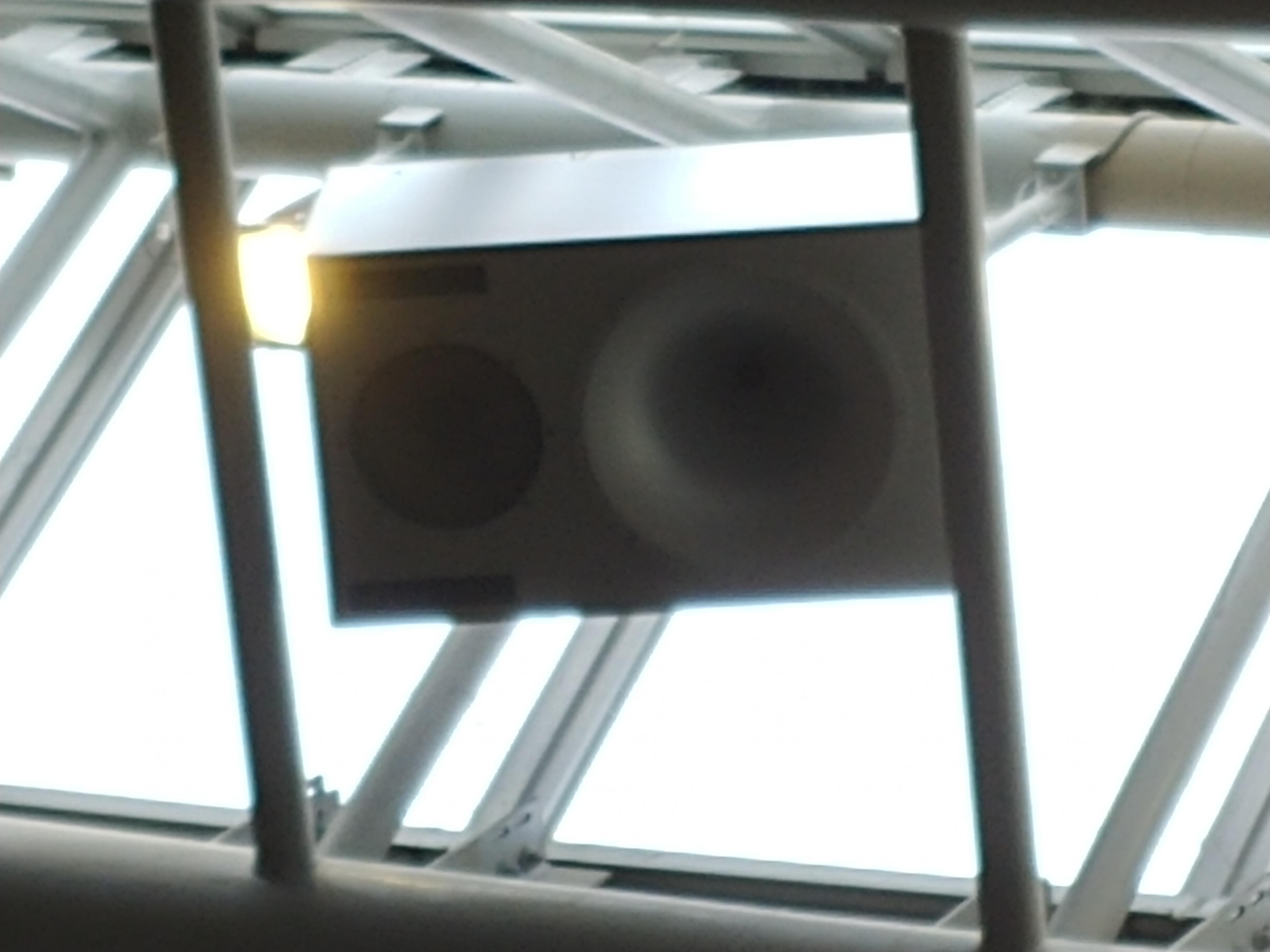

I'm currently at KLIA airport and spotted these. Bass driver is 15-18", the horn is quite a bit bigger. Anyone know what they are?
Looks like Tannoy VQ or Yorkville Unity, except for the ports

Horn seems bigger and more roundovered than VQ or U.Looks like Tannoy VQ or Yorkville Unity,
