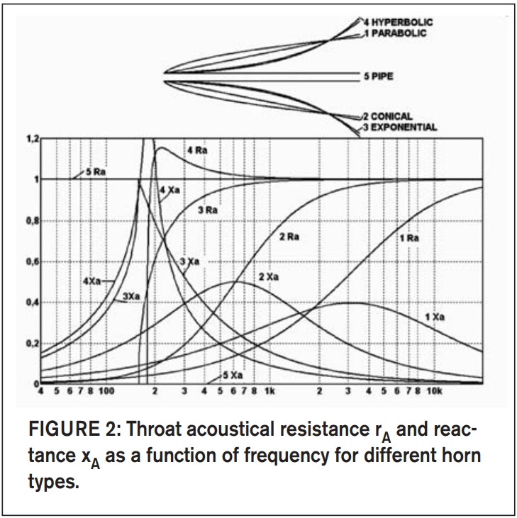

What's the use of a parabolic mid/high horn at home?
I know of no useful applications as a waveguide. A parabolic reflector sure, but that was not was presented. A parabolic waveguide would be a disaster from a directivity point of view.

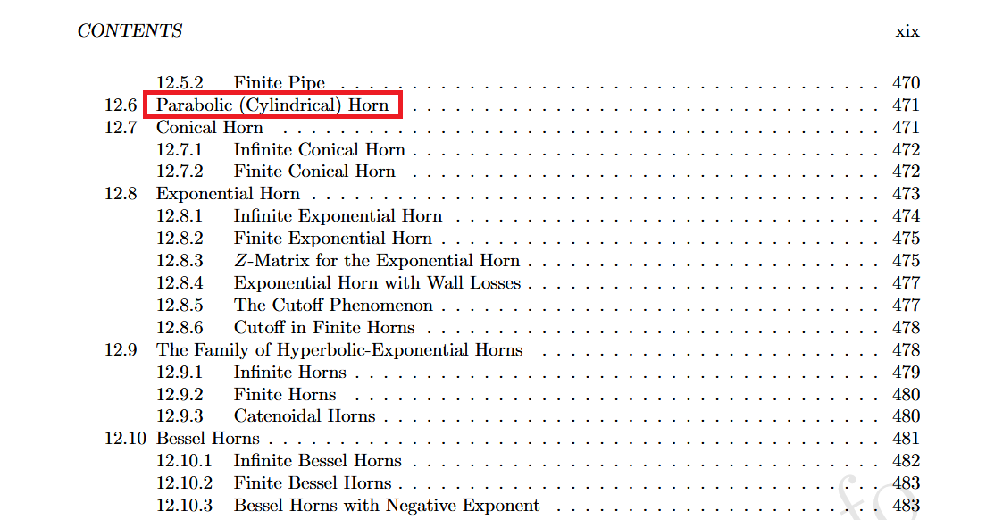

The parabolic horn is also sometimes called a cylindrical horn in the literature.

I was prompted to comment because I found it interesting that people were debating whether or not the axisymmetric horn profile tended towards a cylinder as the length increased, when it just so happens, coincidentally, that a parabolic horn is actually also known as a cylindrical horn (but not for that reason).

All of them. It is a truly astonishing piece of work. Well worth buying a copy.
I went back a couple of pages but I cant find which book you guys are talking about (the content screenshot). ?!?!
thanks
EDIT: answer is here! Home
