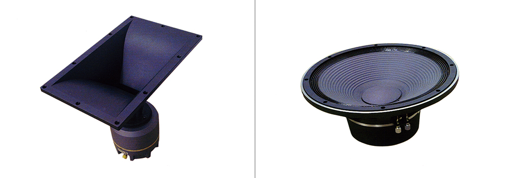

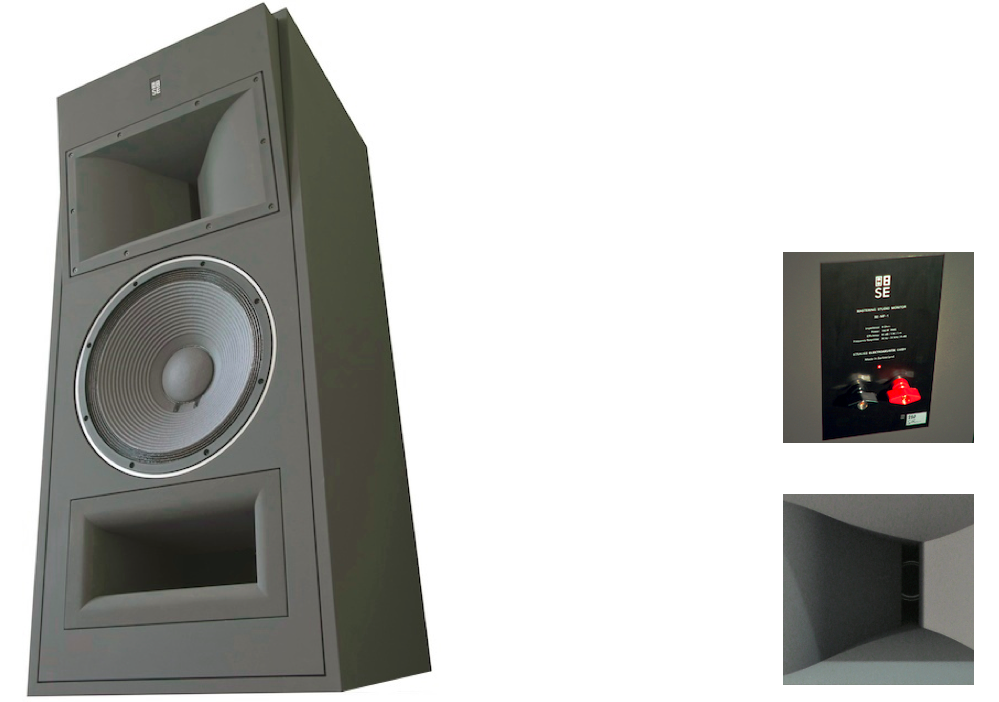

Hi Ro808. As you seem to know everything about (horn-)speaker, I wonder if you can tell me a few details about Strauss SE-MF-2, which is a reference monitor and wouldnt be wrong at all in this thread. A few Pros claim this to be "best monitor they ever heard", "best transient", etc. I have heard the Strauss in Berlin and I was surprised, so to speak, how great the difference between the recordings were with this speaker, sometimes dull and sometimes bright, by no means allways nice. As far as I know, the woofer is a TAD 1601, and I thought the CD would be ND2060A or 2080A from 18sound, modified, of course, but I´m not so sure anymore. By the way, great thread, made a lot of fun reading it!🙂
That horn is jbl 2382a I believe. I like the monitor, the looks of it, but the horn uses a diffraction slot, which I wanted to avoid, other wise, I really like the horn. This and the 2384 are some of the best jbl horns. The "truthfullness" you describe is a trait, that is akin to horns and compression drivers in general, its why I have chosen to use a cd/horn combo in my design. I personally think the lack of signal compression, as ascribed to horn loaded drivers, is responsible for this trait and with that being said, don't limit yourself.

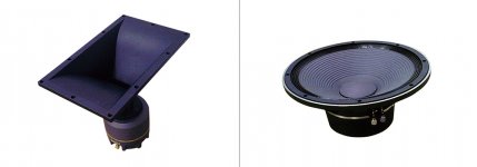

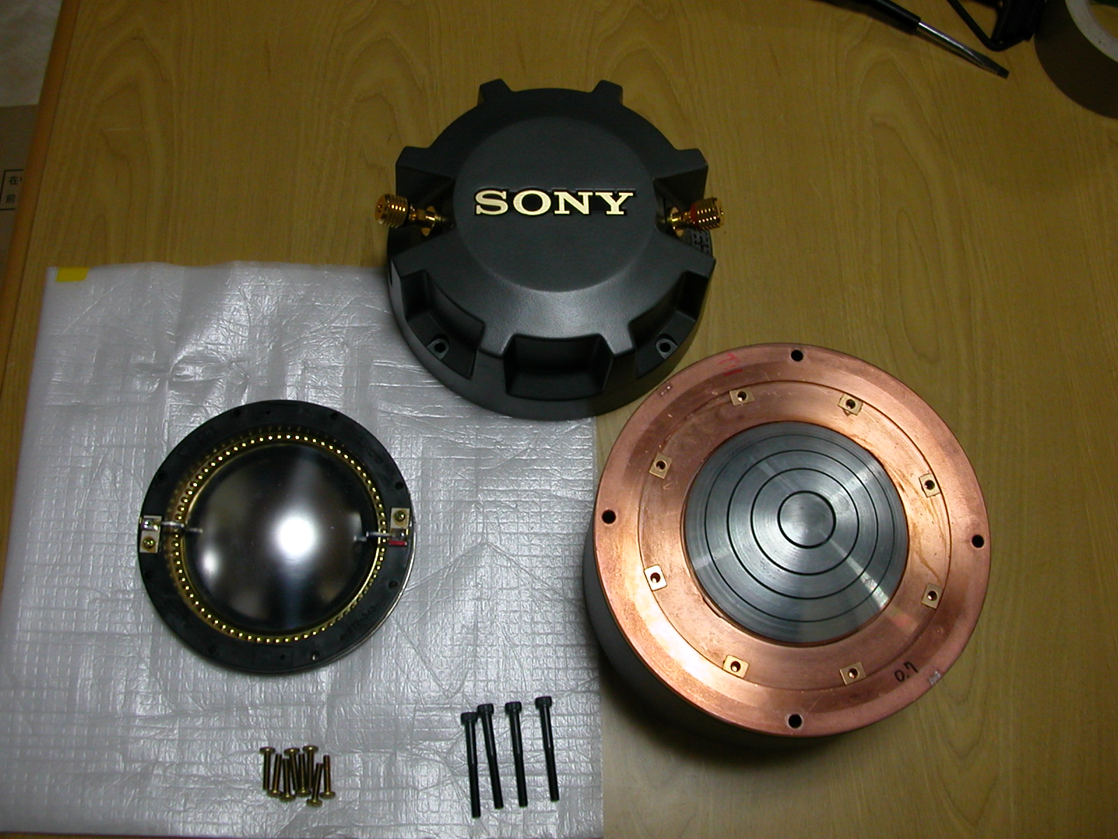

Woofer is indeed TAD 1601, Horn is JBL 2386a and the 2" compression driver is a Sony SUP T-11, at least in the original version.
