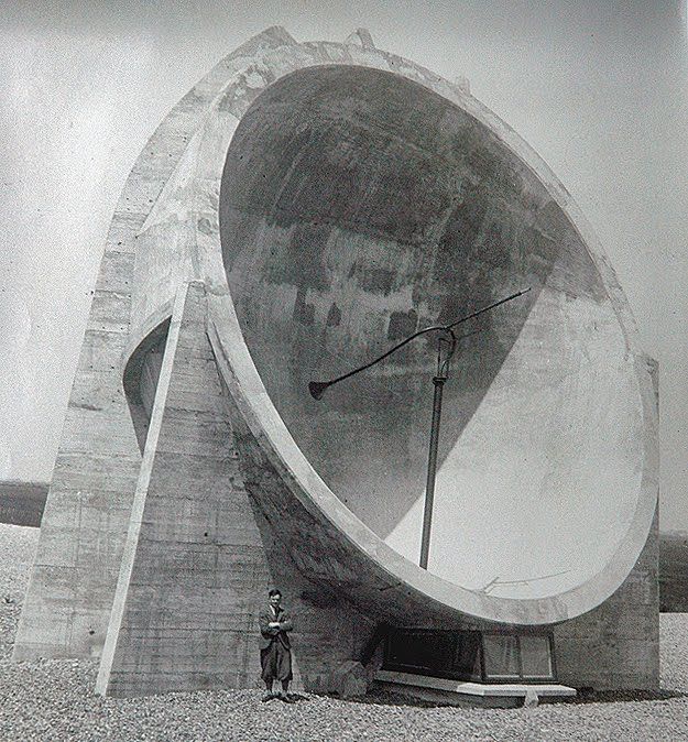

for sound it's different because of the different velocity. It's a slow propagation phenomenon, different from electromagnetic waves.
That doesn't stop parabolic reflectors from being used with sound though :).
