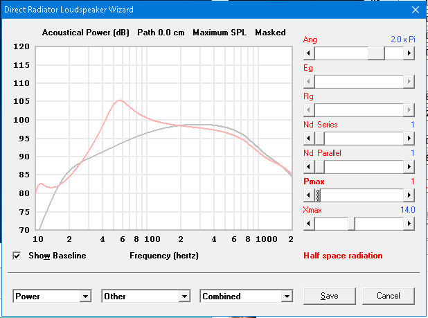

If you run a wavefront sim of that I bet the left side is closed...the waves bounce off of the wall and return to the driver. How can it show you a true combined response without the output of the front of the driver actually leaving the cabinet? Depending on how close to that wall i bet the response changes. I'm probably not understanding something but, thats what I see.
yours is my first sim of a TL. I entered your data, went into the loudspeaker wizard horn screen, slid the L12 to get the smoothest response (84cm), then went to the filling screen, set Fr to 4000, add filling starting in the driver end to smooth out the ripples. Too much damping and I had what looked like a sealed response, just the right amount and I had a vented response without nasty pipe resonances and just a little bit of ripple in the passband. I then lengthened the horn to extend the passband lower and re-optimized.

It is important to understand that the driver is represented by the red dotted circle, not by the red dotted straight line which simply indicates the position of the S2 cross-sectional area. Imagine when looking at the schematic diagram that the front side of the circular diaphragm (the red dotted circle) is facing you, and that it is directly radiating out of the screen towards you. The sound energy from the rear side of the diaphragm propagates back into the screen, to both the left (towards the closed end at S1 if the driver is offset, as is the case here) and also to the right (down the damped transmission line towards the open mouth at S3).
Rest assured, the Hornresp transmission line simulation calculations are done correctly, and the absorbent filling material model used is very accurate indeed :).
I had my suspicions, thank you for clarifying, I’ll have to play with it more now that I understand better what I see. I was clearly confused, so thank you all :)

If the frequency response is correct, that’s what matters, the thing that makes no sense is that sound is only emitted from one source when there should be two in the wavefront sim. If you draw a Tm using your mouse, in the wavefront sim, everything looks correct, but now you can’t sim freq response. So within the loudspeaker wizard the driver is facing directly at the screen...in the wavefront editor the driver can only face up down left or right. That’s what’s being suggested.
I ran the sims for bass reflex on horn resp and got different results, wonder which one to trust. With horn resp, the displacement increases drastically above about 40hz, where as with winisd displacement decreases above 40hz ion the same manner.....I'm thinking winisd is right.
So if I set pmax to 0, the curve looks right, then as soon as I add more power to the signal, 1 in this instance, the response changes to what you see in pink....make that make sense. The blue is reflective what I see in WinISD.
