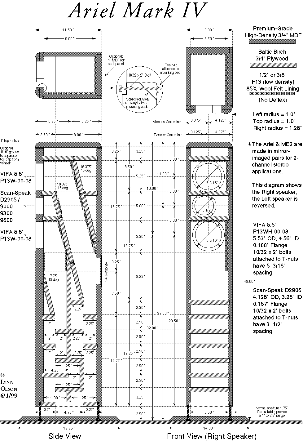

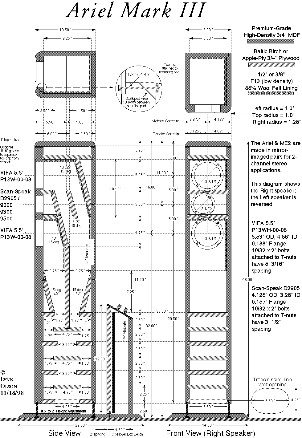

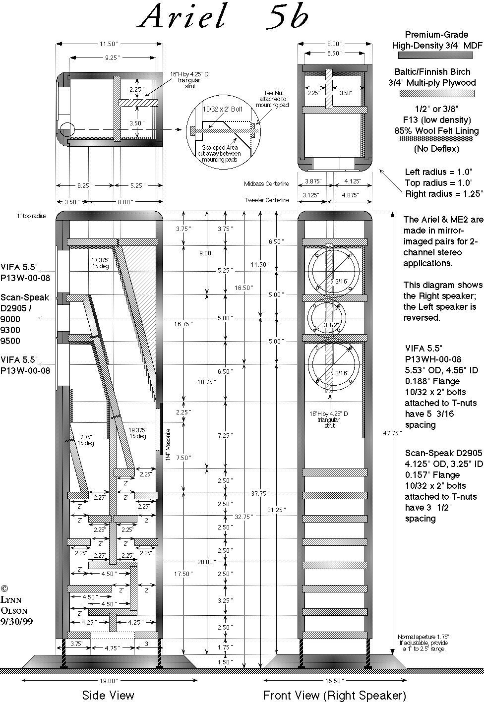

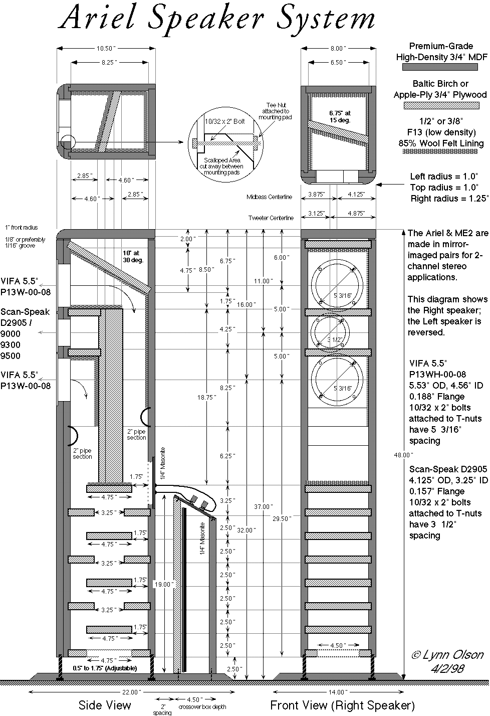

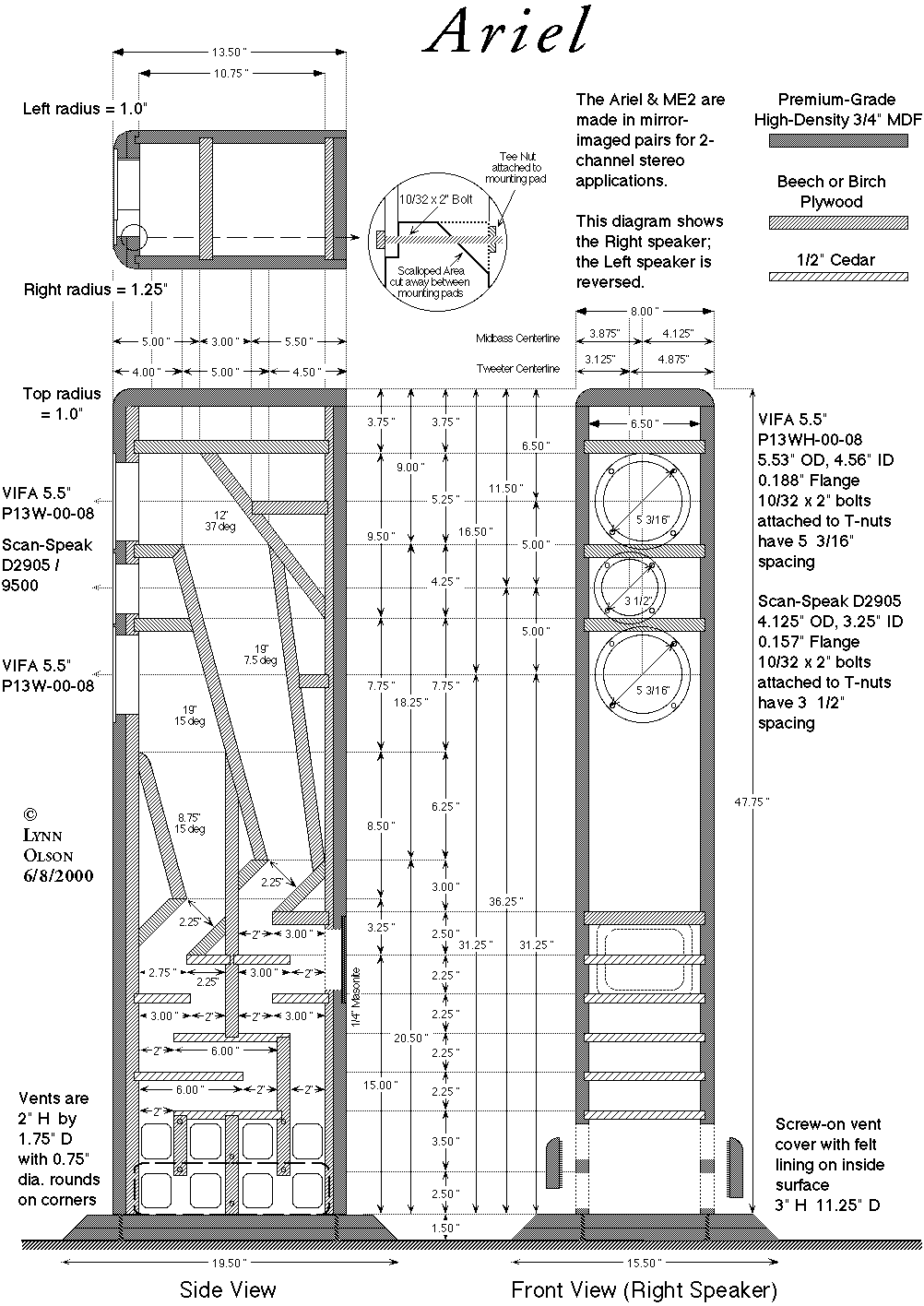

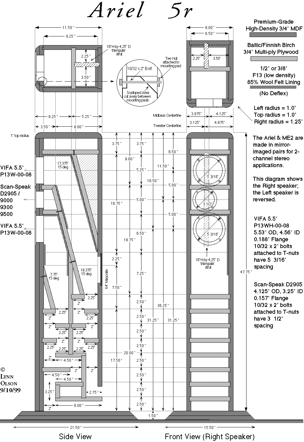

Lynn Olsen's Ariel project is an example of the complexity involved.
It starts with: "A Brief History of the Ariel. Or, The Neverending Story".
And the final part:
"The actual production version is the Mark 6. This version is acoustically streamlined and optimized for automated NC-controlled woodcutting machinery. Note that the drawing omits the usual filling and wool pads shown in the other versions; this was done as a convenience for converting the drawing to a 3D DXF file. If you want to build the Mark 6 for yourself, add in the filling and wool damping pads shown in the other versions of the speaker. Although very difficult for a home constructor, this version should have the highest performance due to the gradual and progressive changes of cross-section profile in the transmission line. The goal with successive versions is a smooth approximation of a reverse-horn profile that transitions to a labyrinth at the far end.
I admit no less than six versions of the Ariel might seem intimidating at first, and probably a little annoying to those of you who are in the middle of project. In practice, though, most of this is ancient history. There are no reasons to build an early versions ... the ABC'ers report better results with each successive version. For those of you in mid-project, should you abandon what you have and switch to the latest version? I can't answer that. It's the same as whether or not you should upgrade your computer now, or wait next year. The improvements are noticeable, especially in the midbass, but the essential character of the Ariel has been there since the Mark 2. The improvements have all been in the direction of greater transparency, reduction of coloration, and optimizing the 100 to 500Hz region, which has always been the greatest challenge for any transmission-line speaker. Once you hear the TL sound, though, it's not easy to go back to closed or vented-box designs."
Ariel Mk2-Mk6c:
