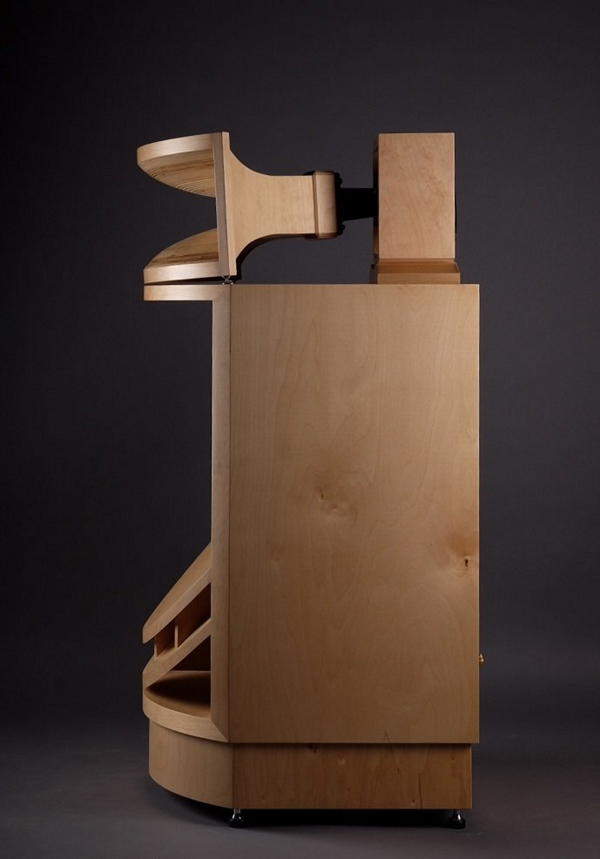

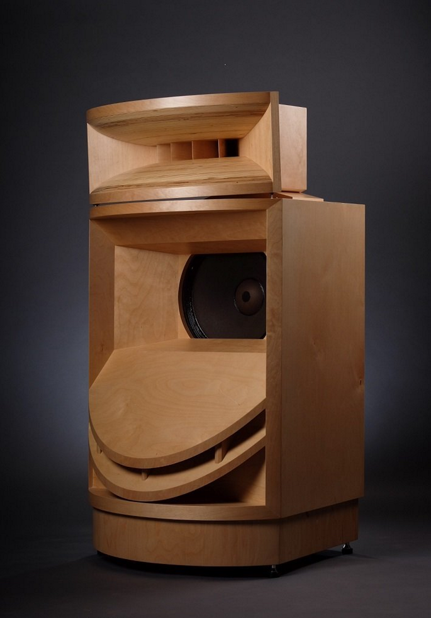

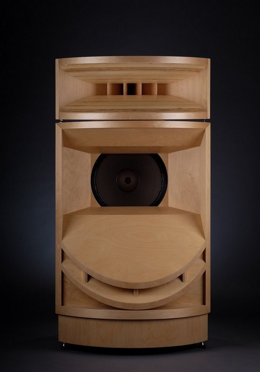

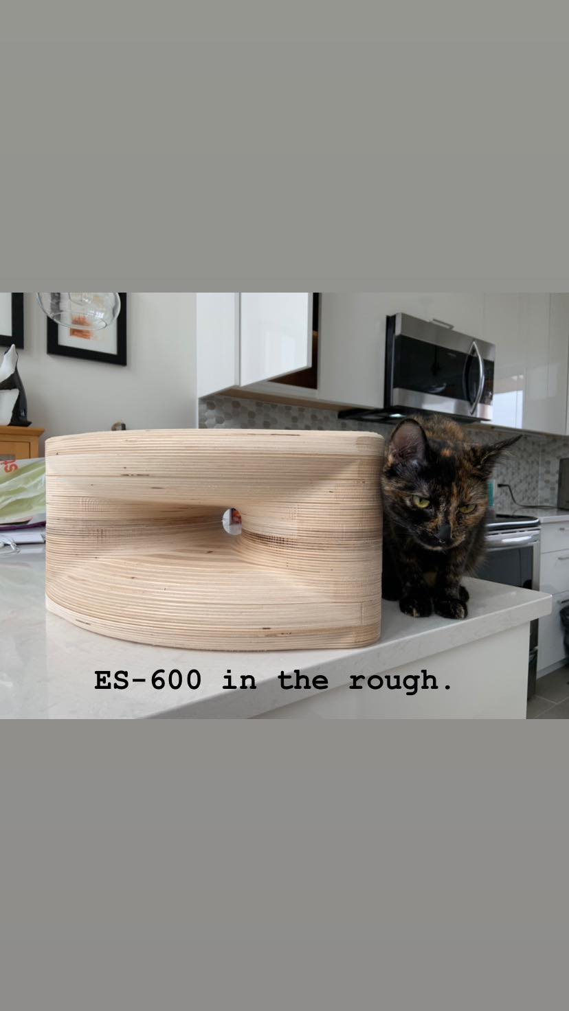

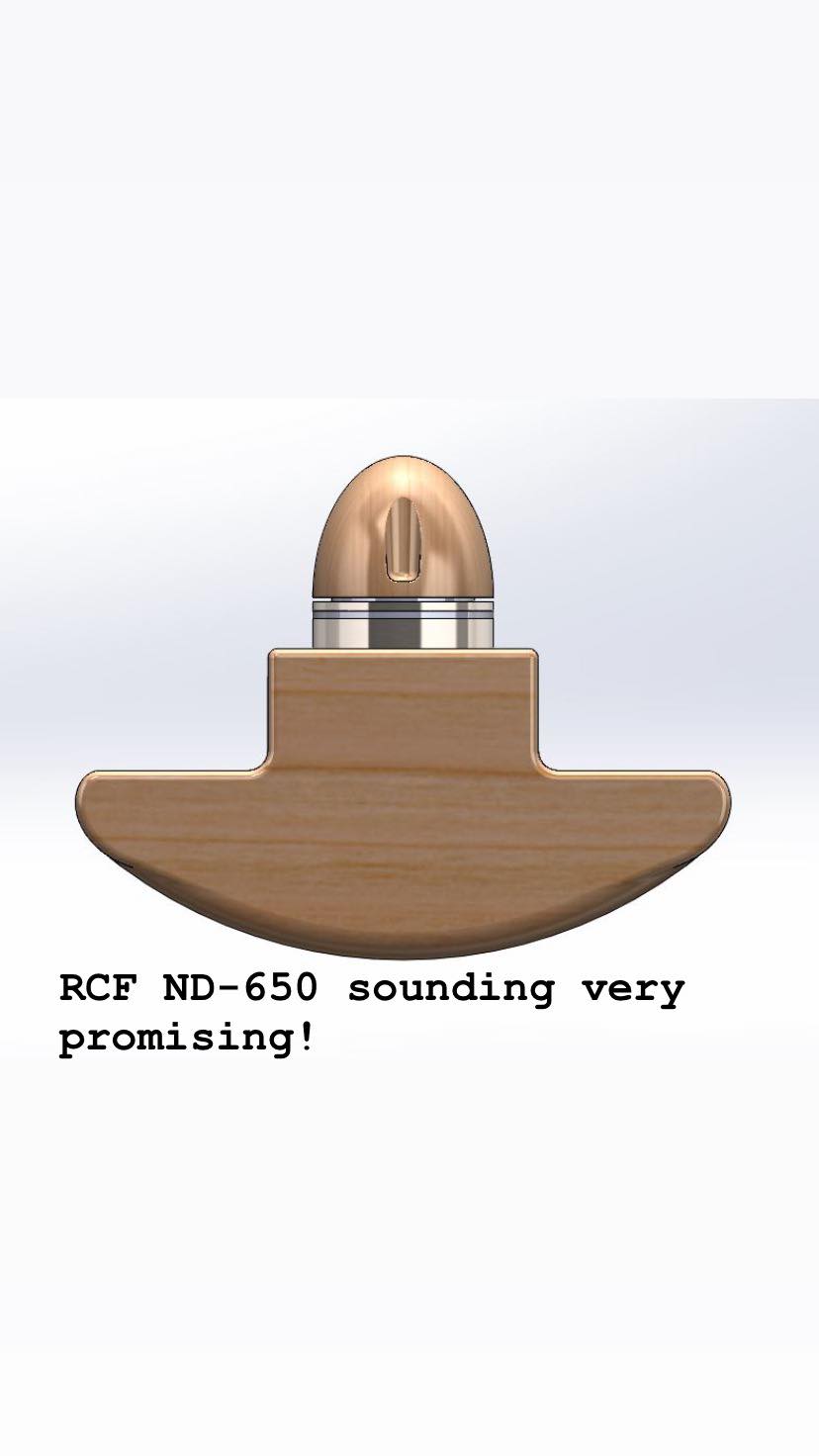

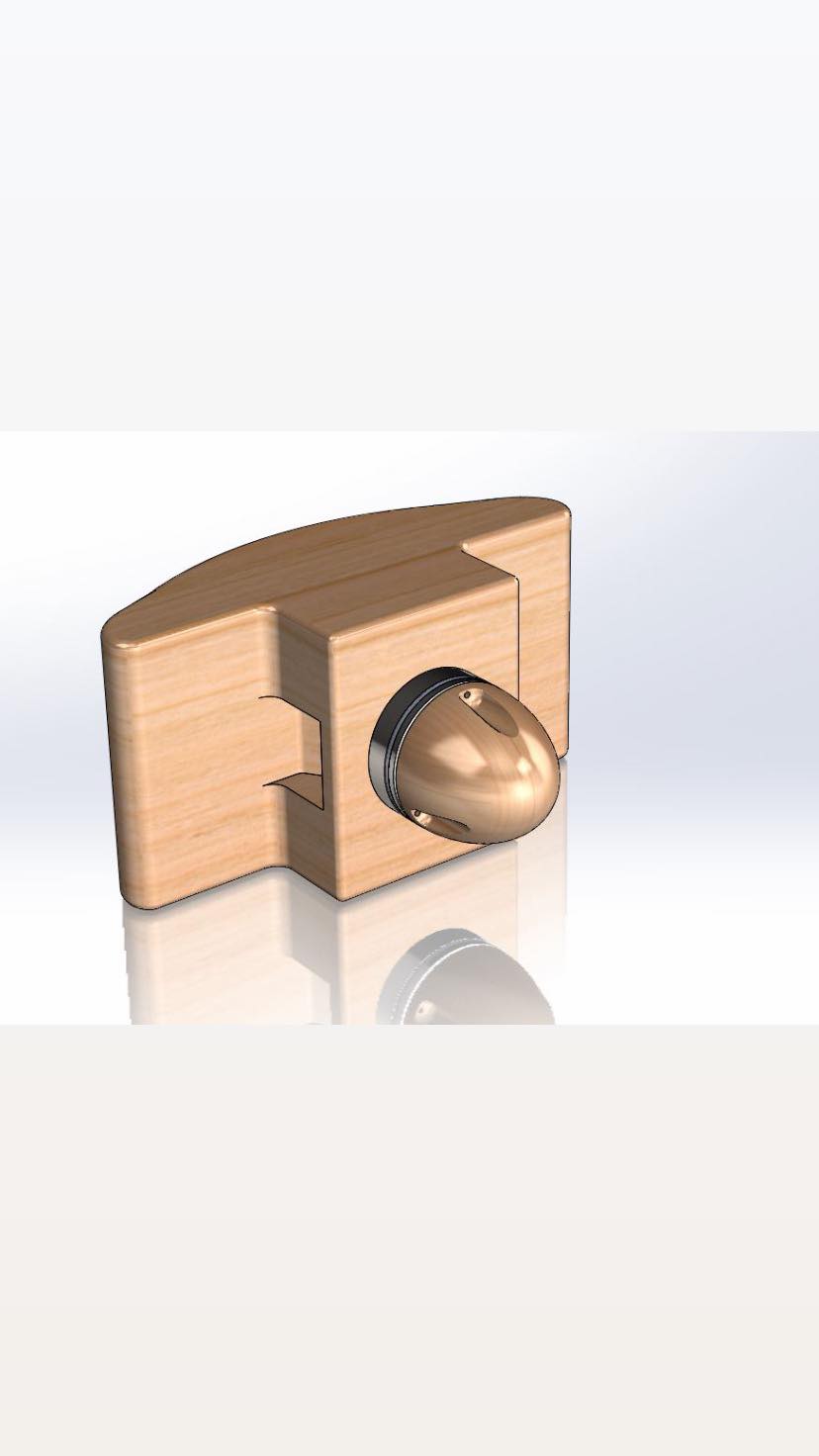

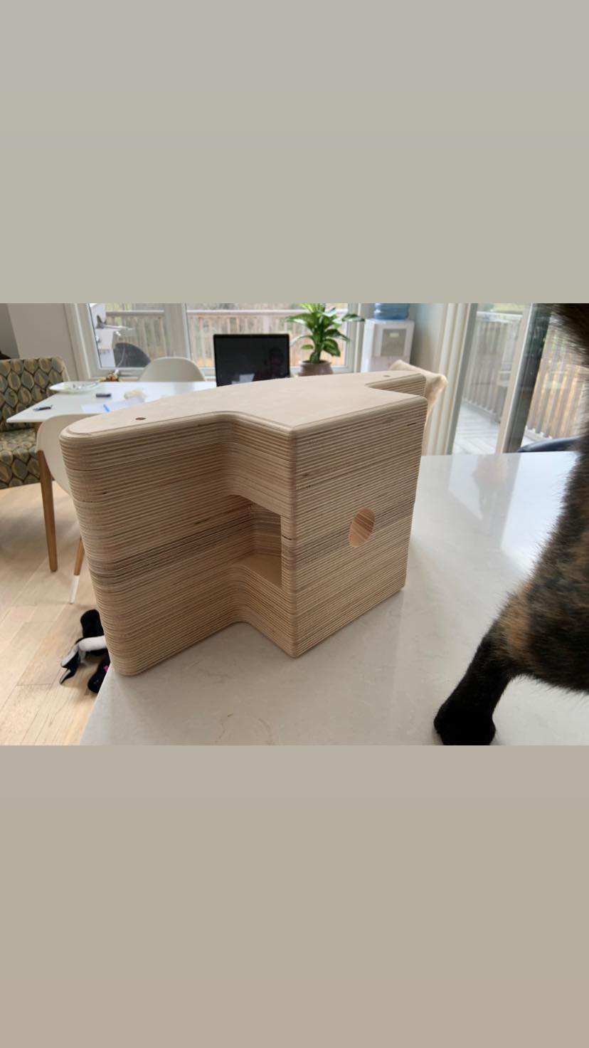

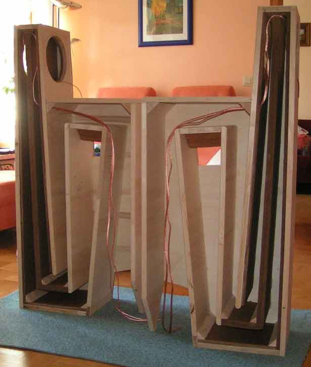

Hopefully he doesn't mind this scoop, but here are a few images of Joseph Crowe's ES-600 Bi-Radial horns.

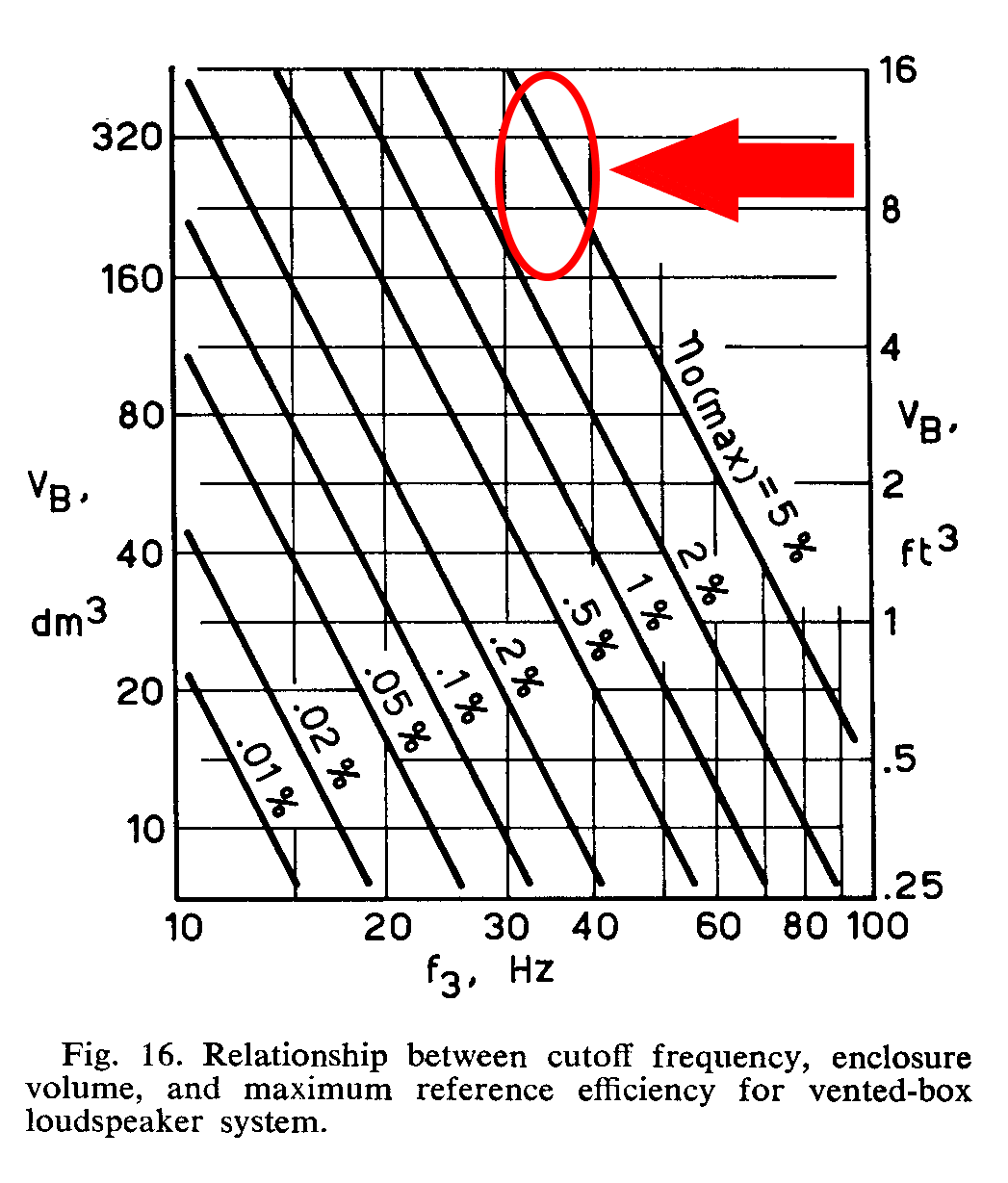

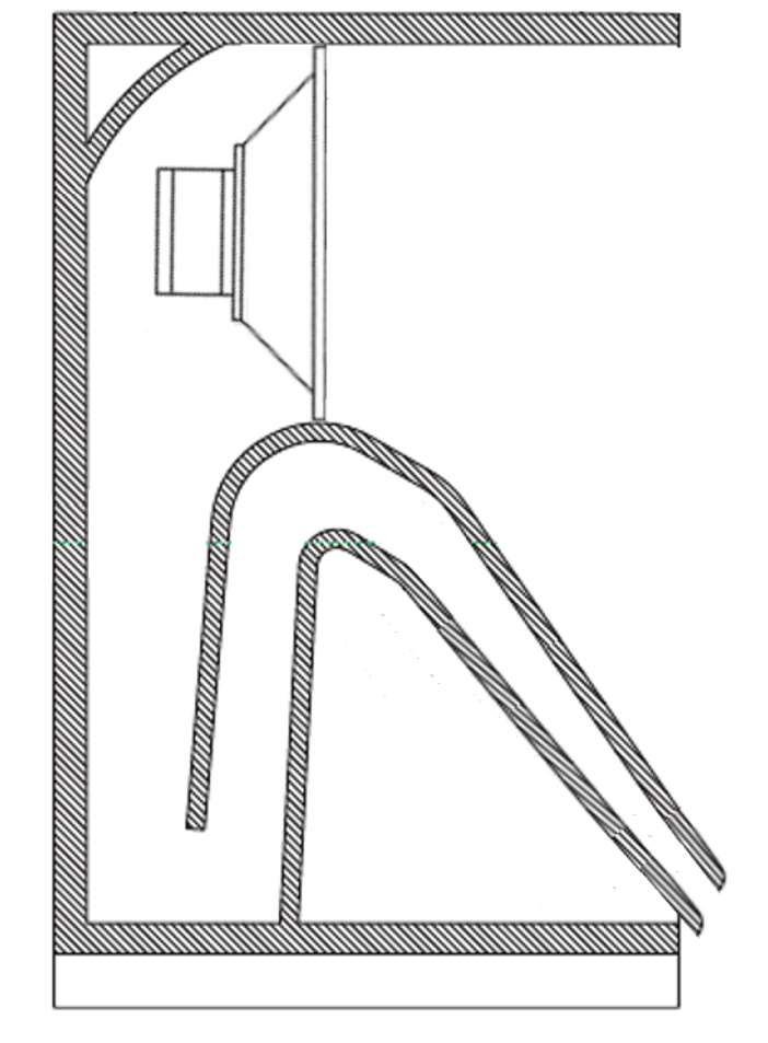

The ellipse indicates a nice balance between cutoff, efficiency and cabinet size IMHO (considering actual vented-box systems have an efficiency lower than the maximum given in the figure).

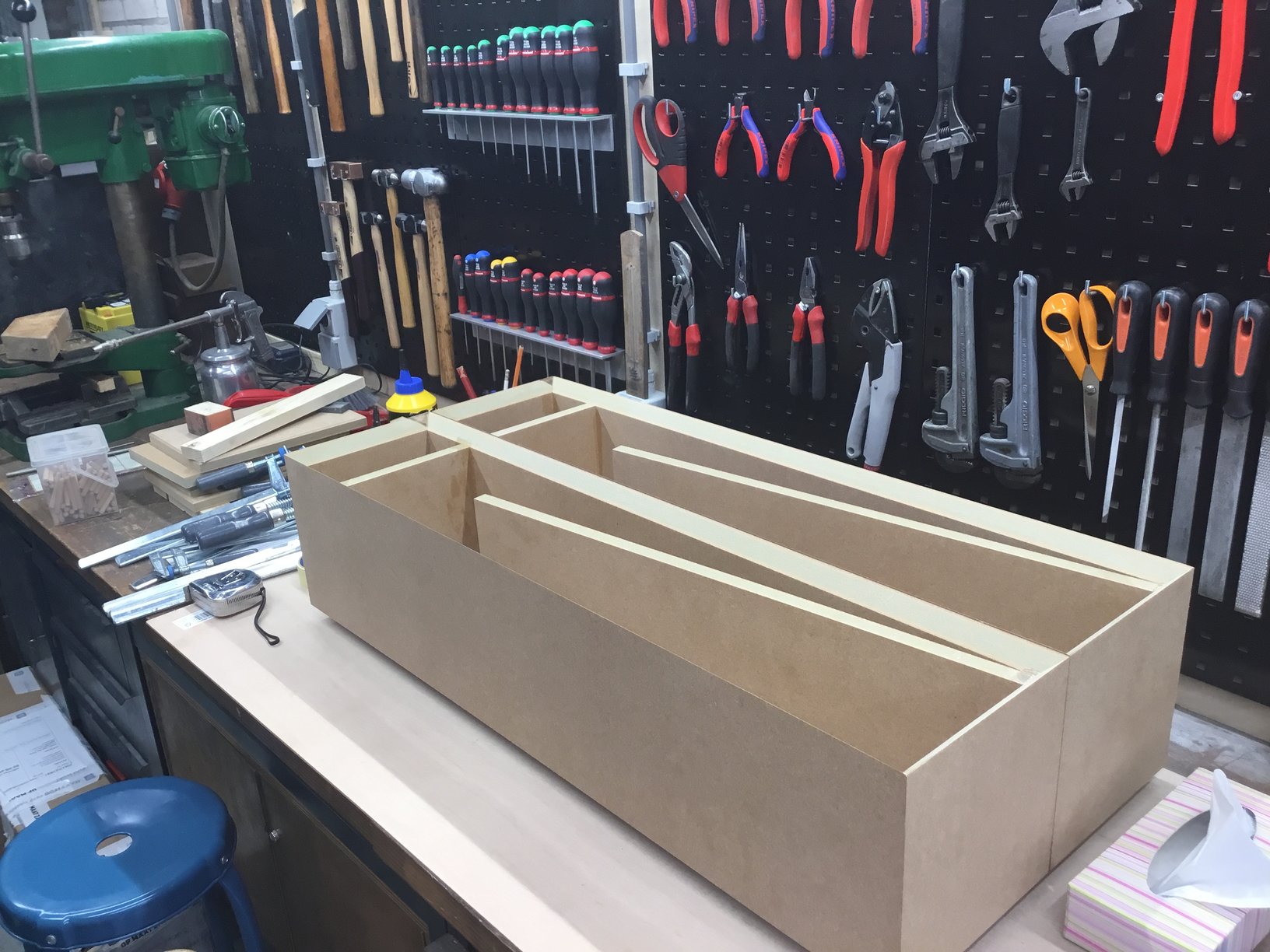

I want to believe in TM lines....and the group delay is low....but the sealed and ported version beat out my TM modeling for the 18h+ for extension on output so I'm not quite getting it.
Now that I look again, the sealed, has better group delay even. Is there something else to the sonic quality of TM?

TLs are great for squeezing the last iota of performance out of (usually) small drivers but who needs them for large robust drivers in the home?
Key to making the right decision is knowing how loud you actually listen and what the excursion has to kept below at this level to satisfy distortion goals.
Note that if a single sealed TD18H+ per side isn't enough, you could fit two in a fraction of the space that a TL would require.
The artist in you might want a masterly crafted TL but the engineer will likely advise you differently.

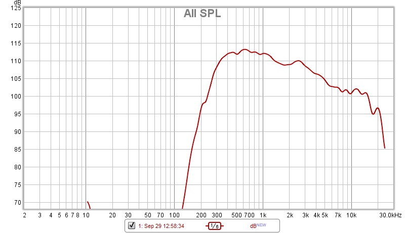

I came across keith1962s posts in another forum.
Before:
![83ddc348e11b86e262b1d9ceb2bb3359ba5089f7.jpeg](https://audioabattoir.s3.dualstack.eu-west-1.amazonaws.com/original/3X/8/3/83ddc348e11b86e262b1d9ceb2bb3359ba5089f7.jpeg)
After:
![088af0f0dec3faa028c24e00792ce2e643bcd052.jpeg](https://audioabattoir.s3.dualstack.eu-west-1.amazonaws.com/original/3X/0/8/088af0f0dec3faa028c24e00792ce2e643bcd052.jpeg)
His horns seem to originate from the same source as yours, camplo.
The response without eq, as posted before by Keith:
