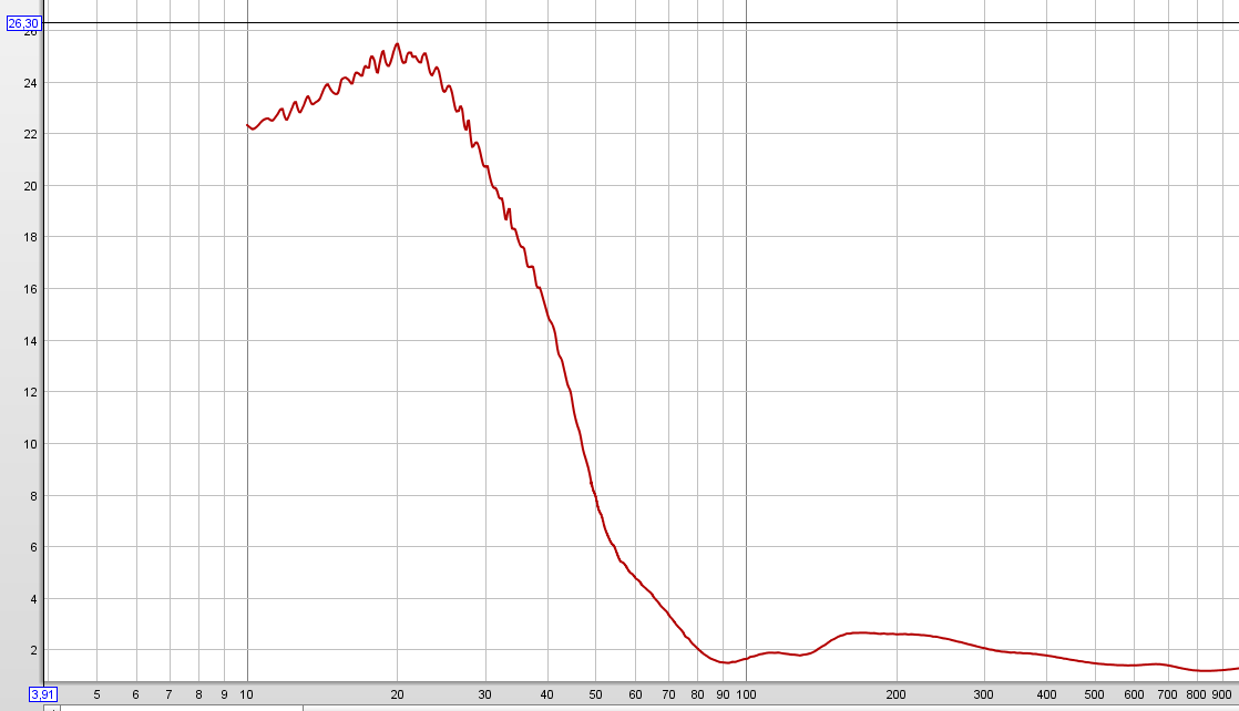

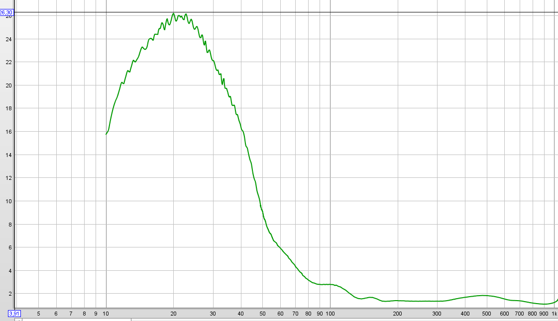

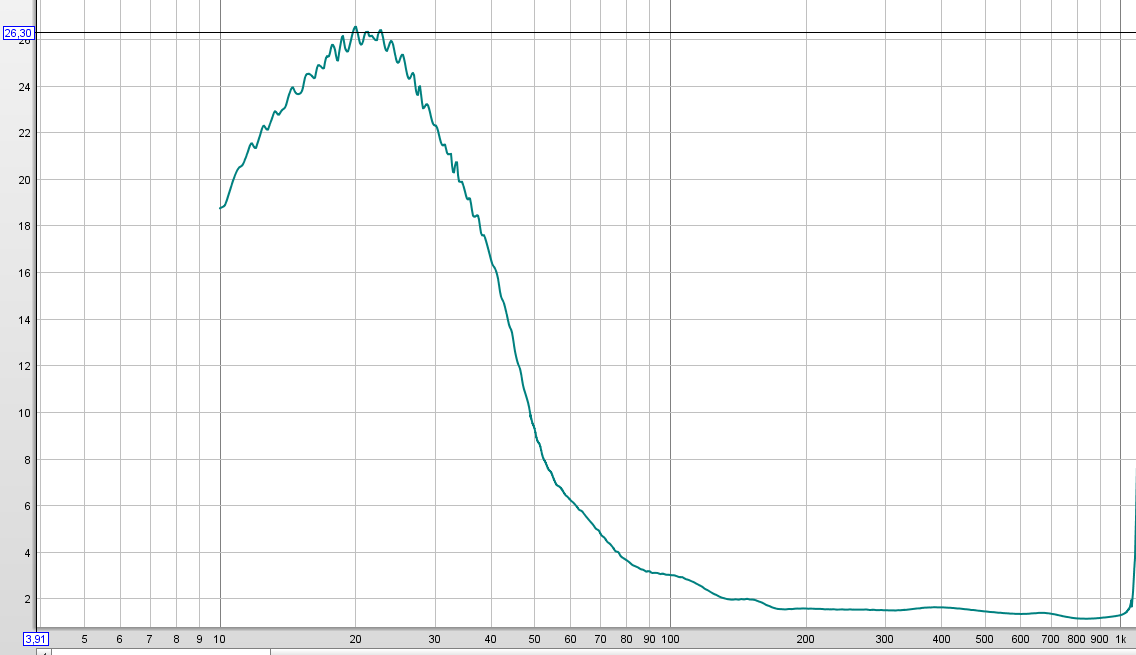

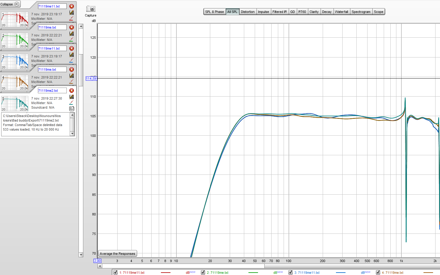

Here a example while i was trying to figure out how to remove the bumps in GD curve around 200-500hz. The only differences between all the curve are Eq/filters, and input power of the woofer filler driver working between 150-350 hz. The third picture shows promising effects.
And higher order sub (here a kind of 6th order bandpass 40-150hz set in hornresp as a 4th order bandpass + a lot of EQ to get same resultant FR/phase), needs + 5ms delay alignement of others ways as show when it group delay is showed separatly in last picture (don't look too much to artefacts).
Again...it's off-topic, sorry. Just to say, eq don't do all on phase. And FIR isn't anymore the futur ^^

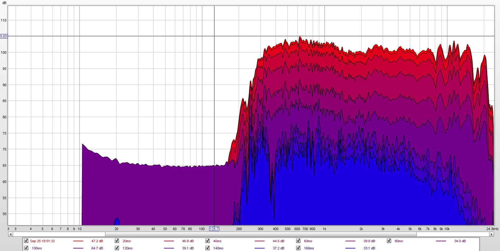

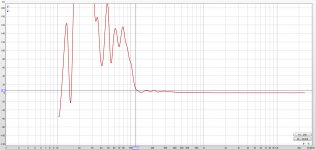

This is the Axi2050 group delay on a 250hz jmlc![]()
Interesting. I would have thought a jmlc would have had significant group delay in the 250hz range with the posted frequency response.
Considering it’s group delay is tight down to almost 100 hertz, I personally think it’s more credit due to the driver than the horn.
Yes, it looks like Mark Dodd and Jack Oclee-Brown have succeeded in creating (by far) the best Titanium diaphragm ever, including the driver around it, of course.
Respectfully. Your group delay magnitude scale is misleading. The extreme issue below 100Hz is irrelevant to the lower passband. Jean-Michel had a preference to cross by 300uS in the varying region, I'm sorry I cannot find a post that says this. This becomes less critical below 250Hz.#Random
